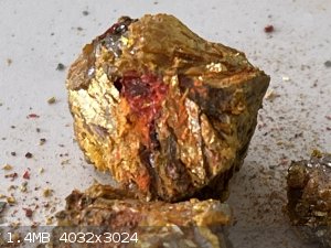

Hello. I had good ore of arsenic from the mountainous region of Caucasia and today I removed sulfide minerals from that rocks. to tell you truth I removed small rocks from the sulfide mineral. every rock was almost sulfides. a major component was orpiment with a small amount of realgar. it isn't soluble in hydrochloric acid but I dissolved it in conc. nitric acid very easily produces arsenic acid. the solution was clear, without any color.
photos of my mineral:
some rocks contain only orpiment, but when I mix orpiment-realgar finally powder was orange

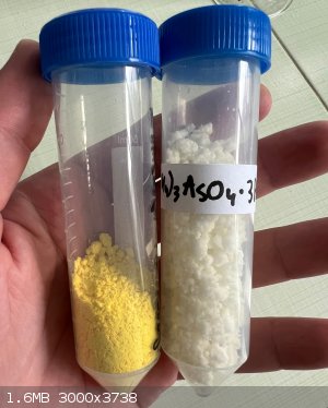

I used 20 g of orpiment mineral. First i made arsenic acid, then ammonium arsenate trihydrate and 12-molybdoarsenic acid. Now I'm trying to make amorphous arsenic(filter paper).

Can you give some experimental details about how you made the ammonium arsenate and isolated this? Also interesting to see how you made the arsenic powder. What yield did you have? Is the elemental arsenic reasonably pure?
vano - 8-10-2022 at 12:40
first, it was almost sulfide. solution of arsenic acid was clear and transparent. then I neutralized it with ammonium hydroxide and recrystallized it twice the time. it is white and looks pure, but I want to make it much purer. also, I used exec nitric acid, so there is no As3+.
this time I just test how the process going. Tomorrow ill crystalize it a few times or try a different method. also, I use it in some test tube reactions it is acceptable for me as a oremade reagent.
about arsenic. it formed a black-brownish amorphous powder very easily. but I am just interested if the reduction was easy for 5+, and it was, I just use a crude solution of arsenic acid I can't give you details. the As powder was in small amounts so I didn't save it. it works but I prefer to make useful compounds.
also, I tried reduction with zinc powder and also aluminum foil. both works.

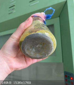

undissolved silicate mineral particles.

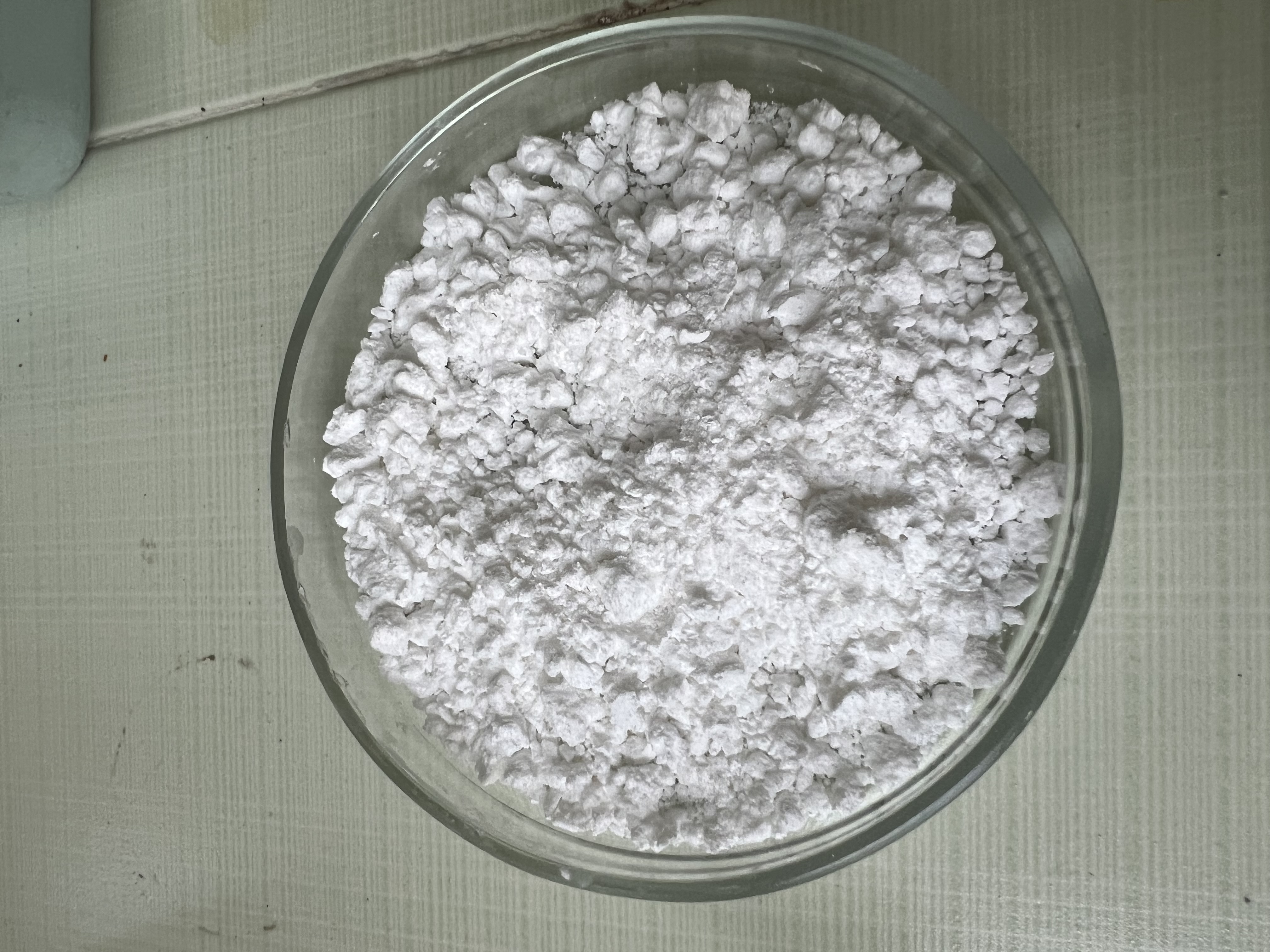

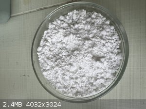

I started to make much purer arsenate. here is MgNH4AsO4 which is insoluble arsenate. I precipitated this to separate it from the sulfate.
ill make this reaction, separating magnesium hydroxide from the solution, then I will heat the solution to remove ammonia.
MgNH4AsO4 + 3NaOH = Na3AsO4 + Mg(OH)2 + NH3 + H2O
ill wright details when ill make sodium arsenate finally.
