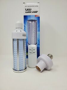

MadHatter - 11-2-2022 at 17:01
I bought a 60-watt UVC LED "corn-cob" styled bulb in the early days of COVID.
This to kill any COVID on surfaces. Whether or not this was effective is unknown
to me because less than a minute after turning the bulb on something smelled like
it was burning. Fortunately I wasn't in the room and the bulb came with a fixture
with a remote control to allow me to operate without exposure. The reflection
from the room was intensely violet-white light. Nothing like I'd ever seen with a
black lamp. I haven't used this thing since.
That LED corn cob looks like it has about 360 LEDs, if they are UVC LEDs I would expect it cost more than £100. UVC LEDs are expensive compared to longer wavelength LEDs.
