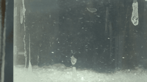

EDIT: A photo of the dried first batch.
[Edited on 2021-2-26 by metalresearcher]
RX609824.JPG - 1.9MB
