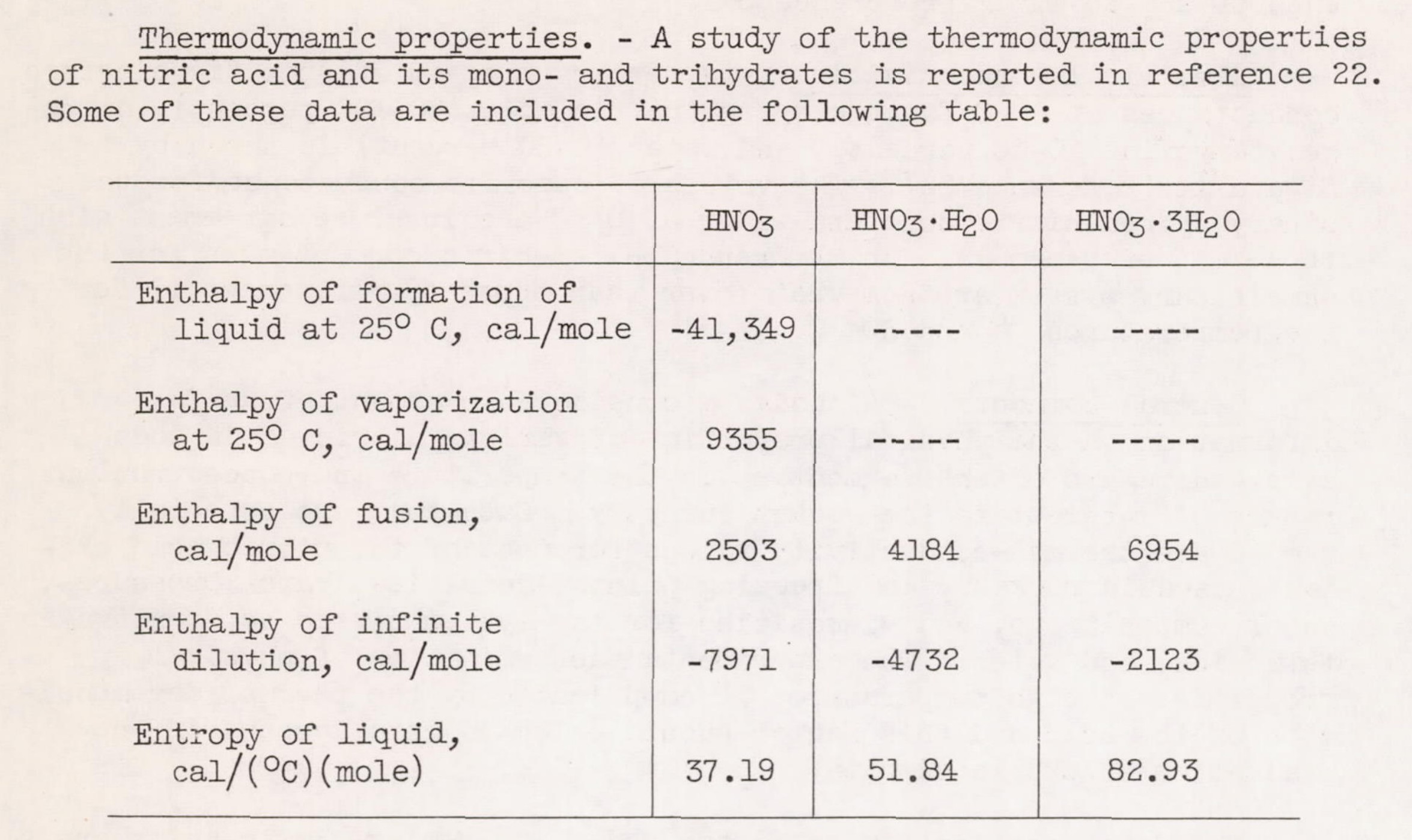

Hydrazine - 1-9-2020 at 12:20
Hi Maurice,
There are many available online references to 100% Nitric Acid Enthalpy of infinite dilution.
There is the link above and another reference attached. The attached table shows enthalpy of infinite dilution for 100% nitric acid. It also includes 1 mole nitric acid with one and three moles of H2O already added in. This is very helpful to make an interpolation.
Enthalpy of Dilution
I was trying to find a direct reference or measurement of 68% azeotropic Nitric Acid heat of formation as a solution but in the absence of a reference it can be estimated from the attached image.
The data for these three points was entered into Excel, graphed and curve fit.
The interpolated enthalpy of infinite dilution for 68% nitric acid is -4230 cal/mole.
This enthalpy loss was added to the heat of formation of pure nitric acid to get the heat of formation of nitric acid after it has been diluted to 68%.
This brings the acids ΔH to -45579 cal/mole. *This is only for the acids enthalpy, not the water.
The water ΔfH needs to be added in. After converting moles to grams and factoring in the w/w 68% Nitric to 32% H20 percentages the ΔfH can be calculated as a whole.
68% Nitric Acid ΔfH = -1704 cal/g
Its an interpolation between points but it should be close enough for the application.
If any of you guys calculate different numbers or find a reference please let me know.

Nitric Acid Enthalpy of Dilution.jpg - 336kB
