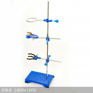

Does anyone know of how to use a retort stand? -- I mean is it different from a ring stand?
I'm worried that the cool ring will crack the warm/hot glass.
I am thinking of going with a retort
Still looking for the best link to a lab stand, or in this case a retort stand. -- I'm not sure what the best ones are. united nuclear ones seemed decent.
also, what about the united nuclear flex clamp? I could clamp it to the edge of my desk and avoid the ringstand all together if it'd support a few pounds.
thinking of going with the 125mL retort.
Comments?

If you heat a retort on a ring/retort stand the ring will get heated together with the retort.

Is there any other way to support my retort?
without using fiberglass strips?

Sulaiman - 23-6-2020 at 18:45
You could use a sand bath for heating and supporting the retort.

Yttrium2 - 4-7-2020 at 13:52
Is this the next best thing since sliced bread in the stand / clamp world?
https://www.ebay.com/itm/Retort-Stand-Support-Ring-Stand-24-...
it seems pretty inexpensive, the pole comes in two pieces, is this a bad deal? I am about ready to hop on it.
B(a)P - 4-7-2020 at 14:40
The whole thing weighs less than 3 pounds. There is no way the base is heavy enough.
Yttrium2 - 4-7-2020 at 15:23
really? its got a foot print, how much should it weigh?
It is a huge price difference.
[Edited on 7/4/2020 by Yttrium2]
B(a)P - 4-7-2020 at 15:59

Yttrium2 - 4-7-2020 at 16:26
Enough that your entire reaction set up does not come crashing down breaking glassware and spreading hot corrosive reaction mixture everywhere.
I think I'll take my chances with the weight of these stands as being satisfactory, If I could get a professional to chime in on the matter, I'd appreciate it. I think it will support the weight, if it gets knocked into, that is another story, and I think in that scenario it has more to do with the footprint (center of gravity of the apparatus on the stand, vs the weight of the base)
so could someone else, or someone professional chime in? Hence when did lab stand base plate weight become an issue? (Lately its been said a lot, but I want to make sure it is not a regurgitation from someone unqualified)
[Edited on 7/5/2020 by Yttrium2]

karlos³ - 4-7-2020 at 17:51
You're likely better off, cheaper too, and get a qualitatively superior stand, if you simply build it yourself from scratch.
I build my own with a metal base weighing around 8kg(more or less) and a rod of 70 or 80cm screwed on the plate, and while they work well for most applications, it still is barely sufficient for some unusually heavier things.
For example, when doing solvent extraction of a larger volumes, like some biosynthesis corresponding to a 1l separation funnel filled almost to the brim(easily ~1,5l), then it becomes obvious how the heavy funnel is close to the upper limit of what these stands can manage.
A weight like this in the necessary height is a negative impact that destabilises the stands notably.
So think that well thorough, if the little one you consider to buy will be sufficient for everything you're planning to do with it?
[Edited on 5-7-2020 by karlos³]
Yttrium2 - 4-7-2020 at 17:59
this one is $25 USD, its not the little one
s-l1600.jpg - 93kB
building one requires tools and supplies, as much as i'd love one made from granite. The collapsible nature of it is a + too.
B(a)P - 4-7-2020 at 18:46
Ouch!
Weight has become an issue because companies are cutting corners in an effort to produce ever cheaper products.
Yttrium2 - 4-7-2020 at 18:48

B(a)P - 5-7-2020 at 00:37
no offense meant
I'm not a professional either
It will take my chemistry ego a long time to get over this.
I just went and measured up my report stand. It was purchased from a laboratory supply company. It cost only about 3 time what you are looking at. It weighs 3 kg and the base is 180 mm wide by 300 mm deep. Although I am not a professional, this is what the professionals are using

Yttrium2 - 8-8-2020 at 10:26
Haven't made the purchase yet, but I'll be going with the cheaper stand for sure $25 USD isnt' bad for the stand and the clamp.
probably get a flexi clamp from united nuclear also

morganbw - 8-8-2020 at 15:23
Hey guy, I have found that I need to place some weights on my base plates to maintain integrity. We do what we must. You may be able to figure this out.
