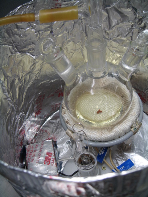

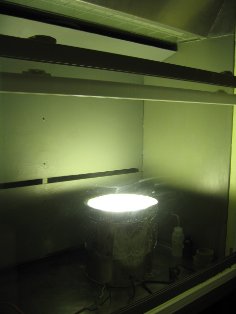

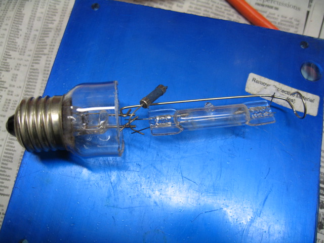

Magpie - 6-11-2013 at 17:01
Len1, in his book "Small-Scale Synthesis of Laboratory Reagents," shows how he converted chloroform to carbon tetrachloride in near quantitative yield using free radical chlorination. This post will document my efforts to do the same using a scaled down version of Len's method.
Len used a charge of 239g of chloroform and a 1kW mercury vapor lamp. In each of my two experiments I used a charge of 149g (100mL) and a 0.1kW mercury vapor lamp.
My chloroform was reagent grade. The mercury vapor lamp was from a yard security light. This lamp, I assume, uses a "high pressure" (~1 atm) mercury vapor arc in a quartz tube. In the first experiment I used the lamp as is, ie, I did not remove the outer borosilicate glass protective envelope. Upon some research I learned that the UV light needed to generate the free radicals does not pass this outer envelope. According to a borosilicate glass technical reference the chlorine molecule absorbs in the 280-400 nm range. So, using a Dremel tool with a diamond cut-off wheel I removed this outer envelope exposing the bare arc tube. This arc tube is what I used for the second experiment. One must remember that exposure to UV in this range can result in sunburn and retina damage.The picture below shows the lamp after removal of the outer protective envelope:
Hg arc tube.JPG - 110kB
I built a small elliptical enclosure from a 2 foot section of galvanized 6 inch steel duct. This was covered on the inside with aluminum foil. The mogul lamp base and 1000mL chlorination RBF were placed at the foci, 4 inches center-to-center separation. Both experiments were conducted using this enclosure. This enclosure is shown below:
irradiatioin chamber with Hg arc tube.JPG - 122kB

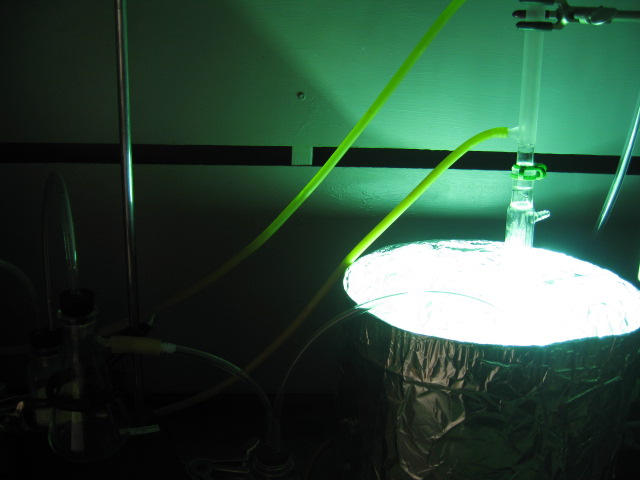

The picture below shows the lamp in operation during the 1st experiment. The 2nd experiment would look the same except I covered the enclosure with a sheet of aluminum foil.
UV assisted chlorination of CHCl3.JPG - 69kB

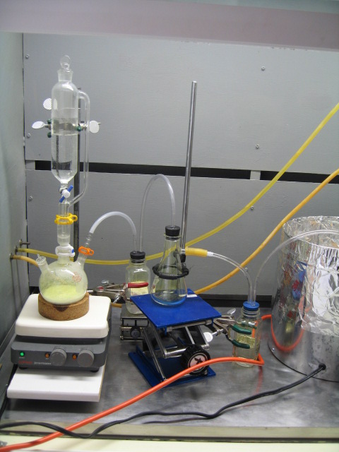

The chlorine was generated with TCCA and 20% HCl as described in Prepublication. For each experiment I used 2 ea batches of 55g of TCCA and 196mL of 20% HCl. In each case I used the following Cl2 drying train between the Cl2 generator and the reactor: CaCl2 drying, safety bottle, con H2SO4 drying. A sparge tube with porous frit end was used to inject the Cl2 into the chloroform. A reflux condenser was used at the reactor which was heated with an electic mantle. Gases passing the reflux condenser (Cl2, HCl) were led to an inverted funnel over 10% NaOH for absorbtion of the HCl. The chlorine generator is shown here:
chlorine generator.JPG - 90kB

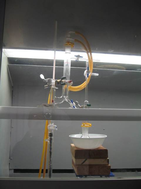

Following each of the two runs the product was fractionated using a column consisting of a 200mm West condenser stacked above a 200mm Hempel column. The Hempel column was packed with glass shards, the West condenser with a ss scrub pad. A Hennion still head was used to control the reflux ratio. The 2 pictures below show this apparatus:
2-200mm columns stacked.JPG - 84kB
Hennion still head.JPG - 65kB

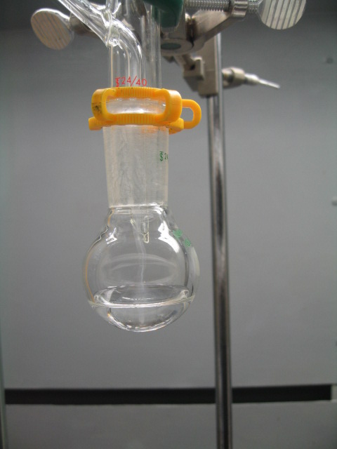

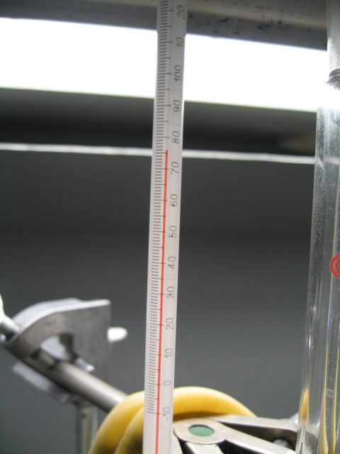

Results & Conclusions The yield from the 1st experiment was zero. The charge came over as pure chloroform, bp 61.2 °C.
The yield from the 2nd experiment was a disappointing 9.4 mL, coming over at 76.7 °C. An intermediate cut of 37mL of distillate in the bp range of 61.2-76.7°C was obtained, however. This conceivably could contain another 18mL of CCl4.
CCl4 coming over.JPG - 60kB
CCl4 distillate.JPG - 57kB
Beefing up the UV wattage to 0.4kW and procurement of a 600mm Hempel column are in progress. More experiments will be conducted and I will post the results.

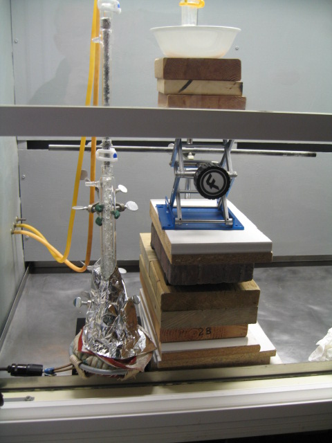

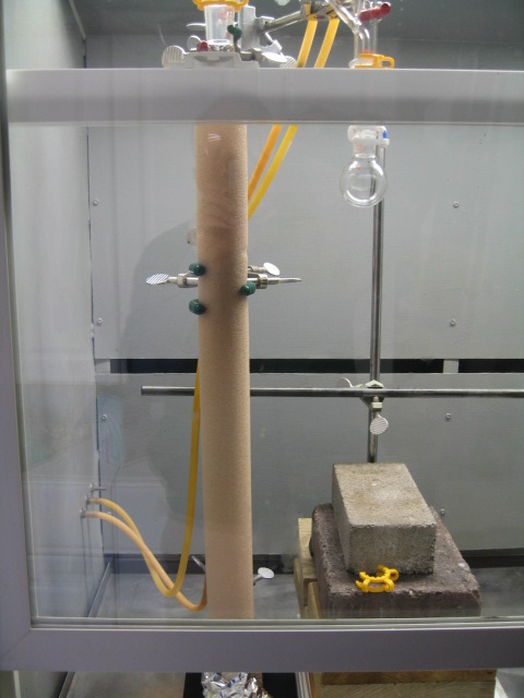

Here's a couple pictures on my progress toward making CCl4 more effectively.
The 600mm Hempel column arrived and was successfully tested with a 50/50 v/v% heptane/toluene mixture having a boiling point spread of 19-20°C. Packing was ss scrub pad. Hardware store nominal 1/2"ID foam pipe insulation was used to help maintain an adiabatic column temperature: Column ID is 12.7mm.
600mm Hempel column - insulated.JPG - 72kB
[Hempel column]
The 0.4kW mercury vapor lamp was wired to its ballast and tested today as shown. I haven't removed the borosilicate protective envelope yet.
Mercury vapor lamp ballasts have been banned from production in the US since 2008. Fortunately they are still available on eBay, for now. Lamps can still be bought through regular stores and on-line, for now.
0.4kW mercury vapor lamp.JPG - 61kB
[0.4kW MV lamp]

Yesterday I fractionated the product from my latest run at making CCl4 from CHCl3. This run (#3) utilized the 0.4kW Hg vapor lamp as improvement over the previous run (#2) using a 0.1kW Hg vapor lamp. Again I used a 100mL charge of CHCl3. In reviewing my calculations, however, I found that for run #2 I inadvertantly used too little Cl2. I used 110g of TCCA for #2; for #3 I used a corrected amount, 200g. This gives Len1's recommended 2X stoichiometric Cl2.
The yield was 49mL, or 40.9% based on the CHCl3 charged. This is considerably better than the yield of run#2, ie, 9.4 mL.
Even with my new 600mm Hempel column the fractionation is a difficult one. Initially the CHCl3 comes off at its bp of 61.2°C for about 25-30mL. Then the temperature slowly rises to the bp of CCl4, 76.7°C. The transition volume is about 15mL. I took this transition very slowly, ~2 hours, keeping a low boilup rate and a high reflux ratio, ~10:1.
I started taking product (CCl4) when the still head temperature reached 76°C.

For $20, I got a set of 2 HID headlights and removed the outer capsule like Magpie did.
I was inspired by Explosions&Fire's difficulty finding an OTC 320-350nm UV source for his cubane project. I figured I'd just do a proof of concept which was within my admittedly limited grasp (2 years ago, all a mole was to me was a critter destroying my back lawn).
My overall yield out of 3 runs was probably 40%. The first was, I think, around 70% with one bulb, and the majority of losses were due to overheating and substantial evaporation. I couldn't really use a hotplate, so I used an alcohol lamp, and I think with the bulbs so close, the heat of the lamps was more than needed. There was fairly heavy boiling in the flask by the bulbs.
