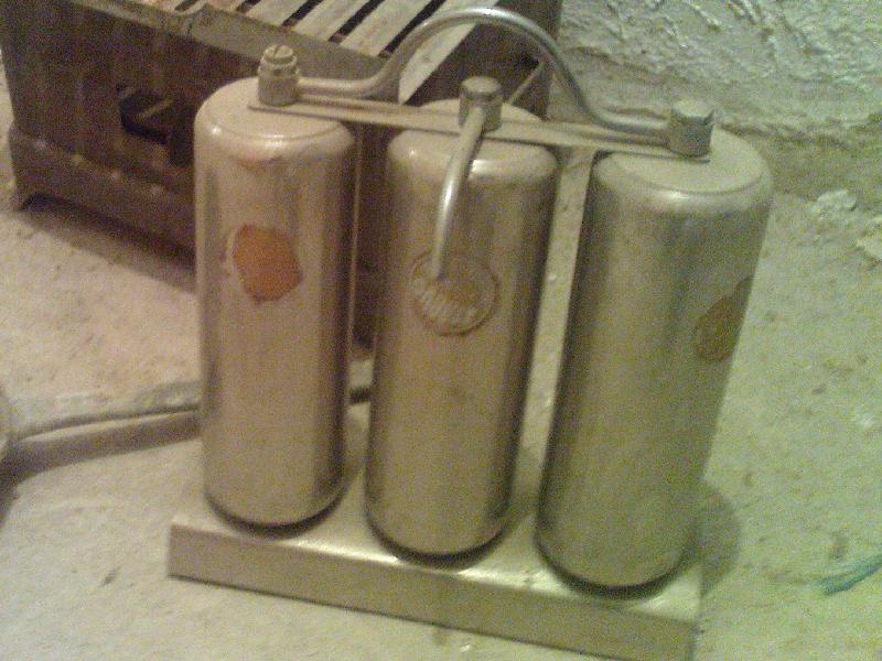

Sedit - 18-2-2011 at 12:54
Meglar I got wounderful news, those new elements I spoke of are called Calrod and here is a picture of them,
The great thing about these is that they are already ceramic coated and non conductive on the outside. It is the same type of elements that used in electric stoves.
I just made a quick run with the ones I ripped out of an old toaster oven and within 10-15 minutes the Pyrometer was at 2000F and the Copper tube started to melt away so I stopped.
Amazing down right amazing.
Anyone that wants to make Phosphorus needs to use these, they will save you time and hassle no doubt.

Sedit - 23-2-2011 at 23:14
Ok so,
I didn't have much time to play this weekend since all that partying got in the way but I did learn a few things that will move this process along to success in short order as long as I dedicate the time to it.
I tryed to use the setup I was going to which involved a piece of 2" Iron pipe with another slightly smaller one fashioned into a retort to place inside of this setup. Theory was that it would act just like a simple kiln and fire that bad boy up to temperature in no time however reality proved otherwise. Yes, the temperature was rising pretty well inside of the pipe but it was going very slow even with added insulation. I concluded after observing it a few cycles that it could indeed reach the desired temperature and produce Phosphours however I have seen that these temperatures can be reached much quickers and with a more stable pace using a thin walled material like what I did in my initial test using Copper tubing.
The solution was a simple one and it links back to one of the very few people in this extremely long over discussed thread where the fellow used an old can of some sorts and a fire pit to produce the Phosphorus temperatures thru a simular reaction which I am about to undertake.
I made some rapid alterations and wrapped an old empty CRC electronic cleaning can in insulation and nichrome wire to see what it was able to accomplish. I cut the top off so I could examine the internal reaction and from what I seen if one was able to fashion a simple replaceable, reusable retort out of a container such as this using my sort of setup then the production of Phosphorus would be as simple if not extremely more so then the process put forth by the person using a firepit and a retort who IIRC waited sometime, possible in the order of hours, for everything to reach temperature. I observed my setup, which in the end will be almost the same as that persons, reach the same temperatures in a matter of minutes or less instead of hours of waiting, watching, and stoaking a fire.
I promise you all simple Phosphorus without a doubt folks. I have felt for some time that this reaction has been given way more bad juju then need be and it seemed that everyone would rather cry about high temperatures instead of just over comming them with simple materials. Your Getto master Sedit promises he will make sure that if you follow his lead Phosphorus will be within the reach of even the dumbest of chemist, after all... if I manage it.... its already been made by the dumbest of all chemist.:D.... Wish me luck.

Hi guys! I've been visiting this forum for a long time. I've read every single post of this topic and since I have some experience to share, thought that it is time to register and contribute! Here goes my first post:
I ordered a kg of sodium hexametaphosphate for about $10. Nearly everything else was in my posession, so I had some really cheap experiments.
In both of my attempts, I used Na-HMP, powdered charcoal and SiO2 sand from a water-purifier (stochiometric amounts, about a total of 100 grams). I found the purifier in the basement. Cleaned it up and bam! There was silica sand (about 1mm pellets), activated charchoal and here we have a reaction vessel (as seen in the picture).
water purifier (basement).JPG - 77kB
The heating took place in two different barbecue sets, respectively. First attempt included some stronger heating and better insulation, and the reaction vessel was a column of the purifier. In the condenser, a lot of bubbles immediately formed which i believe was the expanding air. After about half an hour, a colorful smoke came out from the condenser, and some whitish solids started to form.
Maybe because of the cooling of the condenser with a LOT of ice, the solids floated on the surface ( as seen in the picture). After the reaction(?) was complete, I took some pictures and heated the water of the condenser. It melted at around 50C and after cooling the solids tend to sink.
White solids unidentified.JPG - 69kB
The second vessel was a paint solvent can which had its cap drilled and had a tube of the purifier fit with a proper nut. A lot of effort was put on in order to make the apparatus gastight; a roll of teflon tape used. I still haven't investigated the residue since I couldn't find the proper time and space, but the second one did not have any smoke or a disturbing odor like the first one.
Second reaction vessel.JPG - 69kB
PS: Both of the heating procedures were performed with charcoal (several kgs of it in the first experiment). Both of the experiments took place in the open air and safety measures had well been aware of.
PPS: I doubt the solids may also consist of paraffin as well, but I'm not sure of either...
Take care people,
Respect,
cpt. drum
blogfast25 - 27-3-2011 at 05:55
Hi and welcome!
Glad to see someone else wanted to have a stab at this, this time trying to walk in the footsteps of the Bringer of Phosphorus, Hennig Brand, himself… :)
Can you provide some more info on your heating method?
Have you tested your goo? Is it phosphorus? Take a small blow torch to it and see if it burn brightly with white P2O5 smoke?
captaindrum - 11-4-2011 at 11:29
I was out of town for a convention/seminar, sorry for responding this late..
I heated the stuff, even tried burning it but it had so little difference than plain wax if any. I distilled wax guys. Sorry :((
In my previous post, there is a barbecue grill in the first picture. I used a deeper one for the heating. Used some sheet metal to cover the top for insulation; and the thingie also had a good venting/exhaust system itself.. I could easily see a bright red color with a few pounds of charcoal. Spent 4 kgs for the experiments in total..
Thanks blogfast, your hospitality made me feel that I am in the right place; here in this site :))
