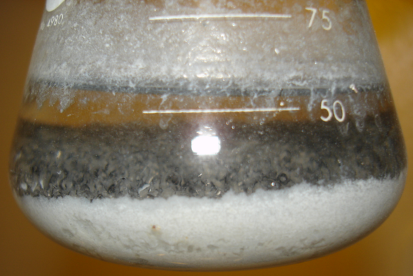

AWESOME results with tetralin
NurdRage - 29-12-2010 at 14:26
Once again i was back at it verifying "negative theory". I know it seems like a waste of time, but good science uses theory as guides for experimentation, not substitutes.
Tetralin wasn't supposed to work since it was aromatic, but since i had lots of it (for making lithium sand) i thought i'd try it anyway. I figured if it could stand up to molten lithium it should stand up to molten potassium.
Anyway, When I did it I didn't make accurate measurements since this was a qualitative experiment and just kinda eyeballed the reagents since i had done it a dozen times already. I did the usual dehydration step and popped a shot of alcohol. Then i heated the solution to vigorous reflux and walked away for 1 hour while i tended to other things.
Came back and saw:
Potassium in Tetralin.jpg - 26kB
I wasn't expecting this so i wasn't filming it, needless to ssay i was :o :o :o :o :o
Anyway, the reaction is FAST, in just one hour it went to completion and gas evolution stopped. It might even have taken less time since i wasn't monitoring it for an hour. Perhapes the crudely eyeballed amount of t-amyl alcohol used might be the bigger contributor to the rate so i'll try again under more quantitative conditions later.
Since tetralin is so dense (0.97g/mL) floating coalescence took place and i got all the potassium crammed into one ball like with my paraffin runs. Despite the vigorous reflux the ball still maintained cohesion.
So with tetralin we're getting the advantage of HD paraffin of floating coalescence without the disadvantage of longer reaction times.
I'm not certain about the yield yet, since i didn't accurately measure anything when i started. Like i said i'll do a quantitative run later.
Now i know not everyone can get their hands on tetralin but i think the bigger result here is that aromatics can work. So we don't need to go out of our minds to hunt down perfectly aliphatic solvents. Since aromatics tend to be denser we might have an easier time brewing up some floating coalescence capable solvent mixtures.
On a different note, this also highlights the good practice of verifying all assumptions and theories with hard data or citable sources using exact conditions. Occasionally we might uncover diamonds :D
I guess Woelen needs to update his page ;)

Sedit - 29-12-2010 at 16:44
Awsome results Nurdrage, am I correct in assuming that what I see there on the top that looks shinny is Potassium? If so then that looks very lovely.
I wanted to ask and sorry if it was already but has anyone considered the use of Cyclohexanol? I would think, even more so now that the alkoxide of it would be more soluble in paraffin oils and higher boiling point as a short chain alcohol. At 160 degree Celcius boiling point I would think its use would be well suited here.
NurdRage - 29-12-2010 at 17:11
yeah, the shiny metal "island" in the flask is actually the top of a single large ball of potassium.
As for your cyclohexanol question; since it's a secondary alcohol i think it wouldn't work. Isopropanol, another secondary alcohol, was already tried in this thread and that failed miserably.

len2 - 29-12-2010 at 21:37
Very interesting result Nurdrage. I have not thought of tetralin - and we have none in any of the labs - when when I get a chance Ill try it. The reason the reaction goes slow in heavy paraffins is that the alkoxides are not very soluble in them - even the t-alcohol doesnt dissolve all that easily. The aromatic gets around that problem.
I find the structure on the surface of K obtained this way puzzling. My electrolytic potassium never showed it
NurdRage - 30-12-2010 at 04:14
There is no structure, actually the potassium is still molten and it's shiny surface is reflecting the back of my fume hood. So don't read into it too much ;)
As for Tetralin, it's not easy to get so as a solvent i don't think it's viable for the amateur. The closest domestic thing i can think of is naphthalene, which is somewhat easier. Since it's solid, I think a mixture of naphthalene and paraffin might have all the properties we want of wide liquid range and high density.
Problem is the odor.
Nonetheless, with the realization that aromatics are viable again we can expand our solvent search.

1.58 g of Mg "shavings" from a firestarter and 3.06 g of reagent (though quite old) KOH hemispheres were added to a 125 mL flask containing approx. 50 mL of Kroger brand *mineral oil "laxative". The flask had a rubber stopper with a long glass tube in it. At the top of the tube was a balloon with a few small "needle-holes" poked in it. A wet paper towel was wrapped around the tube near the top. The flask sat in some sand in a 600 mL beaker. The stopper was placed on and the sand was heated (I can't find my damn glass thermometer so I couldn't measure the temp. directly) to a temperature of 200*C over a period of about 30 mins. Then, a hypodermic needle containing 0.6 g of mineral oil and 0.6 g of Reagent t-butanol (the alcohol did slowly dissolve with just a bit of stirring) was thrust through the stopper and injected into the solution over about 25 mins. I noticed "instant" boiling of the alcohol/oil soln. as soon as it hit the main mixute. Once the temp. got up to around 250*C there was sporadic boiling. S
tarting at about 200*C (I'm not quite sure on this exactly and will have to check my notes at home) there was quite a bit of gas evolution and it stayed steady for several hours. The t-butanol did seem to increase the amount of bubbles but it could've just been boiling. The reaction did not seem to proceed at all and after about 3 hours a few black specks were noticed floating around. Then the Mg started to turn black and eventually I started to notice a white "precipitate" on the bottom of the flask. It seems as if the reaction did not occur and the KOH just settled at the bottom and the Mg was oxidized (by H2O/air?) I desperately added quite a bit more t-butanol (unmeasured) and just got refluxing t-butanol in the rxn mixture. I finally stopped heating after 6 hours.
My guess is that there was not enough mixing due to the sporadic boiling. Also, the KOH could've been poorly stored and could thus be mostly the carbonate. It could also be the Mg but I doubt it. I simply shaved off Mg from the block with the tool that was included (and damn that took a long time and a lot of elbow grease; the battery to my drill was dead).
And before anyone says anything: Yes, I know there are different and better ways to set this up.
*The mineral oil said it contained vitamin E as a stabilizer.
The setup:
SETUP.PNG - 216kB SETUPCLOSEUP.png - 173kB
About an hour after adding t-butanol and 1.5 hours into the rxn:
MIDRXN.png - 541kB
The results:
RESULT.PNG - 374kB
Thanks for your time!

MagicJigPipe - 6-1-2011 at 16:31
I forgot to mention that I did swirl occasionally throughout the "reaction". About every 5 minutes or so. Also, there was no reaction upon addition of water to the flask after rxn. (and I didn't expect there to be because the Mg didn't even seem to react at all). However, the white 'precipitate' at the bottom was extremely insoluble in water. Mg(OH)2?
Since I don't think anyone has had this result before, could anyone offer any insight? I definitely saw alcohol refluxing throughout the solvent after I added a bit more later on in the reaction so something tells me it's probably not that...
Ah screw it. I'll just suck it up and buy some Shellsol. But I would really like to find a solvent and Mg source that people could very easily obtain and would still work (like what I tried). I suppose I could try a few more times and eliminate some unknowns like the age of the KOH (and whether or not it is mostly carbonate). I guess a titration could be in order.
I don't have internet at the moment so it might take me a few days to respond. Good luck to everyone.

garage chemist - 7-1-2011 at 07:54
I started the batch with the selfmade scrap Mg turnings.
On initial heatup, there was some mild hydrogen evolution, the KOH seemed to melt and solidify again after it had given off its water.
After adding the t-BuOH, there was no further reaction. It's been boiling for one hour now and the solvent is still clear, with no sign of potassium production. This is a striking difference to the first successful run with pure Mg powder where the solvent soon became very turbid.
t-BuOH is again solidifying in the condenser, a Liebig this time.
The batch is looking exactly like MagicJigPipe's failed attempt on page 23 of this thread.
If this batch fails, then we have one more reason to assume that the purity of the magnesium is important, since my turnings were absolutely clean and oxide-free.
[Edited on 7-1-2011 by garage chemist]

Results of the test batch with scrap Mg turnings:
After 4 hours of boiling, the surface of the turnings had become uniformly dark grey. Some ominous clumps of material had collected, but upon examination, they consisted of porous solid KOH. No potassium could be found in the mass, and upon adding it to water there was no reaction.
The turnings were only very superficially attacked and had seemingly become passivated, possibly by Al2O3.
The mixture still smelled strongly of tert-butanol, in contrast to the successful batch, which was practically odorless after the reaction.
So this, in conclusion, was a total failure, and further hints towards a necessity to use pure magnesium. Perhaps even firestarter magnesium is too impure.
The next step will be to make turnings from an ingot of pure magnesium, using the same drill as was used for the Mg scrap, to produce turnings of pure magnesium with the same particle size as the unreactive Mg scrap.
This will show whether the impure Mg was really the culprit, or if the turnings were simply too coarse.
