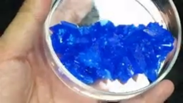

Aga can we use a battery and copper wire? I cant remember all the rules. I used an aquarium test kit and sure enough the maggot liquid is off the scale for ammonia even diluted 20x :D. Still totally unsure how to get around the platinum but there must be a way :D
copper method

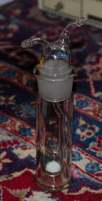

I am thinking electrolysis of water for oxygen and bubble that into it. first trial tomorrow, how do I titrate ammonia? smells pretty strong so maggots seem great at ammonia production and if you killed your mate on the desert island you would have loads of maggots after a couple of meals of course.

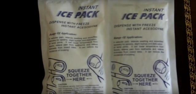

how about ammonium nitrate from ice cold packs?
if h2so4 is allowed then it's a piece of cake to make HNO3
that guy codylab has made HNO3 in many ways check out his videos

Na mate.
Bought Nitrates are a no no. As is H2SO4.
The situation is pretty much what you could find in a supermarket in the year 2050 where anything of any scientific value is regulated so far up the bum that you might have to sign your life away to buy 5g of NaCl.
Or what you can find on a desert island now :P

I am also trying the grass fermentation, but first I am giving it two days of free air but a little heat (26c), i chose this because I figured the stage would need air like a silage pit does, then its closed up to exclude most the air, in practice the farmers I know wait for the pile to drop a couple of feet then they seal the pit off (this is called a clamp in the uk), its different from the wrapped bales but gives much better feed. So I figured I would compact the grass a bit and wait till the level drops a little then seal up.
I might also add cow shit (tiny amount) as going the methane route as a start point is a good idea.
I am going to use one of these
fermentation.JPG - 88kB
at the moment my grass is in a plain glass jar, but once it starts to do something I can transfer to the fer mentor. it should give me good control over the fermentation and i can add buffers ect via the septum or one the tubes. It also has a stir thing and any gas evolved could be piped into this
wash bottle.JPG - 43kB
I might add some form of wet sugar like honey or malases (again tiny amount). i will let you know if anything happens. If it start to ferment I will up the temperature to around 30C, I found out methane ect should stop at 40c, this was from a bio gas page about a car in the uk running from the gas made from chicken shit back in the 70's, I will try and find the page again

Agari - 30-10-2015 at 14:50
Materials:
1 Instand cold pack (Either 86g of calcium ammonium nitrate or just 70g of ammonium nitrate), but not urea.
75g of potassium chloride bought at a grocery store.
Procedure:
Cut open the cold pack and isolate the nitrate contained.
Add the nitrate salt to a beaker.
Add 200 milliliters of water.
Stir the mixture until it has fully dissolved.
Gravity-filter the mixture into a beaker.
Heat the solution in the beaker to near-boiling (I did not record temperature) and add the potassium chloride.
Bring the solution to a boil(with stirring!) and gravity-filter it into a beaker.
Place the solution in a home freezer to precipitate as many Potassium Nitrate crystals as possible.
Carefully remove the upper water layer from the beaker,then recrystalize the remaining KNO3 crystals from water.
Freeze the solution again.
If done right,the result should be white potassium nitrate crystals and yellow-ish water on top,remove the water and wash the crystals with ice-cold distilled water (Available at Walmart).
Dry out the crystals on a watch glass.

Materials:
110 grams of Potassium Nitrate obtained previously.
Copper Sulfate.
Dissolve the copper sulfate in water.
Next,extract the carbon core from a single battery and attach a copper wire to it,connect our home-made electrode to the positive terminal of a power supply such as a battery.
Next,place a copper electrode at the bottom of the copper sulfate solution and connect it to the positive terminal of the battery. Suspend the carbon electrode above the copper electrode,make sure they do not touch!
If the carbon electrode erodes to the point of the solution becoming almost black,filter it out and subject the remaining solution to the same cycle using a different carbon electrode until it is clear. Once the solution IS clear,remove both electrodes,the liquid should be sulfuric acid. Alternatively,battery acid can be purchased at an auto-shop and distilled to maximum possible concentration, just writing that in case copper sulfate is prohibited.
I only used 60 milliliters of acid for my batch.
