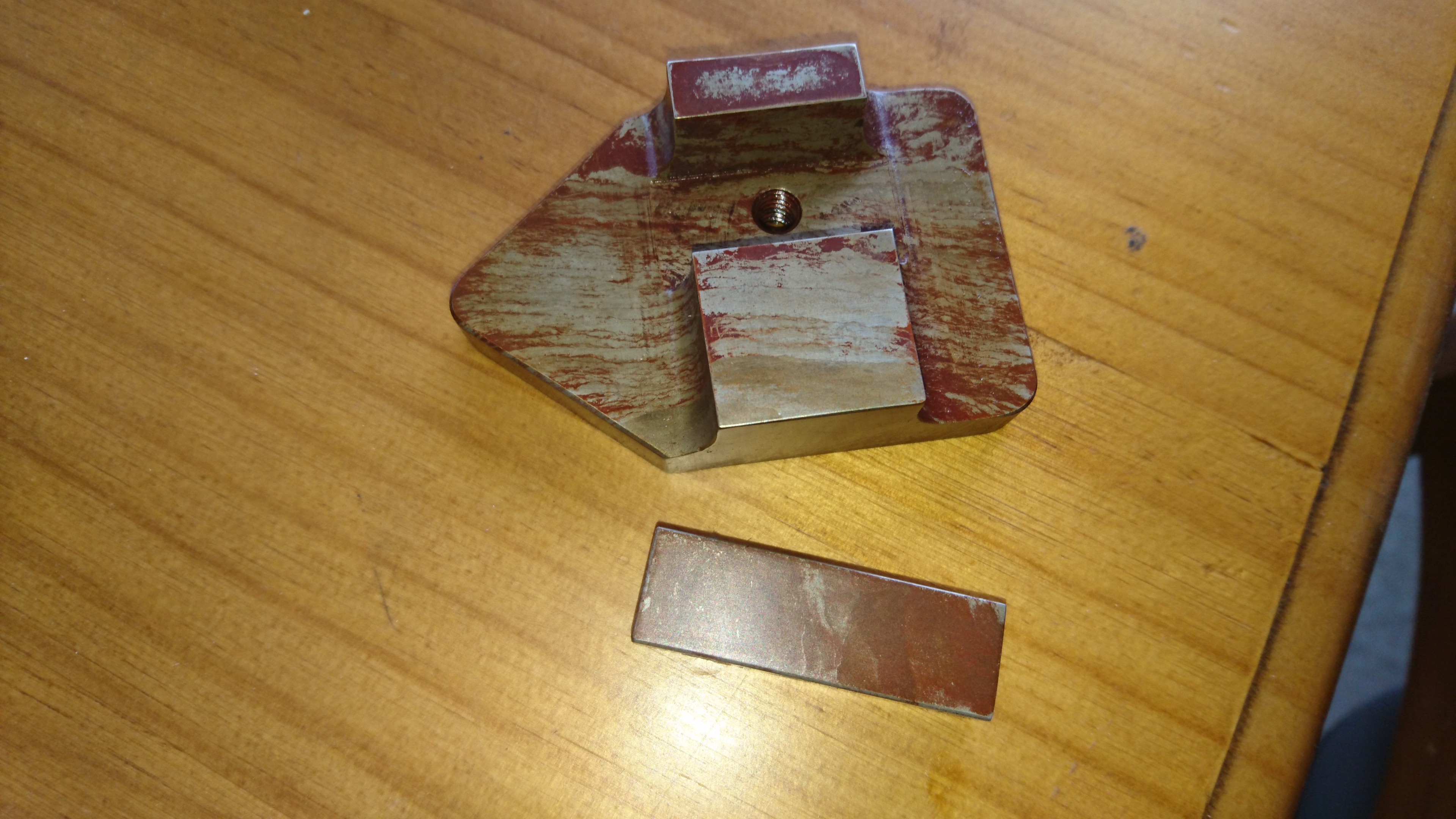

I managed to contaminate my nitre bluing tank with copper and nickel ions, it's a small pot that I use for bluing tools, about 2 litres containing approximately 1 mole potassium nitrate and 1 mole potassium hydroxide, I could use some advise on how to go about removing these impurities.
Thanks
ninhydric1 - 9-11-2017 at 22:12
@NedsHead I would assume that the hydroxide ions from the KOH would precipitate the copper and nickel ions from solution. Maybe wait and see if any precipitate settles to the bottom of the bluing tank?
NedsHead - 9-11-2017 at 23:21
Thanks ninhydric1, I made a solution of the bluing salts and was able to filter off the precipitate, it looks to be mostly copper.
below is a picture of the failed part to be blued, it's the components to a vernier height gauge
DSC_0328.JPG - 2.7MB
violet sin - 10-11-2017 at 00:28
Could you attempt to plate out soluble metal ions with carbon electrodes and then filter or decent your solution. Set it aside long enough to get the pot clean? I can't say I have tried this, but I would think it might have a chance. Not sure if you want to use the pot as an electrode, cathodic protection or no. Graphite battery rods and a usb hookup 5v between them may just be easy enough to try for a few min, with little setup effort. If it works awesome, if not no huge loss.
I did a quick search on that bluing, it had water in the mix, ie. per gallon directions. Yours is the same ya? Or just salts melted when needed for dipping? Pretty sure I have seen hot dipping that included no water, on you tube. That would be less fun, and possibly a poor memory so incorrect.

Nedshead: Leaving some scrap steel in the solution should plate out any dissolved Cu/Ni. From the pic it looks like this is what happened to your part.
Is the bath aqueous (caustic black) or molten salt? I use two parts by weight of NaOH and one part Na/KNO3, adjusted to a BP of appr 135°C. Some recipes call for nitrites, but it works fine without. Besides nitrites should form in situ as the iron is oxidized.

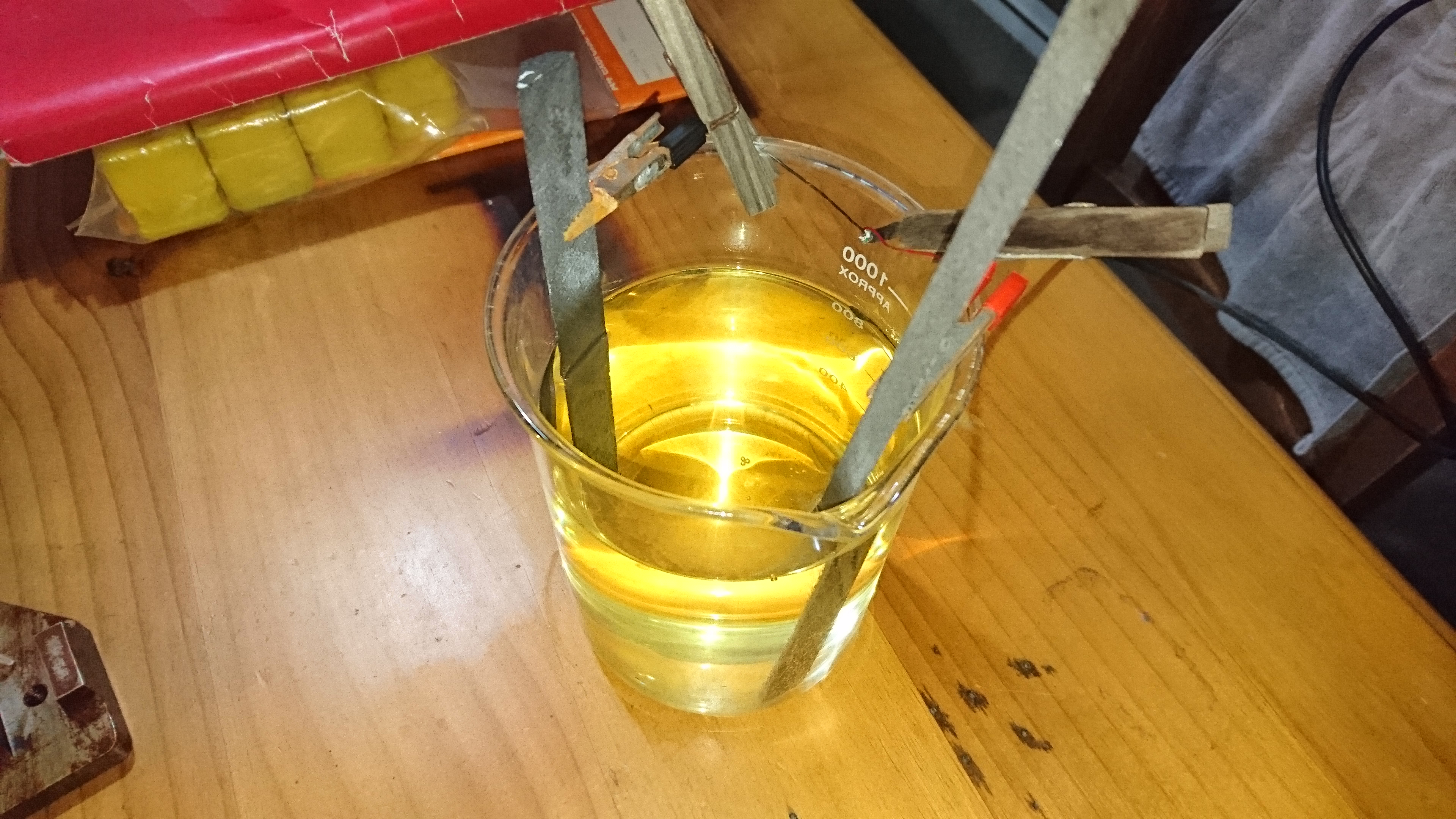

NedsHead - 21-11-2017 at 00:23
Hey VS, I'll dilute some and run a test to try plate it out with carbon electrodes as suggested, Thanks.
The formula I use does call for water but I got tired of controlling the evaporation so just let it become a block of solid salts and used it that way.
