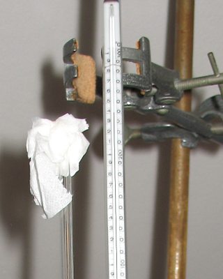

Below follow pictures of the setup I used. The third picture shows that the test tube is filled with white fumes and the glass is wetted. There is some refluxing of t-butanol. The fourth picture shows a typical temperature readout during the experiment and the final picture shows the result.
Unfortunately the result is no potassium at all. Definitely there is some reaction (evolution of gas and formation of a white solid, other than KOH), but no potassium metal is formed.
setup.jpg - 50kB setup2.jpg - 47kB

So, in the first experiment I had no results. I added the t-butanol, dissolved in some paraffin oil in two steps with 20 minutes in between by letting it run through the thin glass tube (I did not want the air to be replaced inside the test tube). Initially, before heating, I flushed the air in the test tube with butane gas to be sure that no oxygen remained. I capped the glass tube with a thick dash of paper tissue which was wetted. At the start of the experiment a small amount of gas was released through this outlet, lateron, I pushed it firmly on the tube and no exchange of gas seemed to happen anymore.
I have kept the test tube in the hot sand bath for around 1 hour and then I allowed it to cool down slowly (which took another hour). Not the faintest sign of formation of potassium. No shiny globules. Pok states that in 20 minutes, but certainly in 30 minutes after adding the tert-butanol one should clearly see shiny globules of potassium. Nothing at all!
In the second experiment I did something unwise ;)
I went outside, took a test tube and put in fresh reagents and with a clamp, I kept the test tube above (not in!) the flame of a propane torch. I did this outside just in case the test tube would crack and the very hot mineral oil would catch fire. With this setup much higher temperartures are possible. I had a very vigorous reaction in this experiment. A thick white cake formed, sticking at the glass and excess Mg-powder was floating around in the mineral oil. I allowed this situation to last for around 30 minutes after adding the tert-butanol, but again no potassium is formed. Part of the Mg reacts, a lot of gas and white smoke is produced, but no K-metal. The vigorous reaction only lasts for a few tens of seconds, after that I had a clearly visible formation of gas, but it was not violent at all.
The KOH, used in my experiments is in the form of half-spheres, diameter around 4 mm and thickness at most 2 mm. The Mg is in the form of moderately fine powder (according to label it is 65 um to 100 um particle size).

I have had the whole setup in the sand bath cool down completely and I found it was time to cleanup the mess. I added some water to the paraffin oil with the sticky goop inside which is mostly white, but also contained some remains of unreacted magnesium. I was met with a crackling and roaring noise as soon as water went into the test tube and bubbles of gas were produced. I decided to allow the concentration rise somewhat by pressing my thumb on the open end of the test tube and wanted to light the gas with a cigarette lighter, just testing for hydrogen. Suddently, while I still had my thumb on the open end of test tube, the gas mix above the oil exploded :o and immediately after the explosion there was a fairly strong underpressure. Luckily the test tube did not crack and I did not drop it! My heart skipped a few beats :o
After I recovered ;), I took the test tube (it still made a crackling noise) and swirled it somewhat and suddenly a 5 cm long pinkish flame erupts from the test tube and a WHOOP sound is produced. My heart skipped another beat ...
This kind of behavior can ONLY be explained by assuming that some potassium is formed. It only is a minute quantity and it is not formed in the form of nice globules, but definately some potassium is formed. The potassium reacts with water, giving hydrogen gas and when the liquid is swirled, then potassium at the liquid/air interface can form very hot spots, capable of igniting the hydrogen air mix above it.
The second experiment with the test tube above a flame of a propane torch indeed did not make any potassium. So, high temperature and fast reaction is not favorable. Slow reaction in a sand bath is one requirement for making potassium.

Yes, this result certainly gives hope for better results. The potassium I had must have been very finely dispersed and mixed with the white material and unreacted magnesium, but at least it is proven now that this reaction indeed can make potassium. It might be that the ShellSol D70 allows better coagulation of potassium into larger spheres. The oil I used is quite viscous, the ShellSol is much more like water and that might help.
Let's see what blogfast's results will be when he has all the reactants. I'll try tomorrow with Mg/Al and (hopefully) next weekend with ShellSol D70.

blogfast25 - 13-12-2010 at 08:42
Well, my experiment didn’t go to plan and needs improving.
After the initial evolution of gas, presumed but not tested as hydrogen, the cork bung of the ‘refluxer’ kept being pushed out. I now have some right sized rubber bungs in the mail.
The question then was to abandon or soldier on without refluxer and I chose the latter, this time putting the temperature probe straight into the open Erlenmeyer. I started heating at 14.35 and gas started to evolve after about 5 mins. This carried on for about 30 mins: the consistency of the KOH/Mg mix changed substantially, becoming more ‘homogeneous’ presumed due to break down of KOH flakes. Then the refluxer started failing and I carried on without it.
At 15.00 I reached 190C with a nice boil and started gradually adding the t-amyl alcohol (2-methyl-2-butanol, BP 102C) over a period of about 15 mins.
At about 15.15 the reaction mix reached 200C. Toggling the gas mark slightly between to settings I managed to keep the temperature quite constant and close to 200C:
Heating to 200C was maintained till 16.00. I saw no perceptible changes in the white/grey mass and no globules of K appeared.
Failure may be due to:
1. t-alcohol distilling off: no K t-amylate formed
2. oxygen: seems rather unlikely; there was a net outflux of solvent vapour all the time
3. magnesium: pok’s is about my size but it has very clearly considerably more surface area: mine’s basically small irregular little cubes. For a solution/solid type of reaction high surface area could be crucial to achieve some rate of reaction
4. t-amyl instead of t-butyl
5. other.
The stuff is now cooling down and a sample of the cold solid matter will be examined for evidence of elemental K. If none is found I may add a considerable amount of t-amyl alcohol and reboil.

I conducted a simple side experiment to try and show reactivity of 2-methyl-2-butanol (2M2B) (as a substitute for t-butanol, in the post) with KOH, NaOH, Mg ‘powder’ and Al.
About 4 ml of 2M2B was subjected to 1 g KOH (tube 1), 2.6 g NaOH (tube 2), 0.2 g Mg (tube 3) and 0.3 g Al (tube 4):
All were subjected with regular 'shaking' to 30 mins of steambath, average temperature about 97C, just below 2M2B’s BP of 102C:
Here are the tubes after wiping dry and cooling:
First off, tube 5 (previously not shown) which is KOH with methylated spirits (EtOH with small amount of MeOH) after boiling. KOH dissolves effortlessly and completely in this solvent to a slightly yellow solution of presumably KOEt, KOMe, EtOH + MeOH and some water. As stated higher up by Nicodem.
Tube 1: KOH and 2M2B started discolouring right way and this continued right throughout the test. But I can’t say whether or not significant amounts of KOH reacted with the 2M2B. 'Something happened'...
Tube 2: similar to tube 1 but less intense discolouration.
Tubes 3 and 4: no reaction or visible change with either the Mg or Al.
It would be tempting to see if 1 and 2 contain some resp. K or Na 2-methyl-propa-2-oxyde but that's not so easy to do. But if any reaction took place it is certainly not comparable in scale to the dissolution of KOH in ethanol/methanol.
[Edited on 15-12-2010 by blogfast25]
