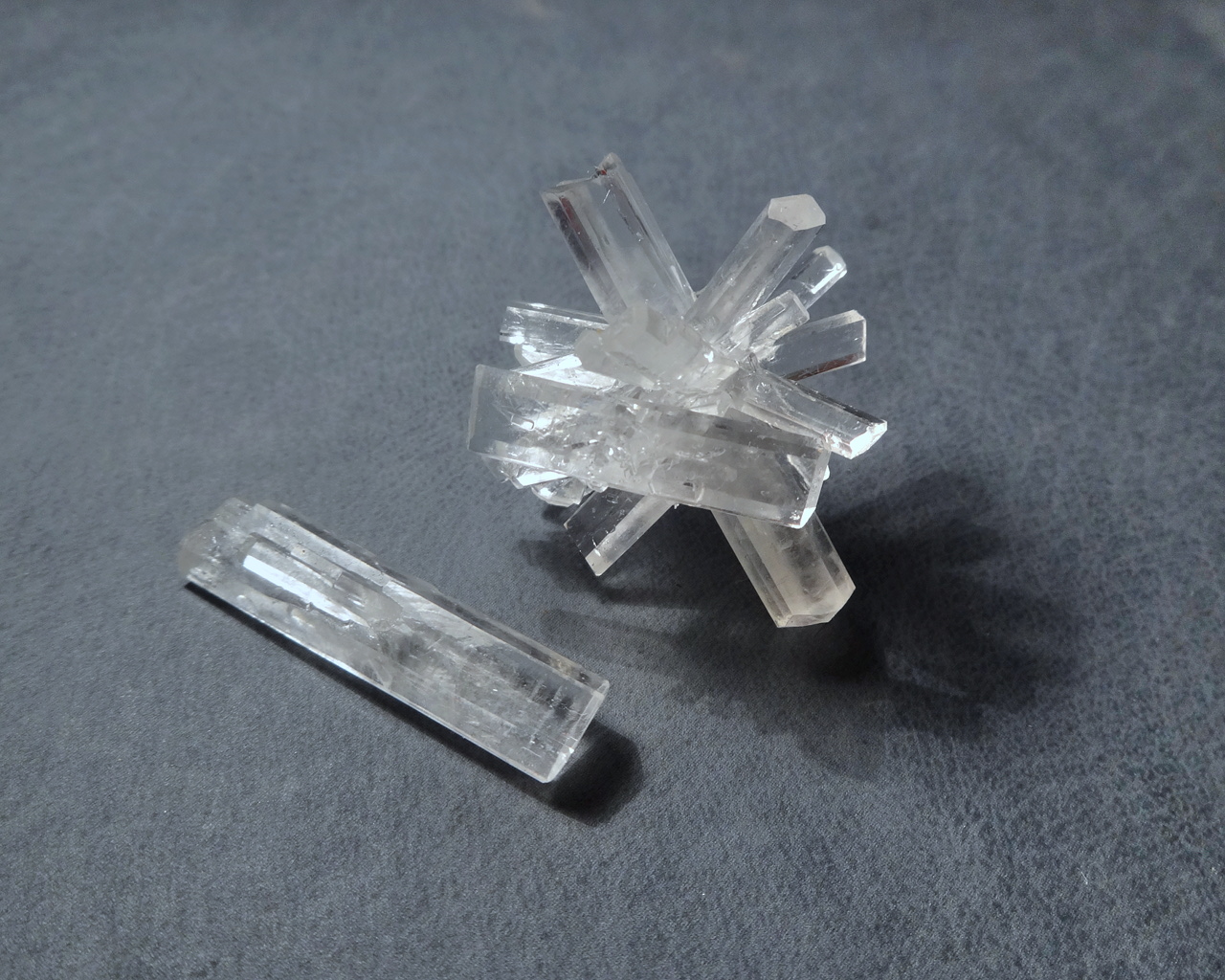

By the way, here is another compound that crystallizes really well: glutamic acid hydrochloride. I measured solubility to be around 50g/100ml. Finally, I have found some application for the sodium glutamate from the Chinese species shop.
DSC01775.JPG - 492kB
Looks great! How did you separate the sodium chloride from your sodium glutamate? Does it just crystallise out first, leaving the glutamic acid in solution if the pH is low enough?

Dmishin - 12-3-2016 at 07:36
[Edited on 11-3-2016 by Bezaleel]
Opposite of this. Glutamic acid has relatively low solubility (0.8g/100ml). I precipitated it with stoichiometric amount of sulfuric acid (cheapest acid I have), washed with cold water and then dissolved in HCl. Need to say that precipitate is rather bulky and washing is not easy.
If sulfuric acid is taken in excess, it dissolves glutamic acid again, probably giving its sulfate, which does not crystallize well (very soluble, forms syrup-like solution).

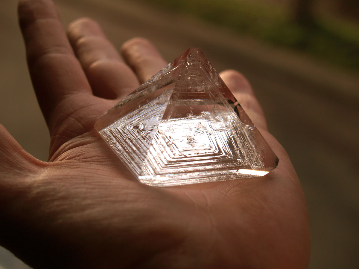

Cucurbit - 4-4-2016 at 14:07
Great topic, good reason to get out of lurk mode for once - first post!

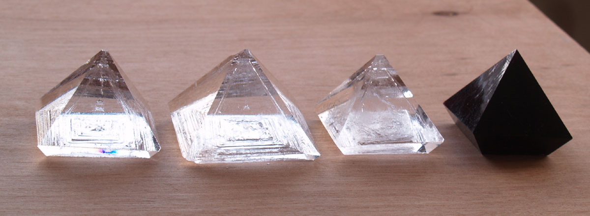

Here's a good old potassium aluminium alum crystal, the longest side is now 48 mm. Slow evaporation method, this one took > 6 months.
The photo doesn't do it justice!
alum_in_hand1.jpg - 156kB
crystal grower - 4-4-2016 at 20:48
Wow, that's gorgeous, it looks like huge diamond :).
Did you do something to prevent it from dehydration?
If not, do it right now! :) It would really pity to lose this one.
Dr.Bob - 5-4-2016 at 06:14
Cucurbit, that is a really beautiful crystal, like having your own pyramid, without have to travel to Egypt. Great job.
My favorite crystal is a chunk from the end of a silicon boule, about 5" in diameter, that looks like a giant Hershey Kiss. I got it from a place that made silicon wafers and it was supposed to be recylced back in to the melt, but someone there gave it to me as a gift. I have a few 3" wafers as well, never got any intact 5" ones, they were too valuable.
Cucurbit - 5-4-2016 at 08:59
Thanks guys!
Yes, I should put it in a jar when ready to protect it from dehydration, but it will be in its growing bath until it's... hmm, 6 cm mayby. A few days ago and I dropped it - can you believe it :o ... The tip broke off and has to regrow!
But chrome alum is probably more vulnerable to dehydration, the crystal at the right had almost completely degraded to a light purple powder, but I managad to re-grow the remaining core into its original shape. Remarkable how it seems to have a memory!

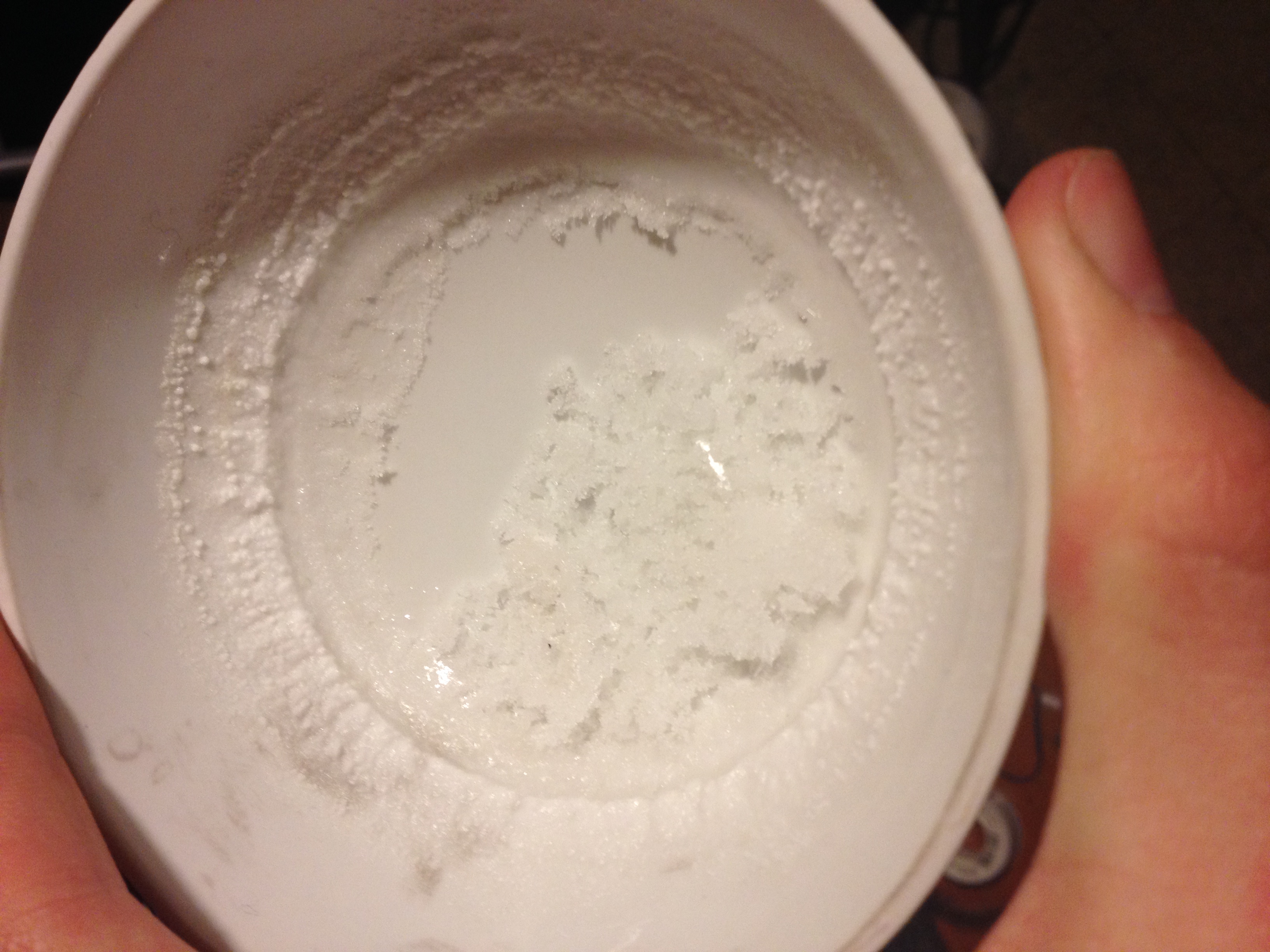

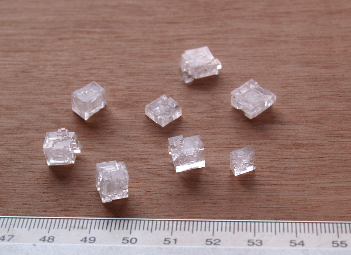

Also, a picture from some NaCl crystals I'm growing from sea salt. It's a difficult compound to grow into nice crystals but it's possible. I suspect the clumping agent (often ferrocyanide) in ordinary table salt prevents proper growth, it's like a negative catalyst. I hope I can grow these to a few cm, they are like architectural models!
P1014011group.jpg - 108kB NaCl1.jpg - 187kB

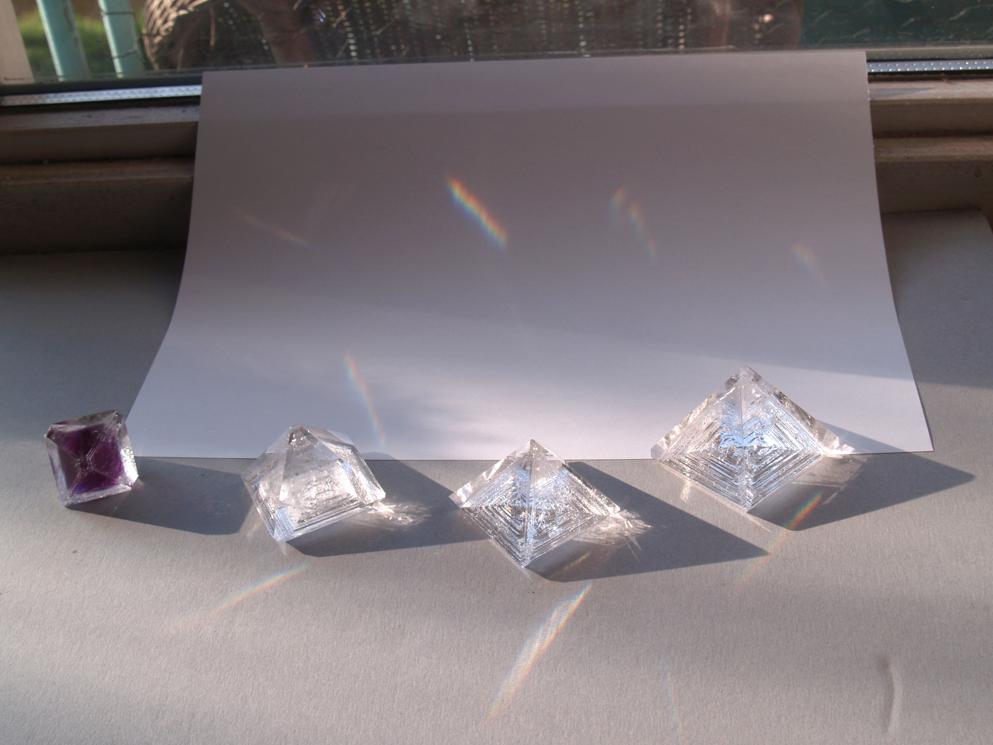

The Volatile Chemist - 9-4-2016 at 17:58
Really nice crystals Cucurbit!
I recently decided to try making some sample crystals of the shape of copper sulfate, to demonstrate its crystal habit (for fun mind you). Although I initially had some seed problems, I'm growing from a good sized base seed right now. I've always liked crystals but haven't really tried making any big ones till now. Going to be trying some of these in this thread later, perhaps...

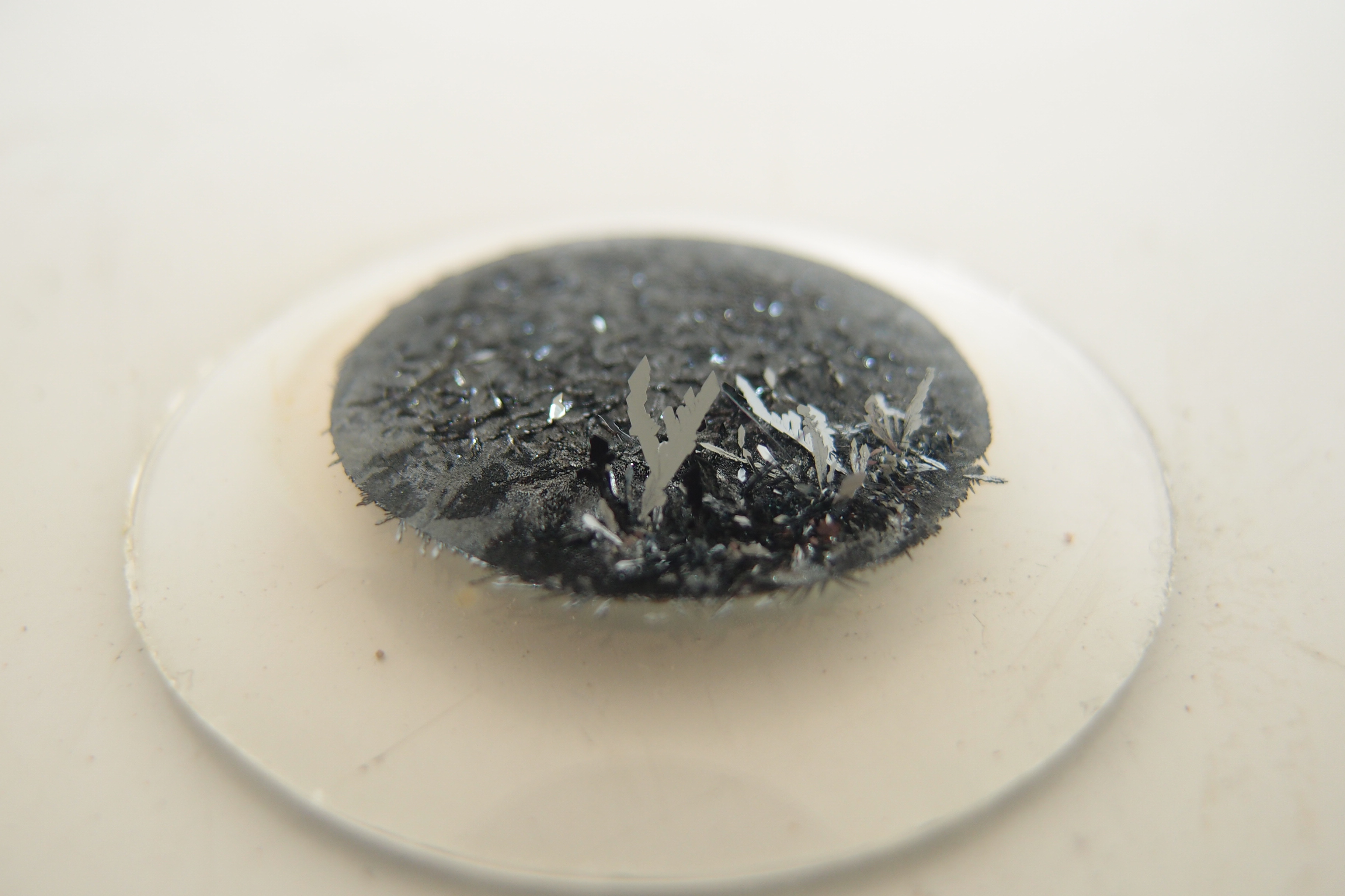

100PercentChemistry - 10-4-2016 at 12:51
Tin Ii chloride! When you run a current through it you get tiny crystals of tin.
crystal grower - 10-4-2016 at 22:26
I tried this too and got nice crystals of 2-3cm in lenght. Unfortunatelly, they were very delicate and I wasnt able to get them from a solution.

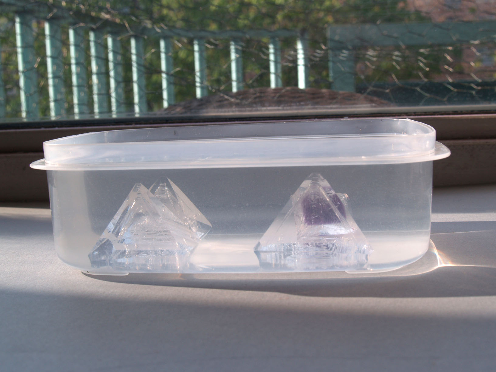

Cucurbit - 14-4-2016 at 08:48
Tnx! I'm using a tray from soft plastic, intended for heating microwave meals. Hydrophobic plastic is better than glass because there is less chance of crusts creaping up at the walls. I'll soon have to buy a bigger one :cool:
Weekly maintenance consists of filtering the solution and replenishing what was lost due to evaporation. I cover the tray with a 'roof' of paper to protect it from dust and slow down evaporation. It's standing in a small unheated unused room with a rather constant temperature. The rest is just 'neglect tek' :)
I'm glad to see the big one's tip has already grown back in a week!

Chemist_Cup_Noodles - 15-4-2016 at 12:16
Wow, that's a pretty good idea. Never ever would have thought of using a plastic tray to fix that issue, which has actually been quite a pain in the ass for me recently.
Cucurbit - 15-4-2016 at 14:11
I have to admit it wasn't my idea, I just read it somewhere, applied it and it seems to work!
And it's logical: the more water-repellant the container is, the better.
Glass attracts water, the meniscus is hollow, the solution tends to creep up by capillary suction and evaporation at the crusts's high surface area... a positive feedback loop.
It's no guarantee, without a paper cover I still got crusts, but I hope it helps :D

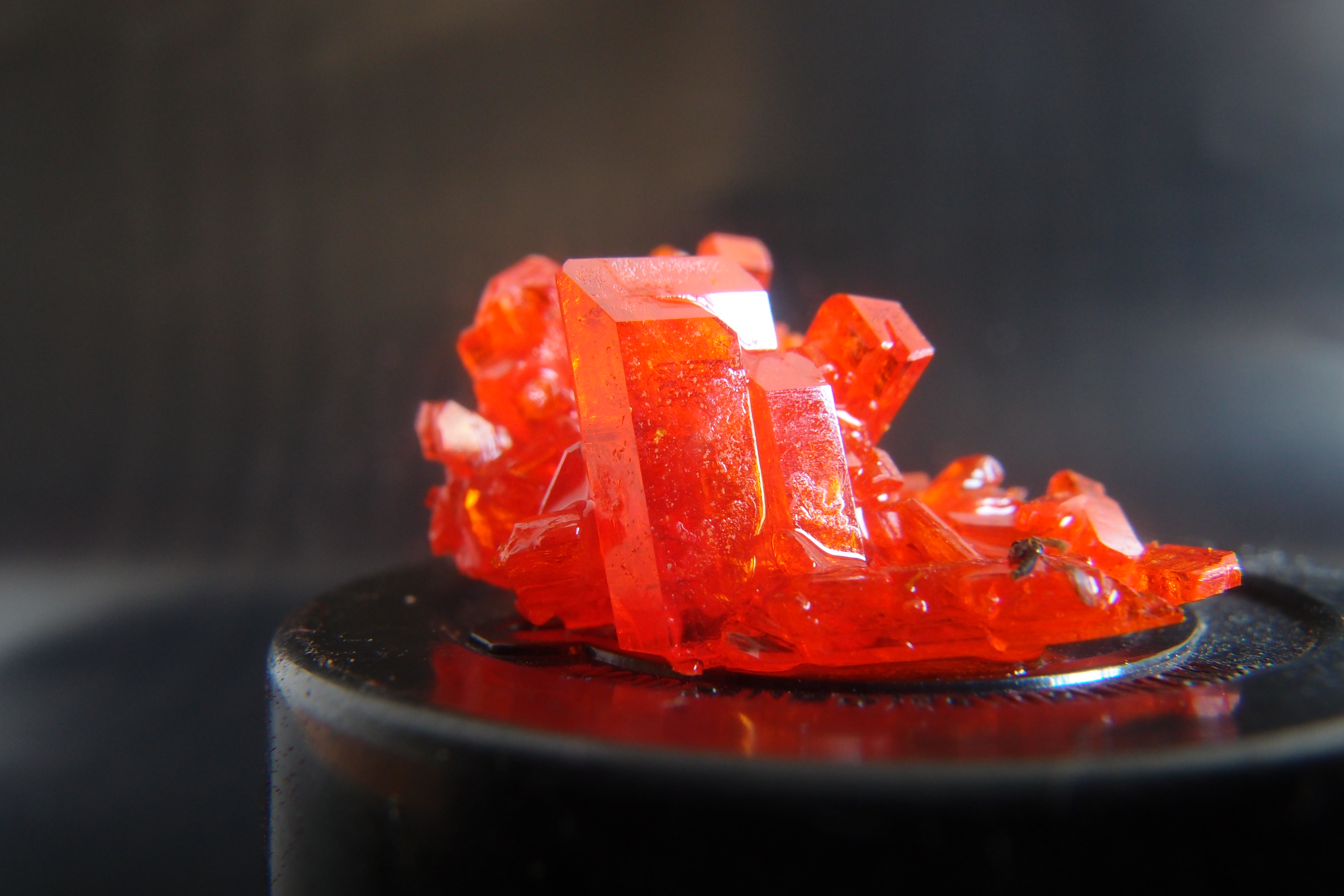

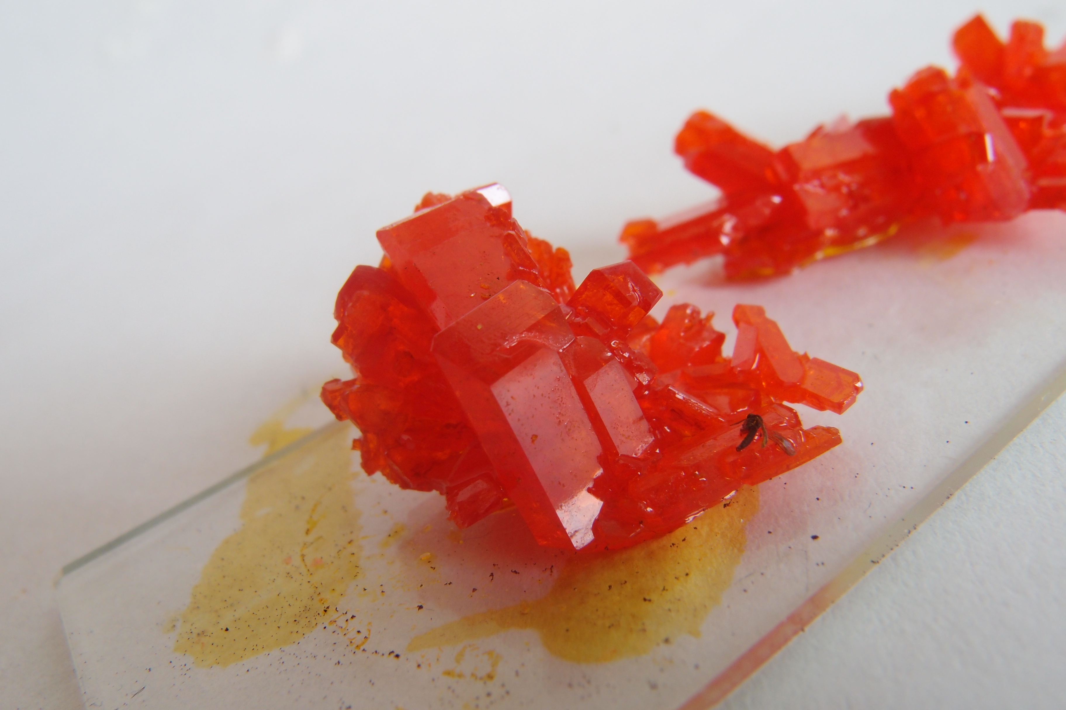

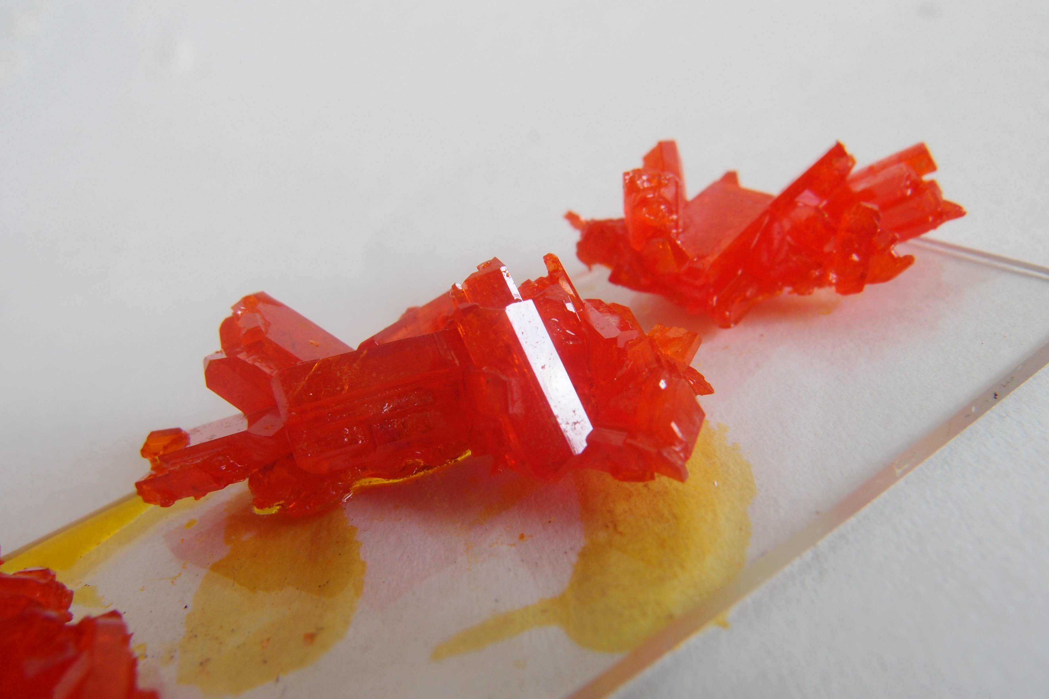

crystal grower - 26-4-2016 at 09:00
Some pretty K2Cr2O7 crystals.
P4263602.JPG - 3.7MBP4263607.JPG - 3.2MBP4263608.JPG - 3.1MB
Chemist_Cup_Noodles - 27-4-2016 at 10:23
Oh my god do I love the look of chromates and dichromates. For the life of me I can't find a good source of the anion, or even of chromium itself in order to make some. Maybe I'll just have to buy some and recrystallize it. I do wish that chromates were more soluble though. Anyone know good solvents for them? The mineral crocoite (lead chromate) is beautiful but insoluble in water.
But crystalgrower, if those are your crystals I'd love to hear the details on how you made and grew them. Chromium is seriously one of my favorite transition metals.
crystal grower - 27-4-2016 at 12:06
Frankly, these crystals have come from solution which I have forgotten somewhere in mess in my lab and when I found it after few months, there was a pretty surprise waiting for me :P. So time is best recipe IMO.
But if you want to try to grow these crystals a lot faster, you can try this procedure: http://chem.pieceofscience.com/?p=937. And Im sure you can get better results than mine. Although k2cr2o7 has only little water solubilty at room temperatures, the solubilty rises drastically with bigger temperatures, so repeated cooling seems to be very effective for crystal growing.

Cucurbit - 28-4-2016 at 12:52
Nice bichromate crystals!
And poor insect - unless it's a mosquito, I hate those :mad:
Which reminds me of something... many years ago I used potassium bichromate for gum prints, and got a nice crystal after evaporation of leftovers. I'll see if I can find it and take a picture tomorrow.
And Cup_noodles, I can't wait to see some pics of your alum crystals!

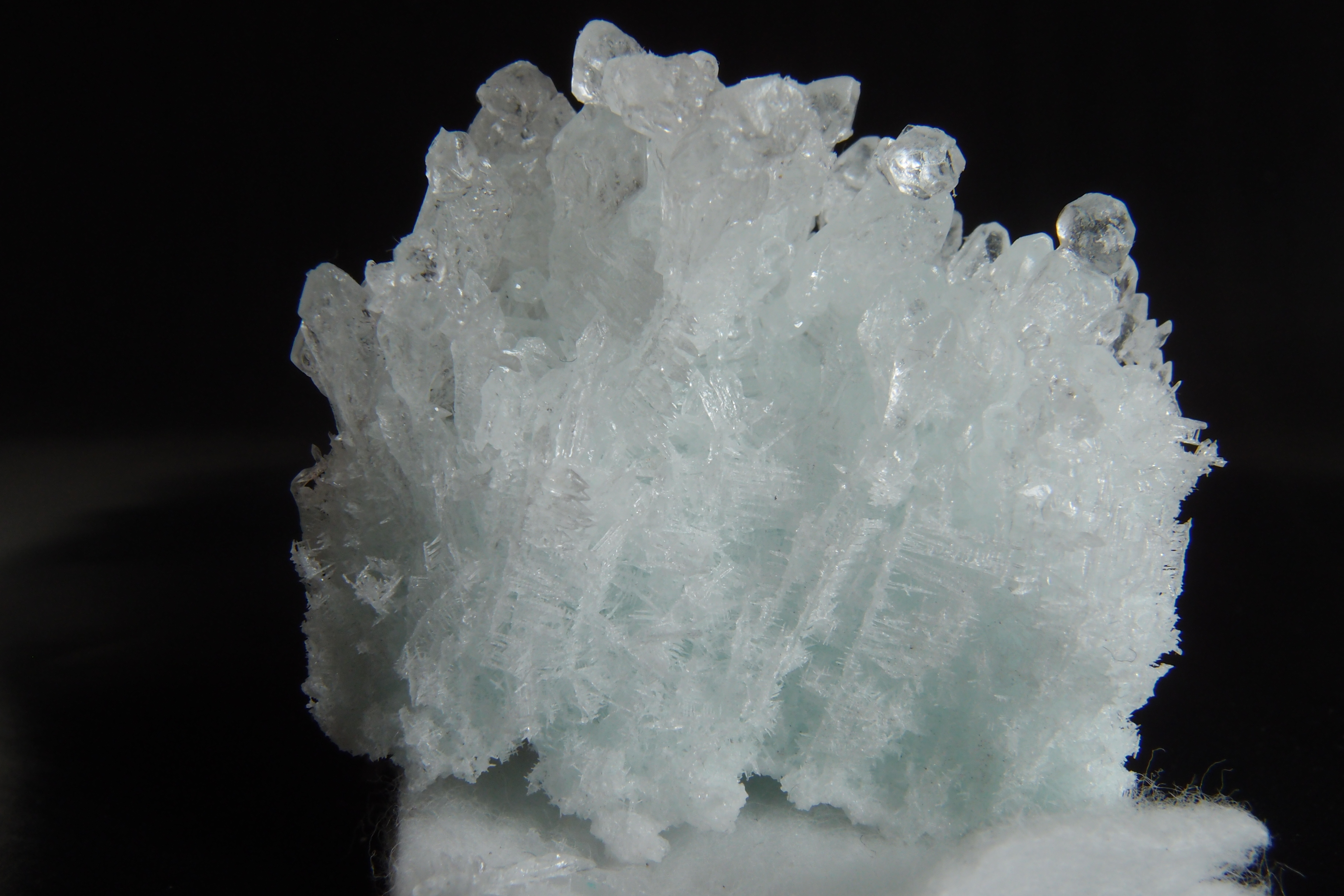

The Volatile Chemist - 30-4-2016 at 09:48
Ammonium Chloride surprisingly makes needle-like crystals, something at least I hadn't seen before.
image.jpeg - 1.8MB
crystal grower - 30-4-2016 at 11:08
@the volatile chemist
Once i grew nh4cl crystals with needle like shape too, and they had hashtag reminding layout ### :D.
The Volatile Chemist - 30-4-2016 at 14:34
Once i grew NH4Cl crystals with needle like shape too, and they had hashtag reminding layout ### :D.
:) Yeah, they were kinda unique, It might've had to do with excess ammonia or HCl, to be honest I forget which I used. What other shape grew for you besides needle-like? I just got a crust with beads, and then the needle-shaped ones.
crystal grower - 1-5-2016 at 02:30

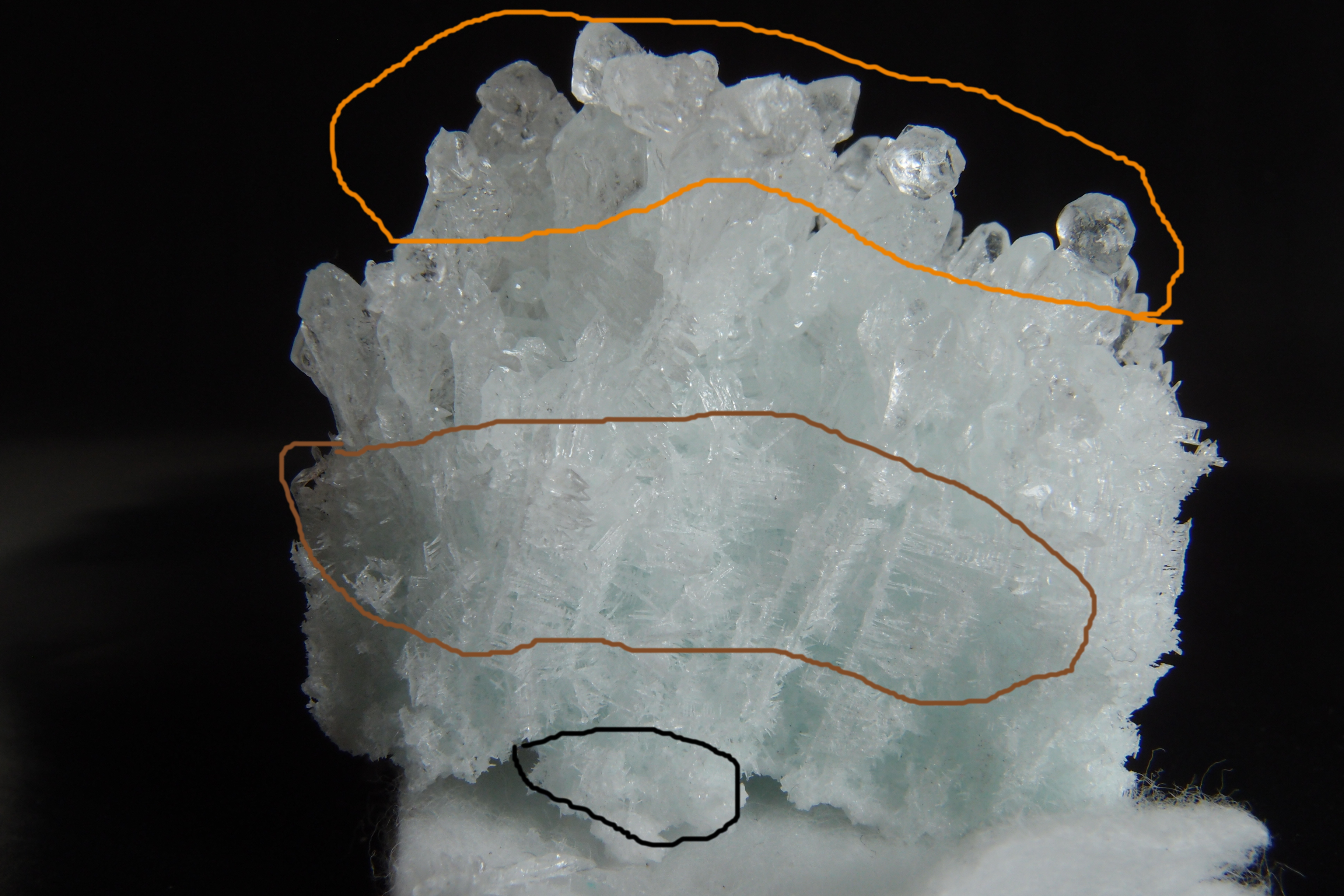

these are crystals of nh4cl that I´ve grown few years ago (I didnt care much about the procedure in that time, I just dissolved some sal ammoniac in the water and waited what it will do :)).
It´s interesting that it crystallized into "three forms". At the very buttom a crust was formed, above a # like needles crzstallized and at the top were something like prisms and another crystastals crzstallized on them (reminding me sceptre quartz)
Sal ammoniac is really interesting stuff and I´ll maybe write an article about it in near future :).
this.JPG - 3.1MB upr.JPG - 3.4MB

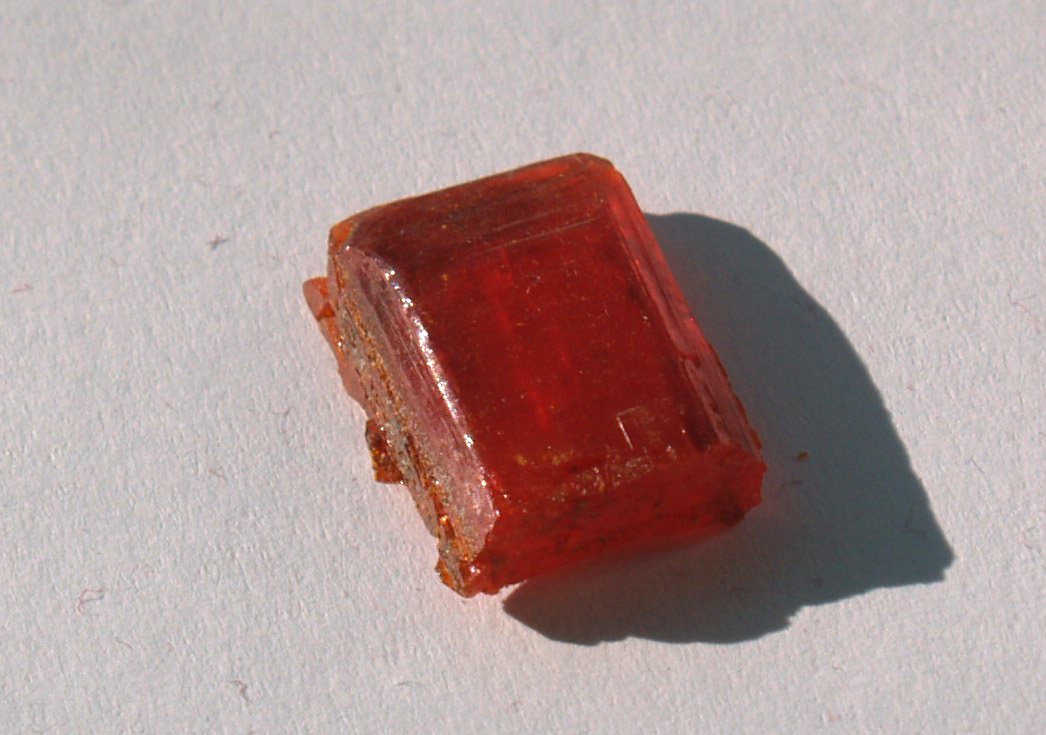

Here's this potassium bichromate crystal. Old, impure and damaged... in my memory it was much nicer but hey, I promised to post a picture!
bichromaat1.jpg - 198kB

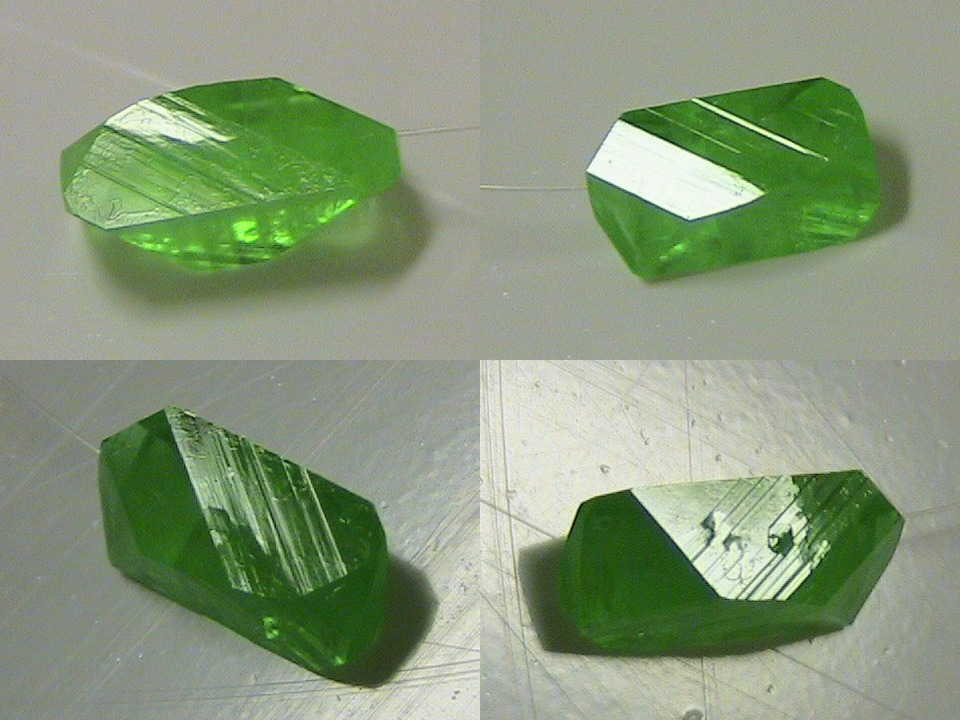

Velzee - 16-8-2016 at 21:38

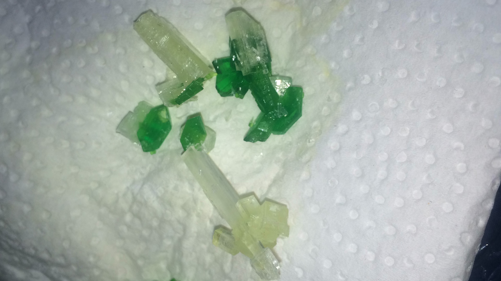

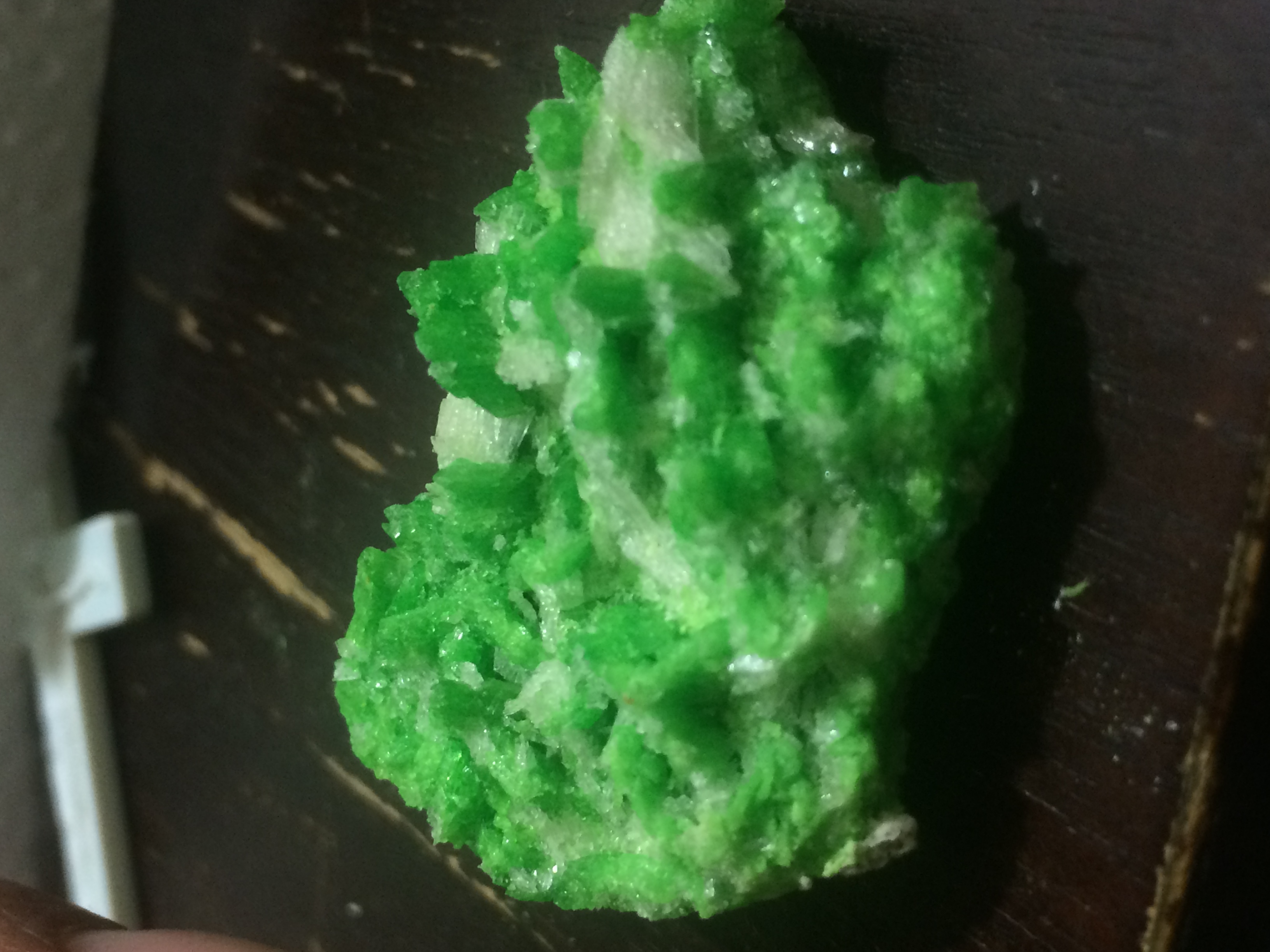

Potassium ferrioxalate crystals, contaminated with potassium oxalate and chloride:

Bezaleel - 9-2-2017 at 15:28
On pg 3 of this thread, Nezza posted a beam-shaped crystal of Pr2(SO4)3.8H2O.
Mine appear to have a somewhat different form. Here are 4 pictures of the same crystal. I needed to stop growing it further, because I ran out of solution.
The long side is less than 1 cm long.
Overzichtsfoto Pr2(SO4)3.JPG - 246kB
[Edited on 9-2-2017 by Bezaleel]
crystal grower - 10-2-2017 at 02:21
Oh my god, this one is just beautiful. Awesome clean crystal faces
woelen - 10-2-2017 at 02:55
These look very good. How long did it take to grow these crystals?
Bezaleel - 10-2-2017 at 05:16
I took a seed crystal from the solution, about 1mm in thickness, which was just big enough to tie a thread around. It was suspended in the solution from which it had formed for almost 1 week (6 days, if I remember well - I started somewhere last week). The solution evaporated in the boiler room with a larger beaker over it to keep out most of the home dust in the air. The air in the boiler room is relatively dry and the temperature is quite constant (between 19 and 22C). Evaporation speed was about 30ml from the 100ml when the crystal was first suspended from the monofilament thread.
Maybe it's interesting to know that a plastic beaker is preferred over a glass one, because in an earlier experiment with a solution of the very same Pr-sulphate, the solution crept upwards along the walls of that glass beaker (more than 8 cm up!). It forms ugly crusts on glass beaker walls. I also think that a plastic (PE) beaker makes it easier for the crystals to nucleate. In glass beakers, my rare earth solutions super saturate almost without exception.
The pH of the solution is 6.
Also of interest may be the dissolution behaviour. In order to get all of the Pr2(SO4)3.8H2O dissolved, about 20% more solution was needed than the volume from which the first tiny seed crystals appeared. I am tempted to conclude that the dissolution-crystallisation cycle has some hysteresis.
