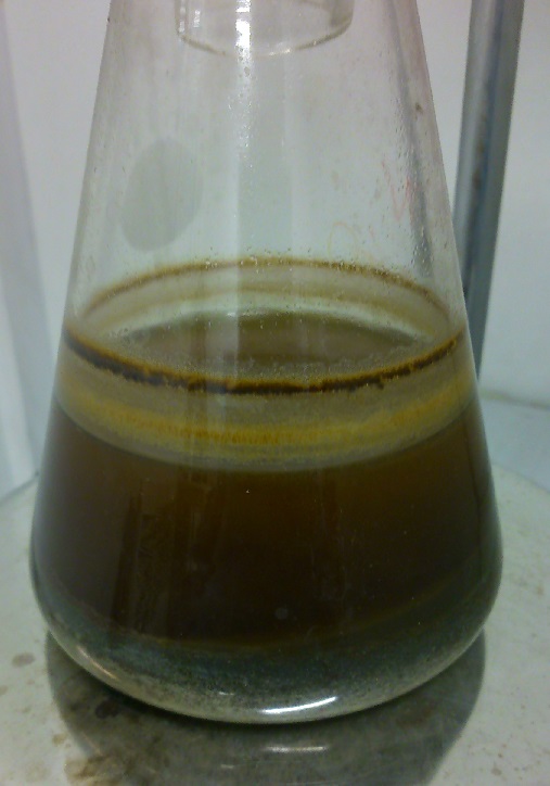

oberkarteufel - 7-5-2019 at 07:27
First attempt. Look kids, this happens when your solvent contains too much aromatics:
nye3ys.jpg - 76kB
Second attempt - as we can clearly see, there are small shiny balls of molten potassium neither floating, nor merely existing in mineral oil:
2nkkgk.jpg - 142kB
Third attempt - I got really optimistic during the "drying" step, as this time the mixture behaved differently - KOH became grey and fluffy, as gas was evolving:
ak9vde.jpg - 179kB
But later, when the temperature was raised and menthol added, the oil turned yellow again and no potassium formed:
357m3qo.jpg - 125kB
(this time, however, Mg consumption was visible.)
Also, checked the hotplate - when set to 208°C, phthalic acid (m.p. 207°C) in a beaker melted, so I am reaching the desired temperatue range. Well, the quest continues.

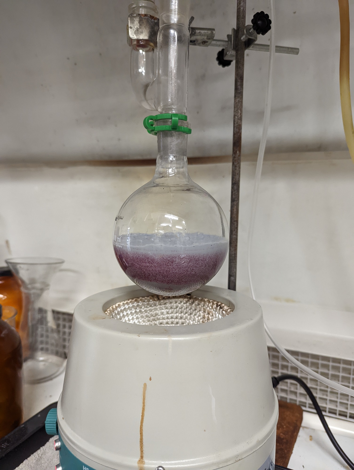

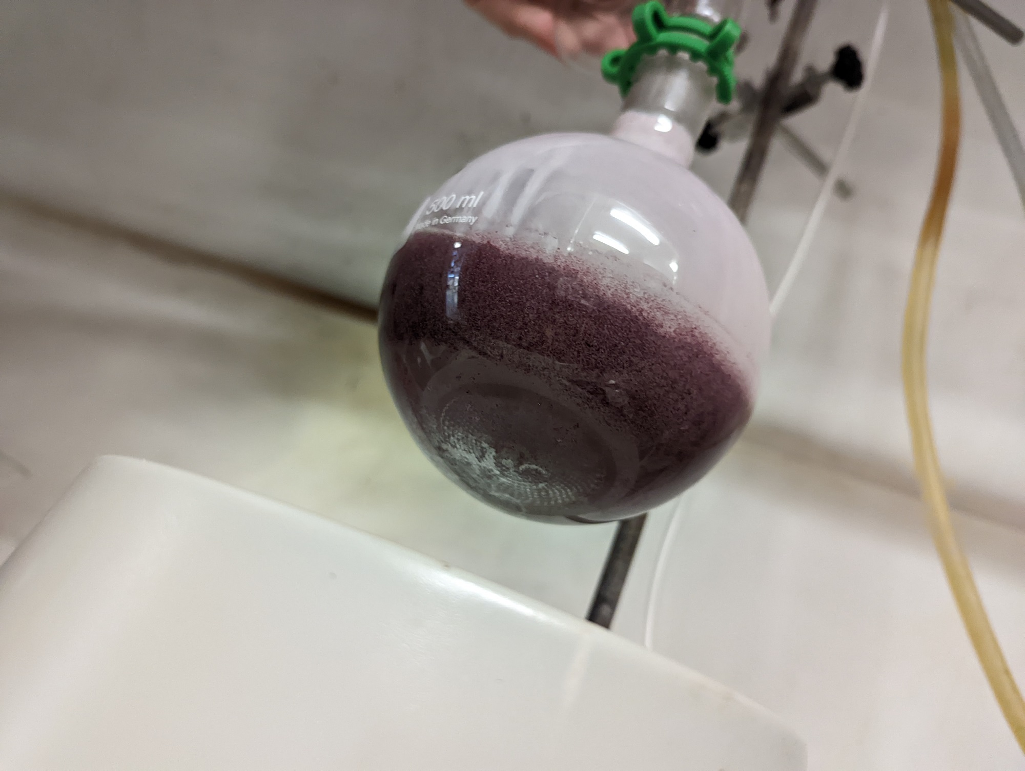

oberkarteufel - 3-12-2019 at 04:08
Well, for longer I've been away from this topic than expected, but I'm back with some new results.
I have tried t-amyl alcohol as a catalyst...
... and well it worked!
DSC_1108.jpg - 141kB
I am also now sure that I have issues with insufficient power output of my hotplate. With a lot of hassle I was able to produce only these little droplets of metalic potassium. Well, at least that's something.
I am inclined to think that either menthol isn't a suitable catalyst for producing potassium or that it is much less active than t-amyl alcohol. Shame, because it's cheaper and easier to get... Anyway - achievement unlocked ;)

isoPaarden - 25-7-2022 at 15:38
My K-Metal Synth looks a bit suss
Basically followed what DBX did but with a bubbler on top to monitor H2 production and I threw in a little K-Metal to dry it out (and protect the glassware)
Isopar as mineral oil
2mg Powdered Magnesium
10g KOH
Slice of K-Metal
Heated to 150deg C and held until H2 production slowed
Added 3mg Powdered Magnesium
Heated to 180deg C (just below reflux)
Added 2mL of T-Butanol in small additions (went blue here) over 30 mins
Raised to reflux (just over 180deg C) and held for about 1 hr (started going red/purple)
[Edited on 25-7-2022 by isoPaarden]
PXL_20220720_061431556.MP.jpg - 528kBPXL_20220720_061106016.jpg - 627kBPXL_20220720_060421734.jpg - 692kB
