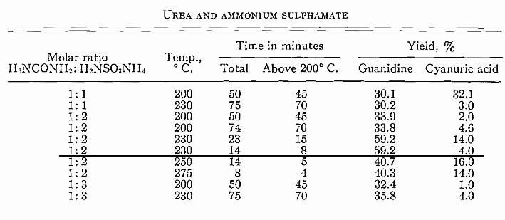

Ahh yep sorry, I edited it. At a quick glance that 6 looks like a 5.
Nope the yields are the same, the patent is basing the yields on the urea used but the sulphamic acid is the most expensive so more practical to calculate the yields off it. Both examples 1 and 3 yield 0.4g of guanidine sulphate from 1g of sulphamic acid. They are using a 2x molar excess of NH4 sulphamate in examples 1 and 2, but not for the sulphamic acid.

Reactions of Ammonium Sulphamate with Amides & Ureas
http://www.nrcresearchpress.com/doi/abs/10.1139/v56-214
* Side note :
On article page 1664 ( 3rd pg of pdf ) under the heading Alkylureas
" It was found that methylurea and 1,3-dimethylurea reacted with ammonium sulphamate
in a manner analogous to that of urea. Methylamine was isolated from the reaction mixtures."
This is also mentioned in the opening abstract , table IV does not show this perhaps an ommision ?
Table III
Guanadine .gif - 12kB
Attachment: Reactions of Ammonium Sulphamate with Amides & Ureas.pdf (358kB)
This file has been downloaded 3136 times
