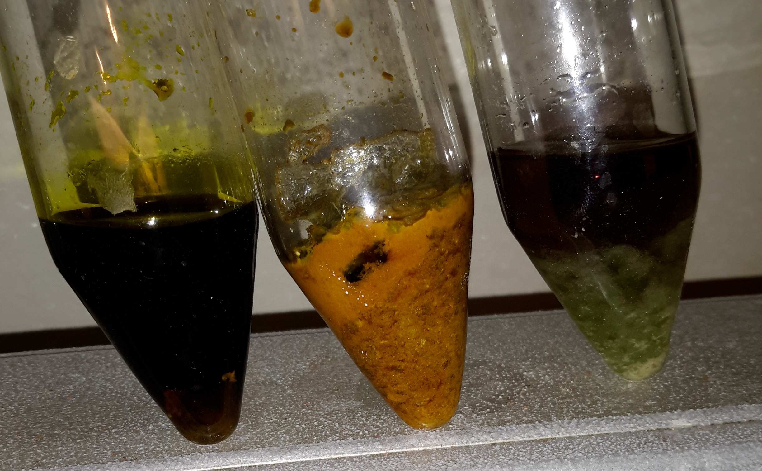

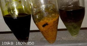

A little over a year ago I had some beautiful light green FeSO4 crystals but they eventually turned mustard brown color and just looked HORRIBLE!! I decided to try a few things to see what had happened to them so I took 3 samples and place them in HCl (31.45%), DH2O and H2SO4 31%
First two pics are HCL, H2O and 31% H2SO4 respectively from left to right
FeSO4 - in HCl - H2O - H2SO4 31 percent - image 2.jpg - 109kB FeSO4 - in HCl - H2O - H2SO4.jpg - 274kB

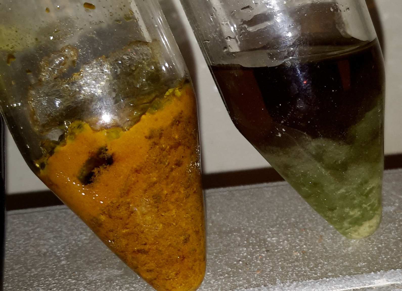

This is a closer look at the DH2O and H2SO4. There are really nice crystals forming in the H2SO4 while the DH2O looks like rust.
FeSO4 - in H2O - H2SO4 31 percent - image 1.jpg - 146kB

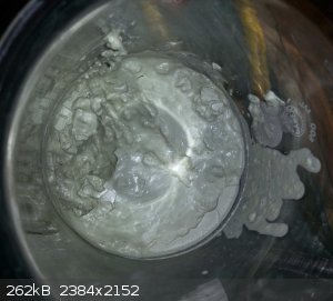

I had about 1L of crystals that had oxidised and seeing how the above resulted in nice crystals with the 31% H2SO4, I added about 25% H2SO4 to the bottle, allowed to mix and it turned to a grey color with some odd yellow flakes and occasional green crystal remaining. I heated to boiling while stirring, then decanted liquid and filtered. The liquid was a dark dark green at this point. I took the filtrate and vacuum distilled removing about 250ml of water and was left with what is below which was coating the sides of the boiling bottle.
It is a fairly thick paste with a little green liquid on top (fairly viscous - so probably H2SO4 of higher concentration). I took some of the liquid and placed it in a vial with some water to see what color solution it would make and that is what is in the final picture.
FeSO4.jpg - 262kB FeSO4 & solution.jpg - 114kB
What I don't know is how to get any remaining acid out of the part I boiled down. there is a lot more for me to boil down which has less acid, but I want to remove as much as possible.
