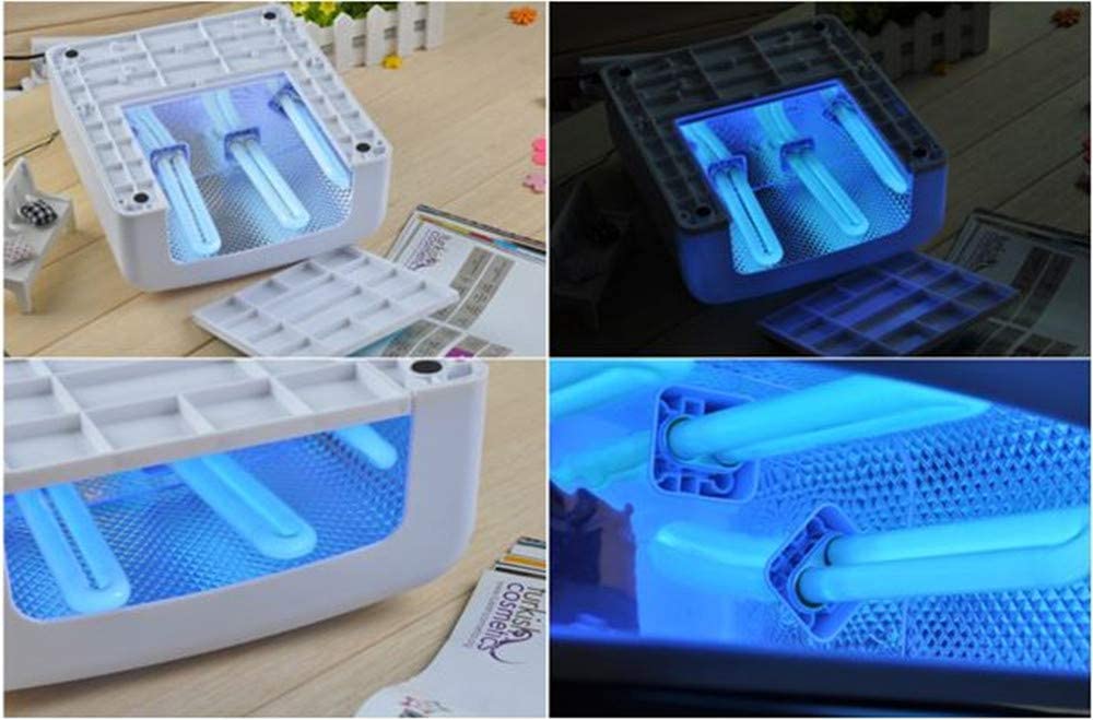

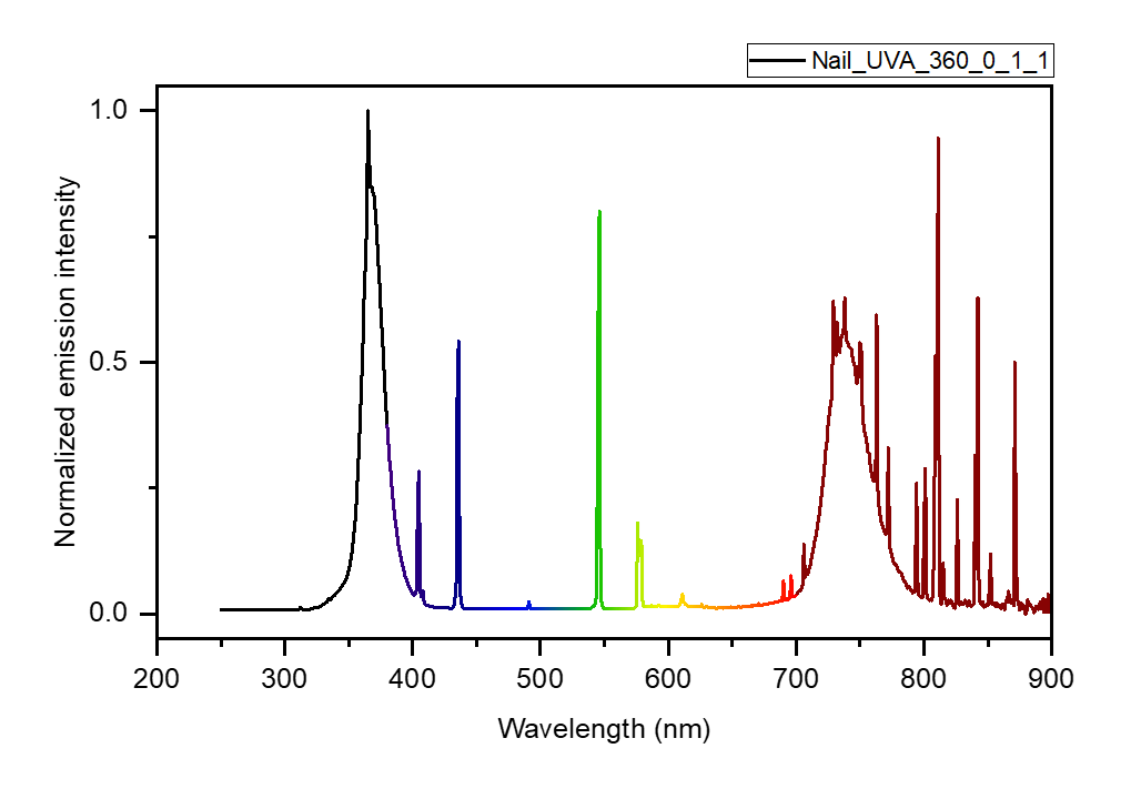

Generic 9W UVA Fluorescent tube, commonly sold for nail gel curing. (generic Amazon reference)
nail lamp.png - 45kBnail lamp1.jpg - 70kB
The emission max is 365±5nm, followed by 405, 436, 536, 576, 579, 738br

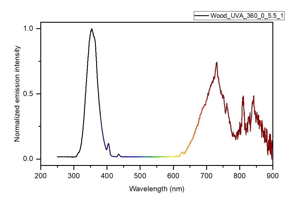

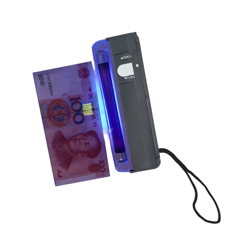

Generic 5W Wood's lamp, of the kind sold for banknotes. (generic Aliexpress reference)
wood lamp.png - 45kB wood lamp.jpg - 192kB
The emission max is 354±20 nm, followed by emission in the NIR at 731, 811, 842

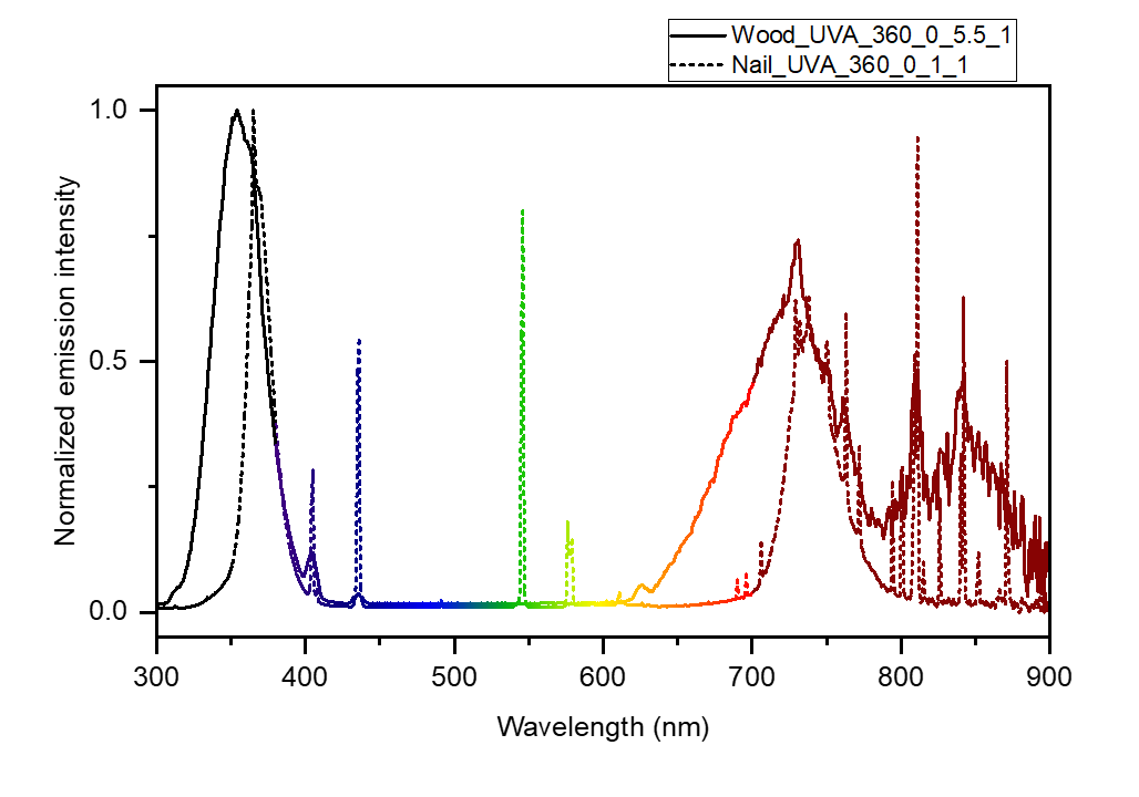

Comparing these two tubes shows why these UVA lamps are usually referred to as BL (Blue Light, lamp for nails) and BL-B (Blue Light-Black, Wood's lamp). A classic wood lamp is not as visible to the human eye and contains way less light in the green-yellow region.
nails-wood.png - 68kB

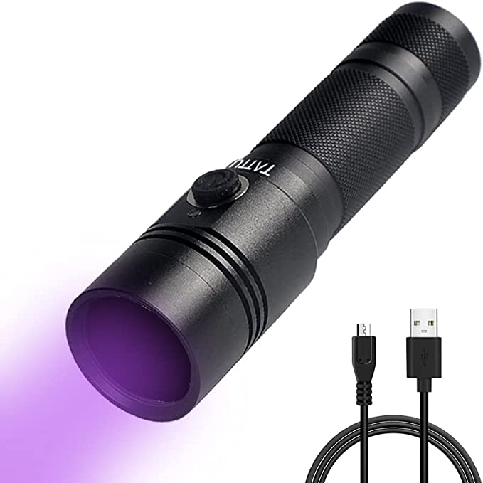

Here is the spectra of two commercial UV LED torches that I find are excellent, affordable and powerful, measured both with the glass filter they come with, and without. (Amazon for TATTU U1 and Amazon for TATTU U1s)
tattu.png - 51kB tattu u1s.jpg - 32kB
The emission is at 367±7 nm for U1s and 383±2 nm for U1.

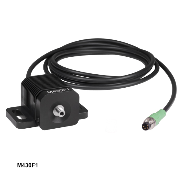

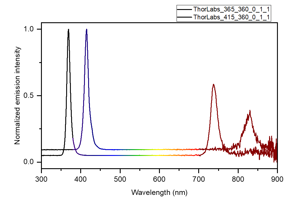

These are two UV LED lamps by ThorLabs, which probably range in the 500-700 eur each (generic ThorLabs reference).
thorlabs 365-415.png - 51kB thorlabs.jpg - 62kB
The emission is fairly sharp, with only a ±5 nm half width. There is NIR emission, though.

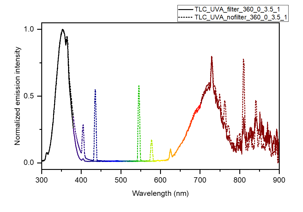

This is an UVA lamp found in TLC lamps.
tlc uva.png - 64kB
The emission is similar to the UVA lamp for nail curing, but the presence of a blue filter blocks most of the visible emission.

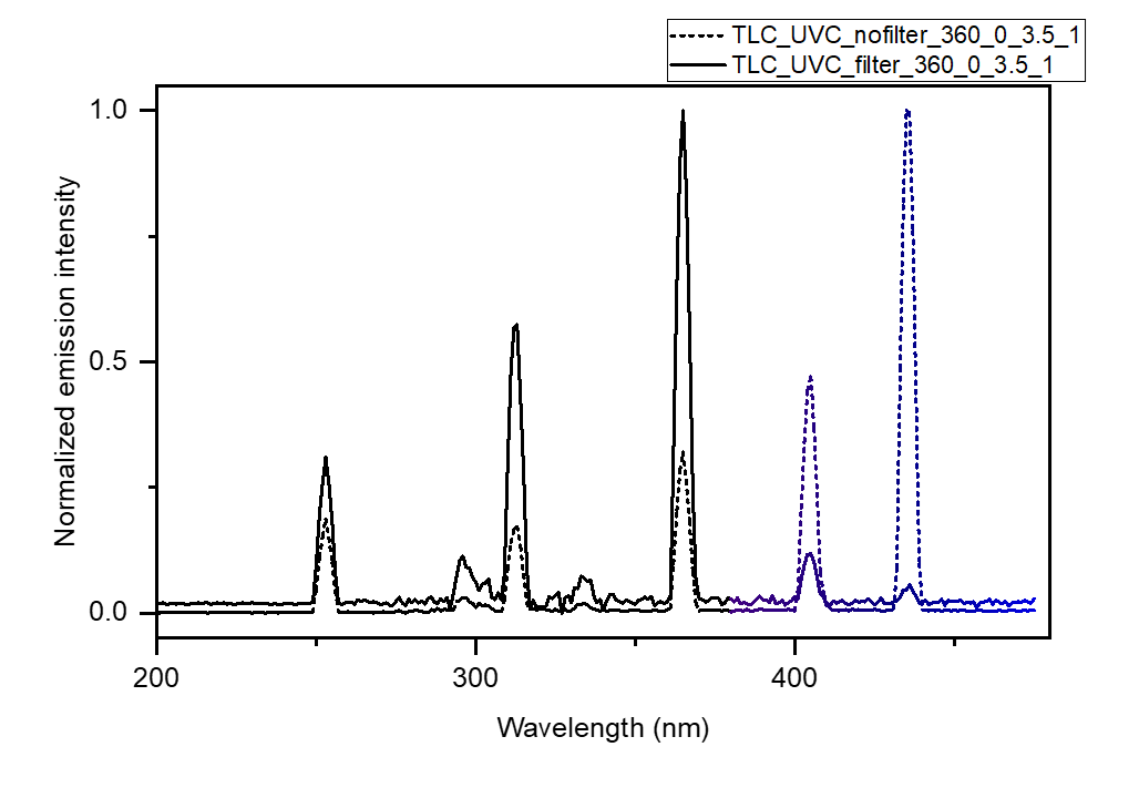

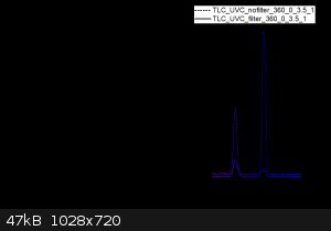

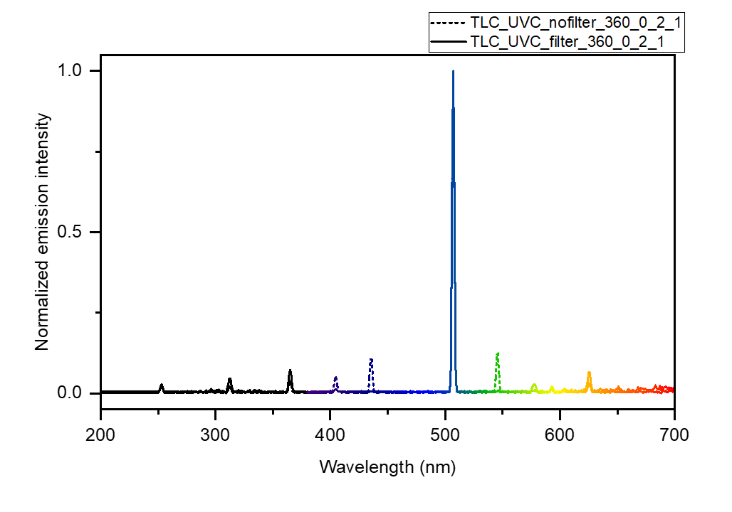

This is an UVC lamp found in TLC lamps.
tlc uvc.png - 41kB tlc uvc zoom.png - 47kB
The emission is most intense at 507 nm, with peaks at 252, 312, 365, 405, 436, 546, 578 and 625 nm. The filter present in the lamp mostly absorbs the light at the wavelegths in italics. The absence of this filter is likely why UVC lamps commonly found for water or surface sterilization are very poor at revealing TLCs, as they are too rich is visible and UVA radiation.
