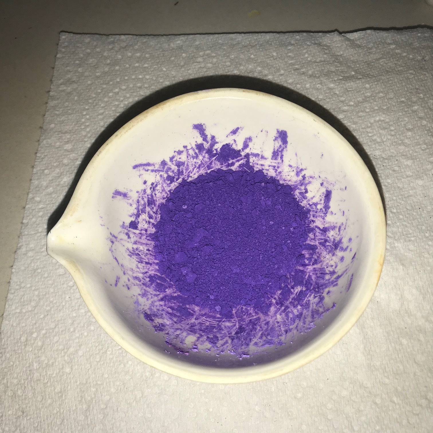

PHOTOGRAPHIC CHALLENGES - PHOTOGRAPHING PURPLE
Bezaleel had shared a very nice photo of his CoMoO4, and I also wanted something for posterity. I tried a few photos with a few different devices. My eyes said "purple", but the image said "blue". Blue? why were my photos blue? I quick google search showed that cameras have trouble capturing this particular hue of lavender/purple. No worries, time to use my D810 in raw mode with the 105mm macro lens with VR turned on, and do some lightroom adjustments. Lightroom is a little bit of a resource hog, but no worries, I got the job done by adjusting the blue hue and the photo now does a much better job of showing the colors of CoMoO4.
cobalt-molybdate.jpg - 648kB
Cobalt Molybdate sitting in my porcelain mortar.

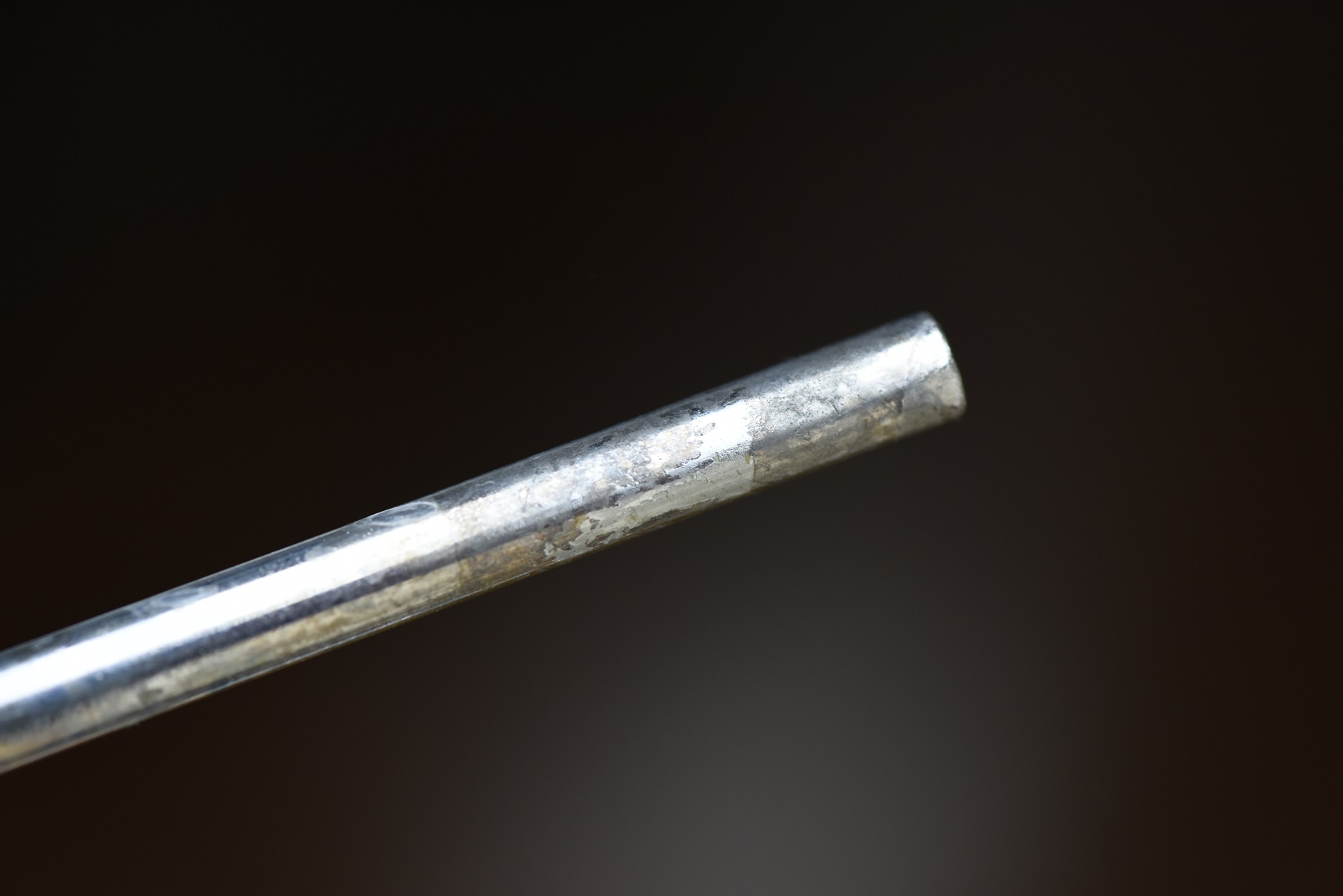

This is the corrosion on my stand clamp, after briefly dipping it into the Cobalt / Molybdate solution to retrieve my magnetic stirrer. Perhaps I should have studied my activity series better...

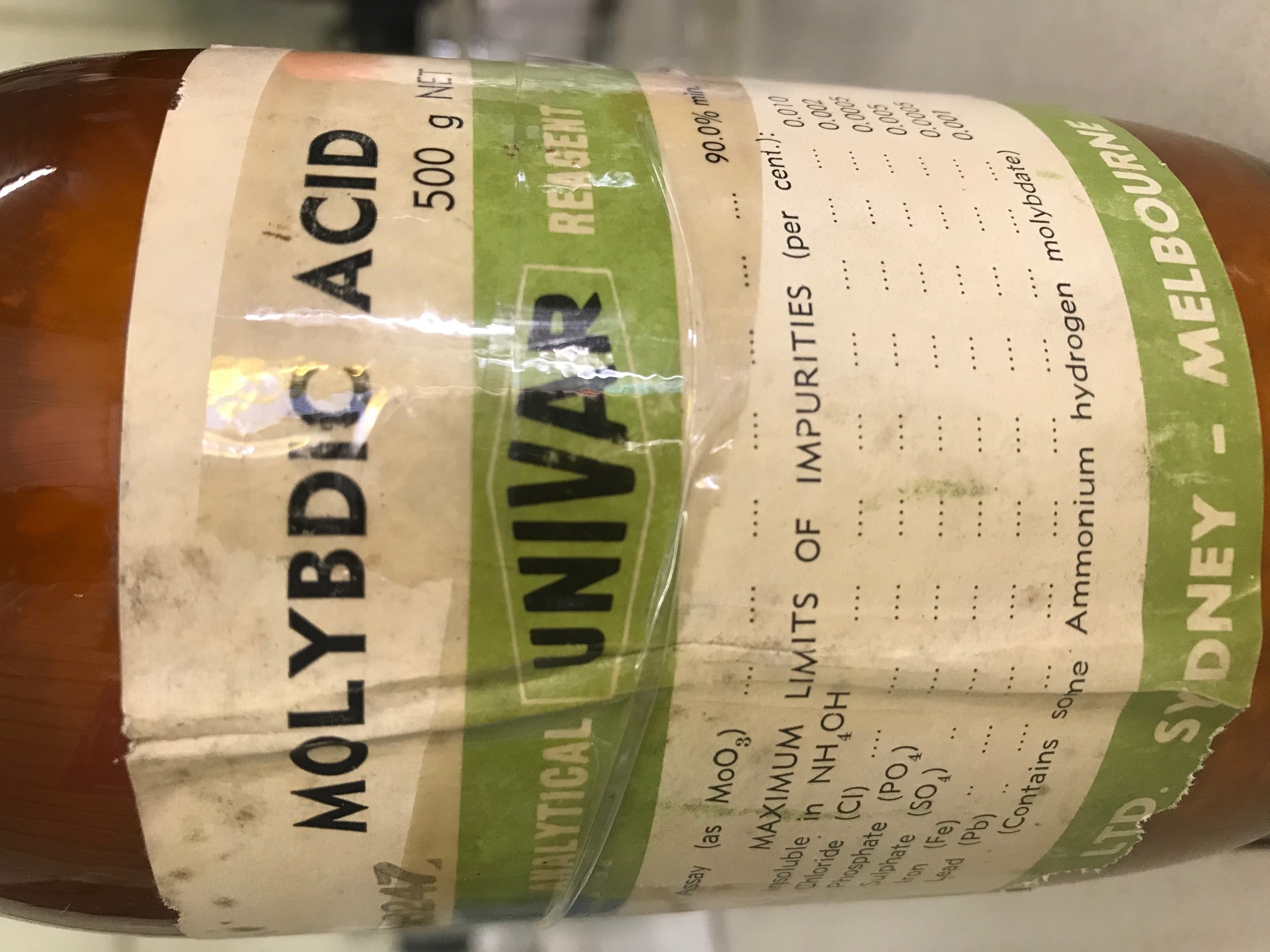

I had a go at cobalt molybdate today but a slightly different route. I have a 500g bottle of "molybdic acid", I think old stock, and wanted to use that. I dissolved some molybdic acid in a sodium hydroxide solution aiming to get 15g of sodium molybdate in solution and then slowly added a solution of cobalt acetate. This gave the ppt pictured below, the color is very similar to the color in Midlifechemist's photo above.
1.jpg - 578kB
The stoichiometry was a bit off, as the filtrate of the final solution (to separate the purple precipitated product) was still too red to my liking, thus it seems not all the cobalt acetate was consumed. When I did the stoichiometry I used MoO3 in the equation because I did not know the molybdic acid hydrate but I forgot to take into account that the assay of MoO3 in the molybdic acid is only 90%. See label below. The label also says "contains ammonium hydrogen molybdate" which explains the ammonia smell each time some molybdic acid was added to the sodium hydroxide solution. Why is the ammonium hydrogen molybdate present? Is it an intermediate when it was made or maybe for stabilizing purposes?
2.jpg - 529kB
To quote from Wikipedia
Ammonium dimolybdate (ADM) is an intermediate in the production of molybdenum compounds from its ores. Roasting typical ore produces crude molybdenum(VI) oxides, which can be extracted into aqueous ammonia, affording ammonium molybdate. Heating solutions of ammonium molybdate gives ADM. Upon heating, solid ammonium dimolybdate decomposes to molybdenum trioxide
Dissolving in ammonia is quite commonly used to extract and purify metal compounds form ores, such as in the case of uranium, with ammonium diuranate.
[Edited on 22-10-2020 by EthidiumBromide]
