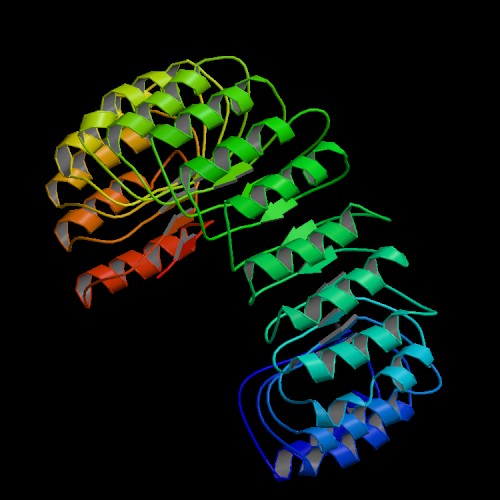

This is one of my favourite structures - the ribonuclease inhibitor (perfect symmetry, and an extremely potent binder of its target molecules, dissociation constants are in the femto-molar (10^-15 M) range!):
http://www.rcsb.org/pdb/cgi/explore.cgi?pid=119501075572516&...
