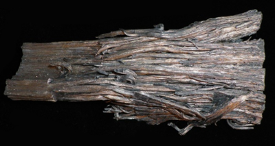

A truly massive 750g chunk of samarium owned by diddi.
