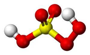

Peroxymonosulfuric acid, also known as persulfuric acid or Caro's acid, a strongly oxidizing acid with the formula H2SO5 first described by Heinrich Caro in 1898. It is prepared by reacting concentrated sulfuric acid (93-98%) with concentrated hydrogen peroxide (30-70% strength).
