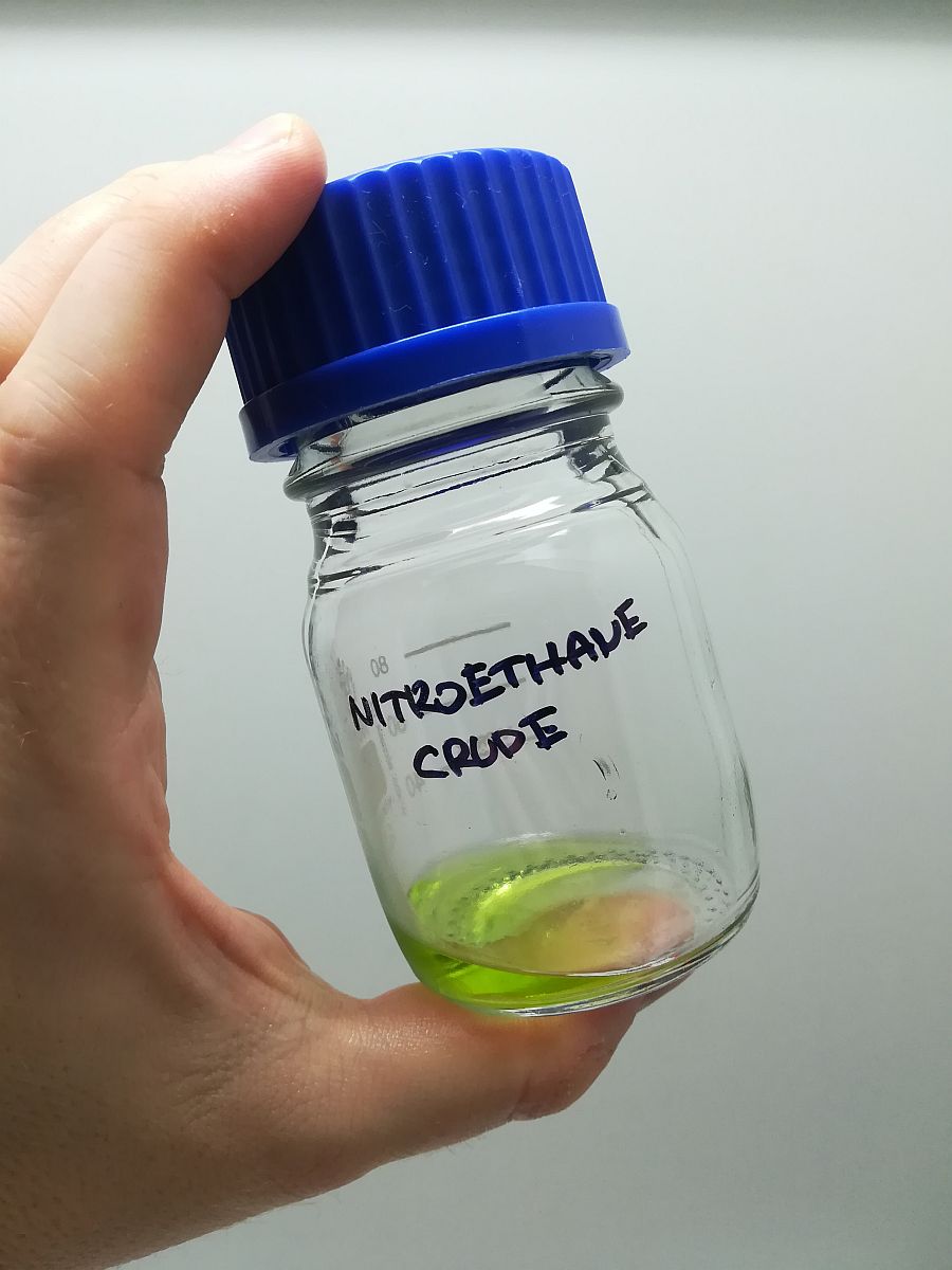

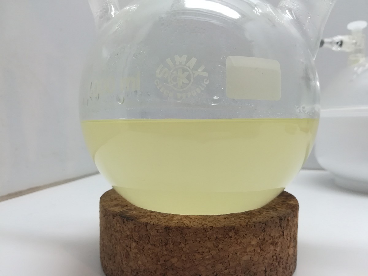

I transferred the remaining impure DMF to a 1L flask for further (vacuum) distillation. It became cloudy and a curious thin layer appeared on top. Now I am completely confused.
I think the DMF was already impure since it was smelly (it should have no smell if pure) and I should have purified it beforehand.
I think I will now distill as much DMF as possible with fractional vacuum distillation and treat the residue with KMnO4 in 3M sulfuric acid to destroy any possible nitrosodimethylamine that could have formed.
The product (nitroethane) is strongly green, which is also very confusing (it should be colorless) but I have not disilled it yet, the amount is too small and I will collect more - it can be contaminated with nitrosodimethylamine too unfortunately.
I think I will use DMSO instead of DMF next time. DMF itself have already too many problems.
