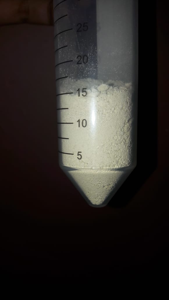

So I decided to synthesize Manganese molybdate using a simple precipitation.
Since Manganese(II)Molybdate is insoluble in water I created saturated solutions of Manganese Chloride and Sodium Molybdate, 40mls each, and mixed the two which formed a very clay like greenish yellow precipitate which soaked up the water aswell. After water washings to remove the soluble stuff and drying in an oven for a while, i collected a very pale green powder. image attached bellow.
This paper i refered to used a reflux method over a long period of time resulting in brown crystals.
https://pubs.acs.org/doi/abs/10.1021/ic00220a035
Firstly, how does refluxing the precipitate in its original mixture produce better results, can it increase crystal size aswell?
Secondly the paper says that alpha phase Manganese Molybdate is brown. while my stuff is very pale green.
they mention a hydrated compound Sodium Manganese Molybdate, If that has formed, what might the mechanism be?
IMG-20180821-WA0005.jpg - 25kB

This is rather interesting. Quite an unusual compound.
Do you have any idea which molybdate ion you have created? There are several. That could easily account for differences in colour.
(And, no. I don't have any bright ideas of ways that you could distinguish between them all.)

Well we have only have the MoO4 ion and according to tbe paper precipitation with varying pH produces Manganese Molybdates with different hydration levels.
