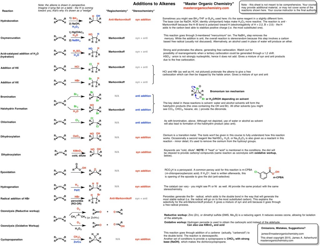

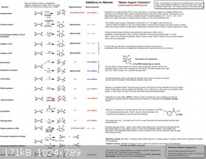

Oh... you can hydrobrominate styrene with hydrogen bromide and react with a strong base to make phenyl ethyl alcohols (one or both depending on reaction conditions)... aqueous bromine will react with styrene to form a bromohydrin that can be reacted with a strong base to make styrene oxide, which is pretty easy to isomerize to phenylacetaldehyde. There are some pretty easy routes to cinnamyl compounds from styrene. And of course, it can be used to make plastics.
Styrene is interesting mainly because it can be used in almost all of these reactions (as well as others):
8-Addition-to-alkenes_2015-1024x789-1.jpg - 171kB
