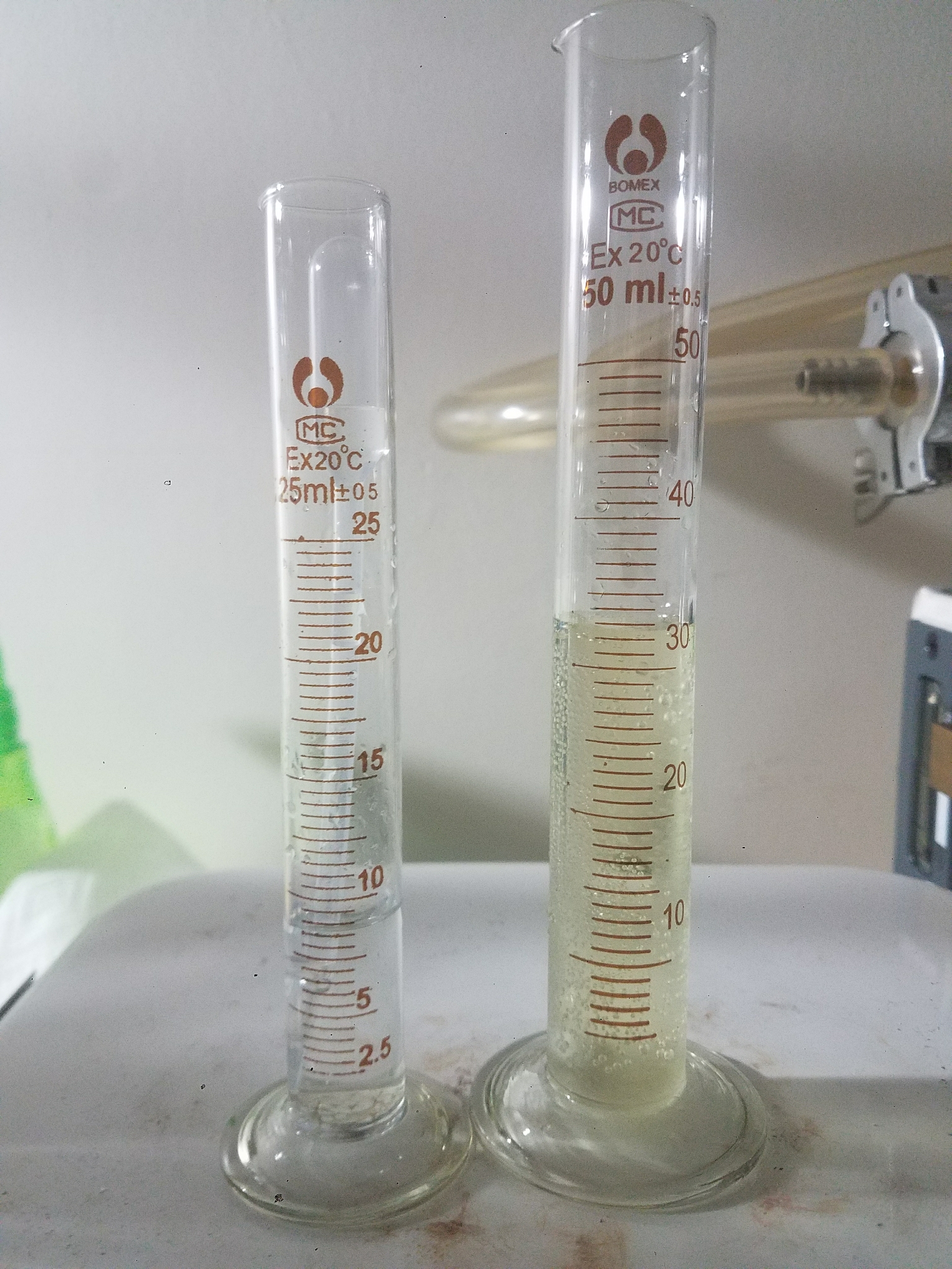

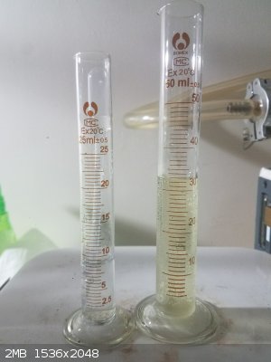

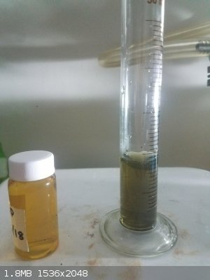

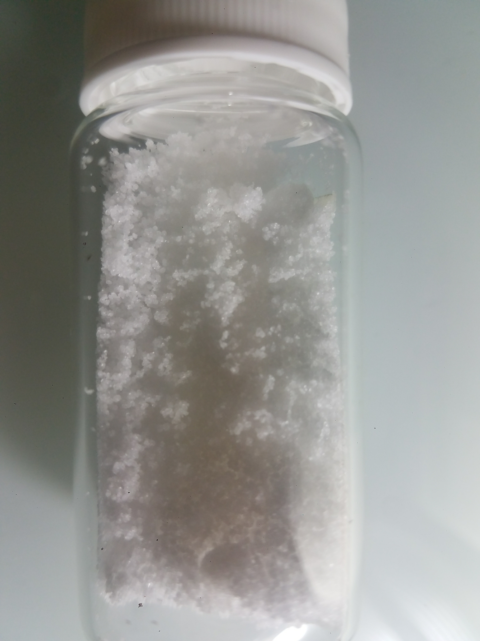

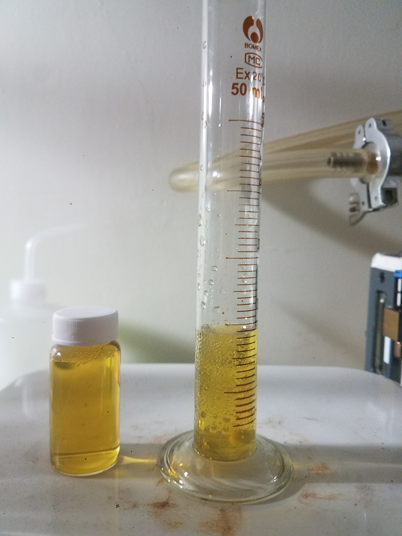

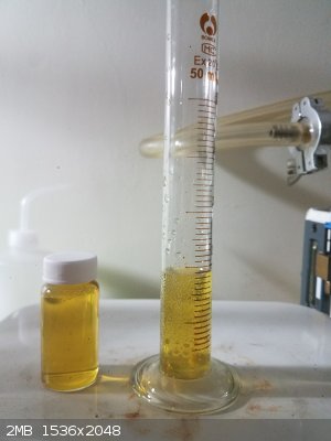

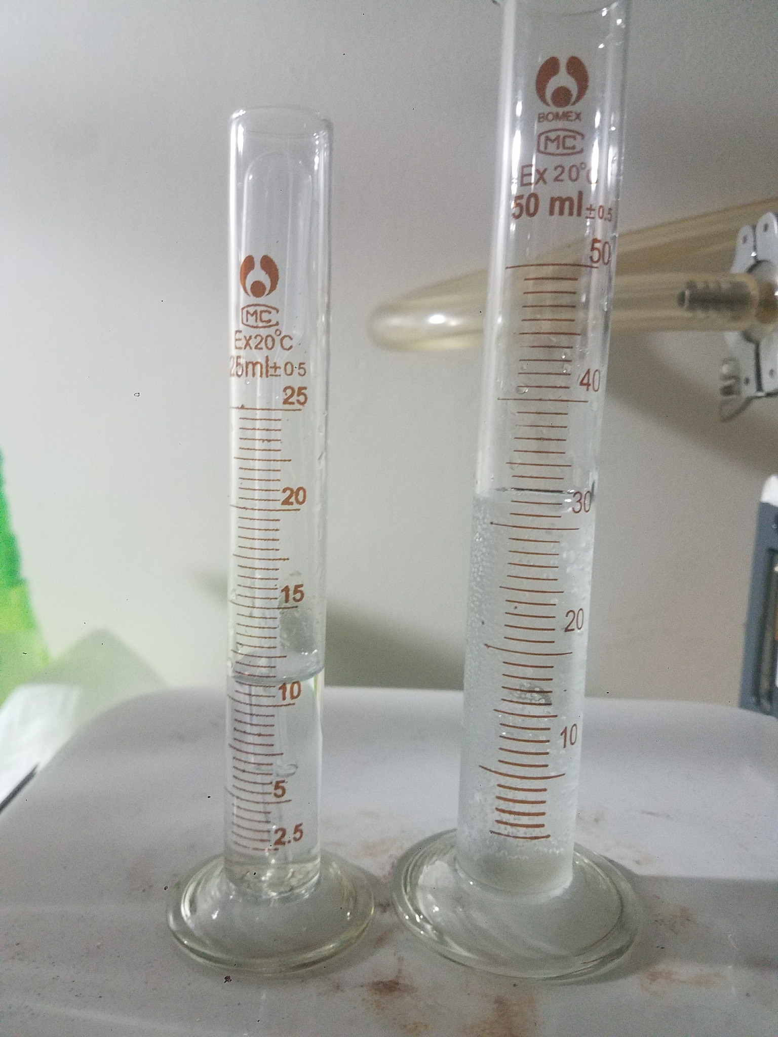

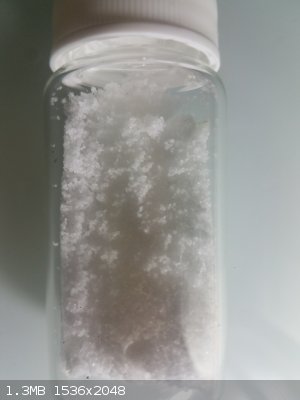

Following their procedure, I give you colloidal silver. I'll type up my lab notes tomorrow, because it's just too darn late. The first photo is not Loptr's packing--I transferred a small amount to a vial for easier use/to avoid degradation of the bulk NaBH4.
The left graduated cylinder is a 1 mM soln. of AgNO3, and the right graduated cylinder is a 2mM soln of NaBH4. The next photo shows the initial addition of ~2mL AgNO3 soln.. The next photo is with the addition completed and stirbar removed.
I transferred 20mL to a vial (this is supposed to be stable at room temperature for months), then returned the stirbar to the reaction cylinder. Continued stirring seems to be producing a color change as per the referenced procedure, but it's hard to tell.
Seems good to me. I'll see how far the color change will go and report back tomorrow.
Thanks Loptr, Tsjerk, and woelen! (I'd like to try your suggestion woelen, but I'll need to make some copper sulfate first.)

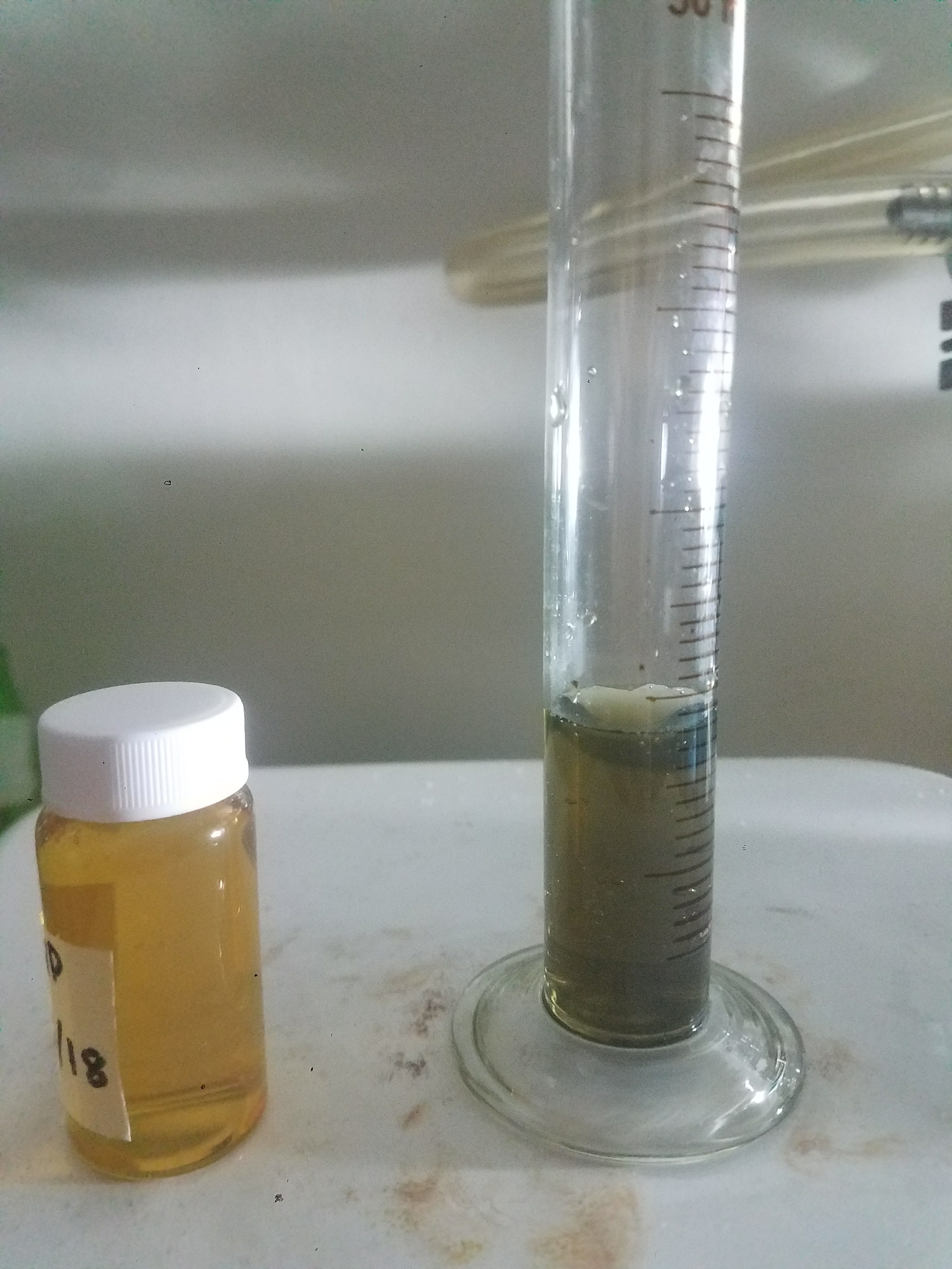

Edit: I suspected that stirring was preventing aggregation, so I stopped it briefly, and got an immediate color change. I'd like to do this one again, but only stirring for a short period after the initial addition to catch the red and violet colorations.

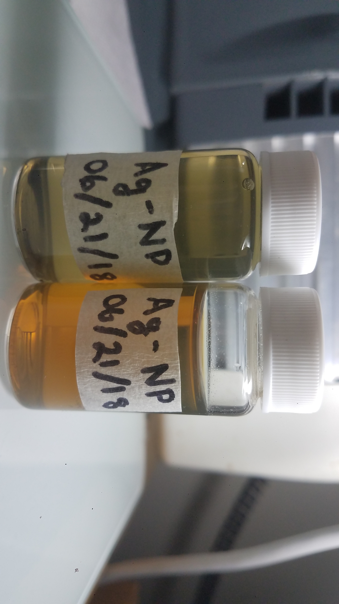

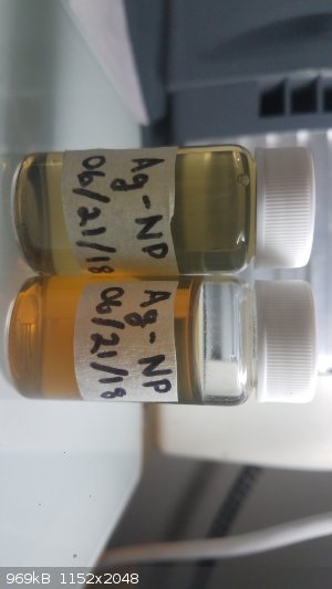

[*] posted on 4-7-2018 at 08:30

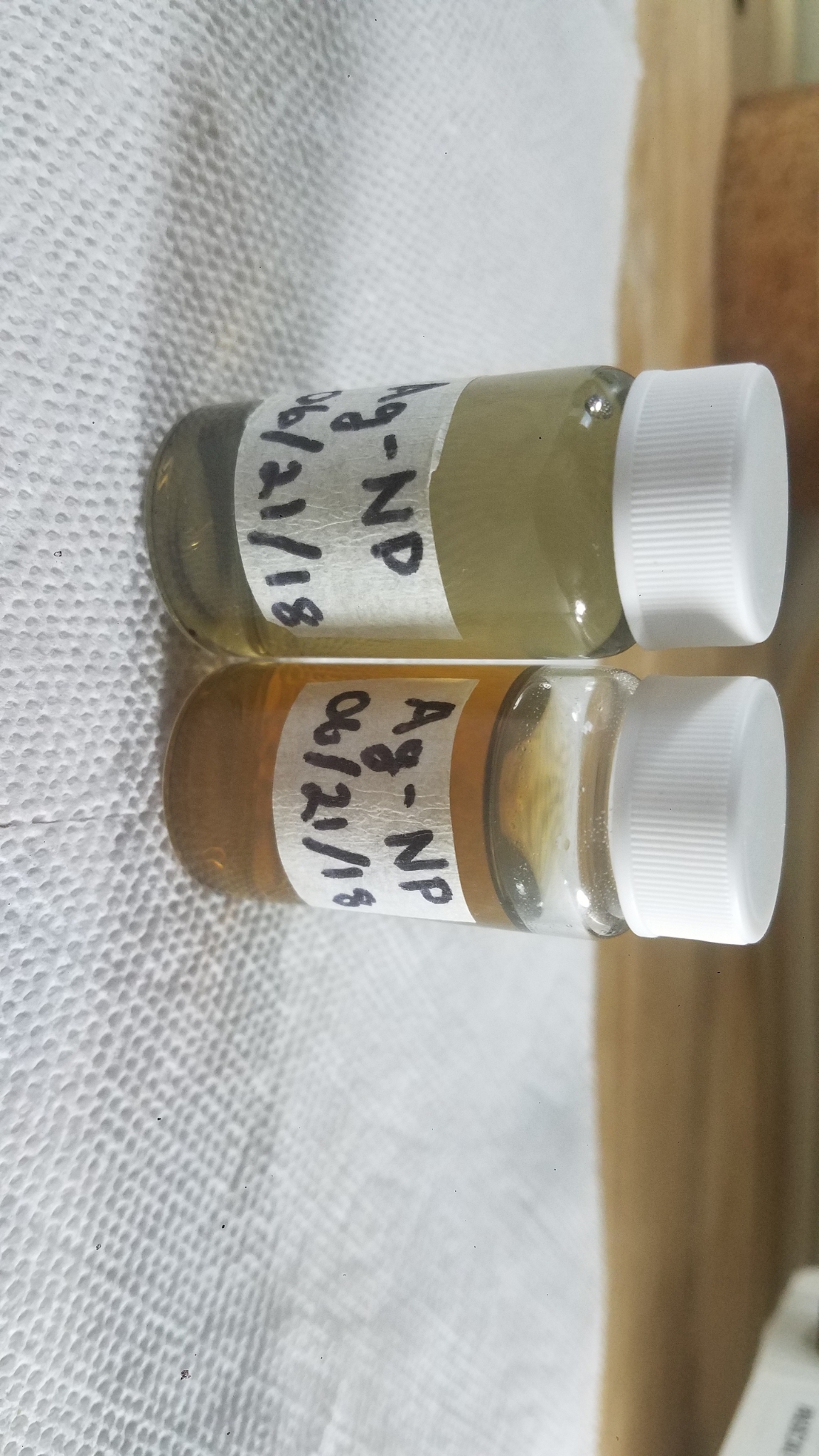

Well, I've been sittting on a curiosity for a couple weeks now, between vacation and work. The paper referenced initially suggested that the mixture stirred for a short period would be more durable as a colloidal suspension. However, I've experienced the exact opposite. The mixture stirred for several hours (less full vial) is retaining the suspension better.
Any thoughts on what's going on?
