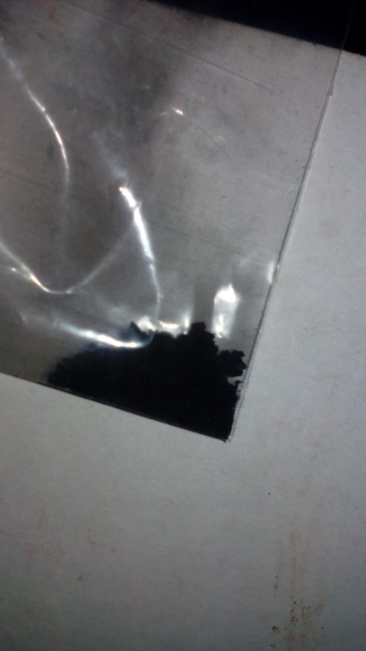

For example, when i add conc. soultion od NaOH to iron solution it became black. After drying the yield looked like FeO.
Later i will upload photos.

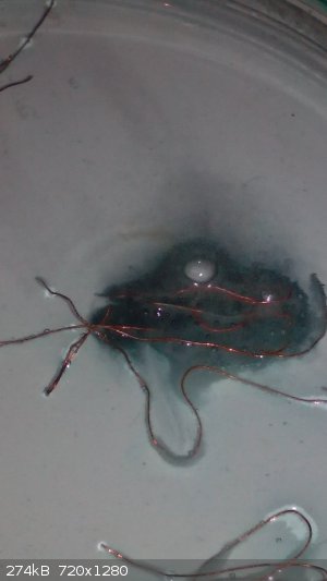

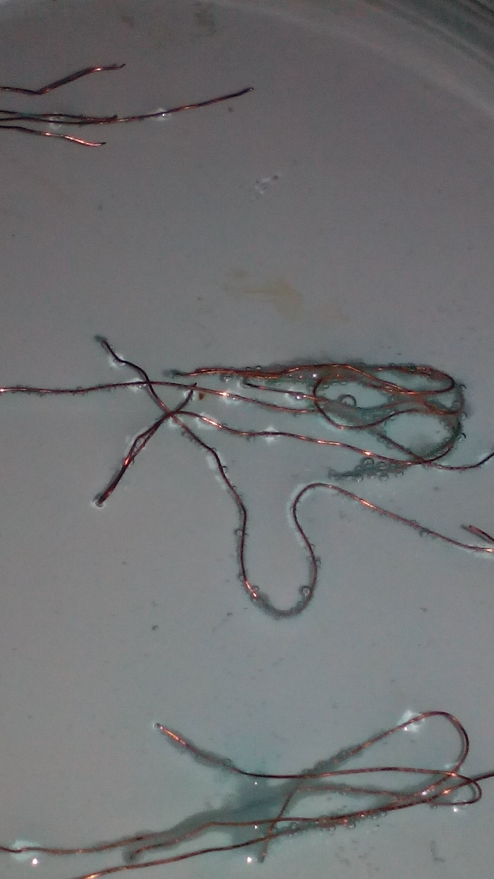

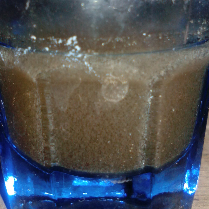

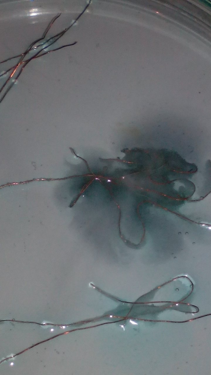

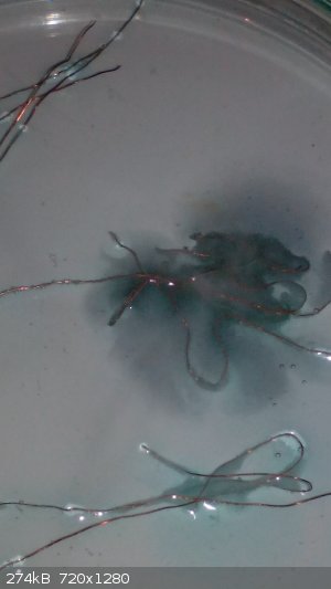

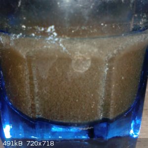

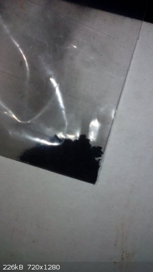

[*] posted on 1-5-2018 at 04:11

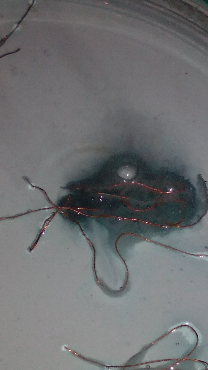

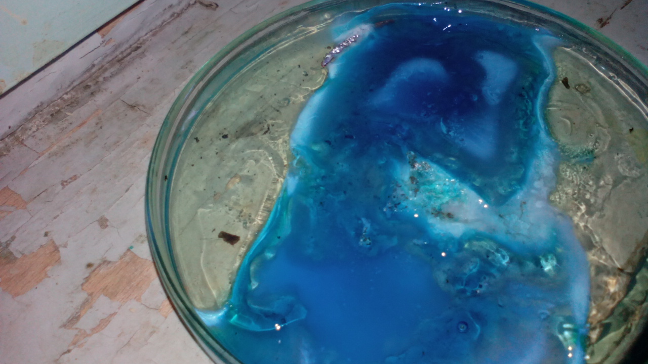

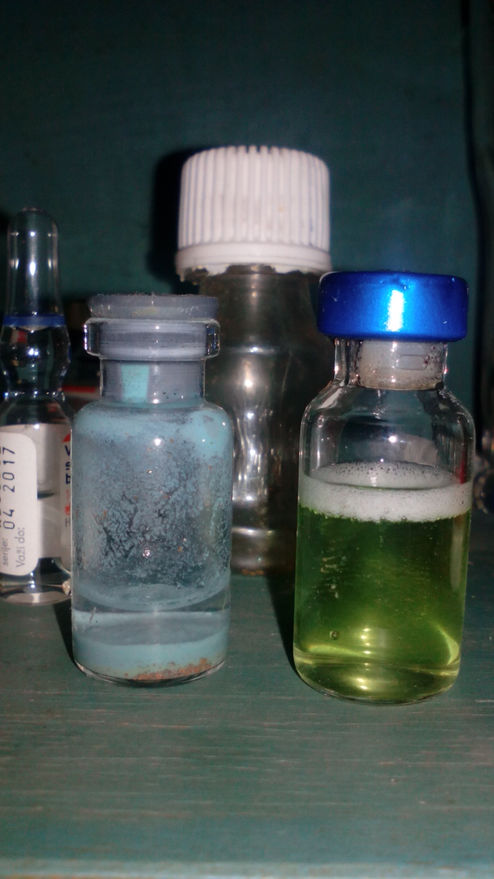

At last i made the photos ;)

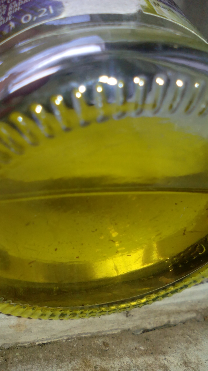

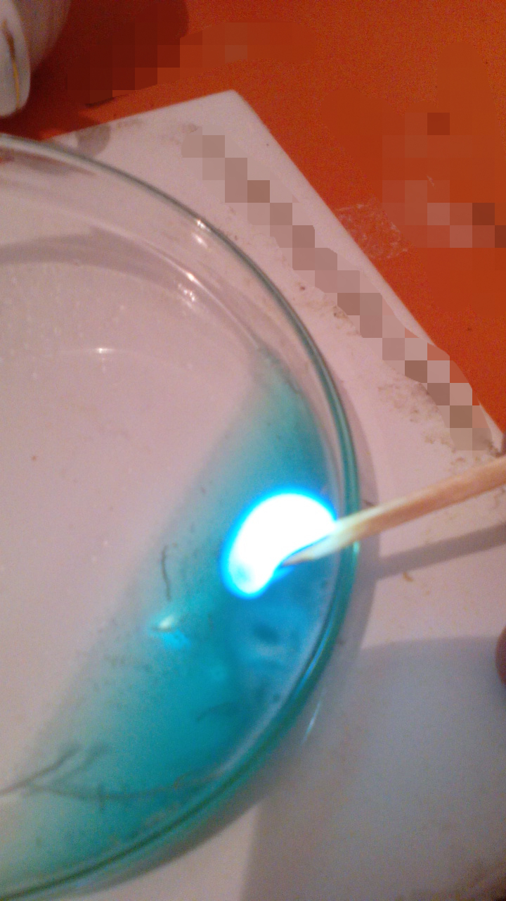

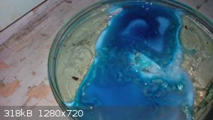

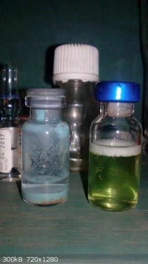

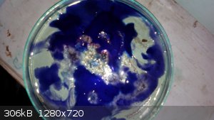

1. The black one is probably FeO, cause in reaction with diluted HCl it turned green and some gas has been produced.
2. You can see the colours of copper and iron solution.
3.The solution in the blue glass should be magnesium chloride (cause you said that ClO- ions are not present in the H2O2+HCl mixture). I was curious about a speed of the reacutions between earth alcali elements and transition ones, and there was a lot H2O2 so i tried to decompose it fast by adding KMnO4 crystal and it looks like big mess now. :)
4. In the right vial is the copper solution with few drops of KMnO4 solution (concentrated), just to decompose H2O2. This one doesnt look like the previous. In the left one is 'something'. I tried to do change ions between copper solution and tin-lead alloy. I looked for tin, but after some time, copper was on the bottom so i thought that reaction is over. Then i add conc. solution of NaOH to gain the hydroxide, but precipitation was yellow (as lead-iodide). None of lead and tin doesnt have that precipitate except iodides. After standing it became blue.
IMG_20180501_133739.jpg - 226kB IMG_20180501_133945.jpg - 406kB IMG_20180501_133917.jpg - 300kB IMG_20180501_134012.jpg - 295kB IMG_201805121_015542.jpg - 491kB
Posts: 8012
[*] posted on 1-5-2018 at 12:20
A yellow precipitate of copper is possible. When copper(II) is reduced to copper(I) in alkaline solution, then you get Cu2O. If this is formed very slowly, then you get nice crystals, which are brick-red. If this is formed more quickly, then you get an orange, or even yellow, precipitate. The solid then is hydrous Cu2O.

[*] posted on 2-5-2018 at 01:55
But that precipitate is unstable i think, cause after some time it become blue, as you can see in the left vial.
And whats about magnesium solution? I mixed 2ml of 30%H2O2 and 2ml of 18% HCl, then i add a piece of Mg. Reaction was pretty slow.
*Why does reaction of that mixture is faster with transition elements than earth alkaline (e.g. Mg)?*
After reaction i tried to get Mg(OH)2 by adding (drop by drop) NaOH solution (diluted). I spent about 10ml, but there wasn't a precipitate. By adding drops a lot of bubbles were came out, like it decompose H2O2. Also bad idea (and 'short' nerves :P) was adding small KMnO4 crystal to the solution.
My question is: Why there wasnt a precipitate? Did i spend a whole NaOH for neutralisation? If yes, what i have neutraised?

[*] posted on 4-5-2018 at 05:05
Hello again,

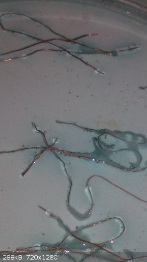

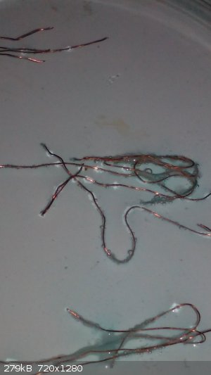

I did an experiment again. Now with P.A. grade of purity.
I used dry and clean Petri dish to make a big area for the reaction (its hard to obeserve it in the beaker or test tube).
Now i mixed 2ml of 16%HCl (p.a.) with 2ml of 30%H2O2. Within a second i felt a little bit of chlorine, but it desapeared very fast. Then i placed three copper wires, very thin and clean. The reaction starts immediately with some tiny bubbles around the wires.
*That was Chlorine or Oxygen in the bubbles?*
The reaction was faster around the middle wire cause it was longer than other ones. In one moment the solution around the wires became dark blue, almost black. ( I think it was just a high concentration of Cu2+ ions around of it), so i stirred the solution and connected all wires. In that moment the reaction became very fast and there was a lot of chlorine.
I also checked for oxygen by stick, but the flame just above the reaction was intense blue and i lost it very soon, so there wasnt an oxygen.
When all of copper was dissolved, the reaction immediately stopped, so i think that copper is react two or three times faster then other reactants. Then i added a big chunk of copper and it started again.
A good way to slow down the reaction is cooling ( i added 5ml of NH4NO3 conc. solution into mixture) or cool it with ice water bath.
*Can we make an equation now?*:D

Posts: 8012
[*] posted on 17-6-2018 at 23:49
The bubbles at the copper wires are oxygen. This is due to catalytic decomposition of H2O2 by the copper species, present around the wire.
Now we can start gving equations:
Copper first is oxidized to copper(II) ions by the H2O2 and acid. The redodx-reaction is accompanied by a coordination reaction.
The simple high-school model equation is oxidation of copper metal to Cu(2+) ions and acid is used up:
Cu + H2O2 + 2H(+) ---> Cu(2+) + 2H2O
A more accurate description is the following:
Cu + H2O2 + 2H(+) + 4Cl(-) ---> CuCl4(2-) + 2H2O
Here you have a redox reaction, combined with formation of the tetrachloro-complex of copper(II). Because of the fairly low concentration of HCl in your mix, you almost certainly also have partial complexes, with a mix of chloride and water ligands.
A nice retry would be to take 30% HCl, add just a little 30% H2O2 and then add copper. Then you will see the green/yellow color of the tetrachloro complex.
Next, the tetrachloro-complex of copper(II) reacts with copper metal as follows:
Cu + CuCl4(2-) ---> 2 CuCl2(-)
Here you have a redox reaction with formation of copper(I), coordinated to chloride. This reaction only occurs in fairly concentrated solutions of chloride ion. Without the stabilizing effect of the dichloro copper(I) complex you would not getr any copper(I) in the mix.
If there is still H2O2 present, then the CuCl2(-) will be oxidized to CuCl4(2-).
Finally, when there is excess copper metal, relative to the H2O2, then both complexes CuCl4(2-) and CuCl2(-) are present besides each other. These complexes form a very dark green/brown, almost black mixed oxidation state complex of not well-established structure. This compound only exists in solution, it is not possible to isolate it. it is believed to be a bridged chloro complex, with copper in oxidation state 1½.
CuCl2(-) + CuCl4(2-) ---> ClCu(μ-Cl)CuCl + 3Cl(-)
This bridged complex is very very dark. it decomposes when the solution is diluted with a lot of water. Snow-white CuCl precipitates in that case and a pale blue solution of copper(II) remains.

Thanks for answering but that equations are opening more questions, like " Why is flame above the mixture blue, if its only oxygen released?" Is the flame of burning stick enough powerful to do an excitation of copper ions? (About 300°C that fire has, i think).
Anyway i am also very into growing crystals in gels, especially dendrimers by using electric current. So after this reaction i took a solution and mixed it with gelatine (70 blooms). After standing there wasnt any crystal even by using 7v battery, so i put a 3ml of 5M Sodium-hydroxide soultion and got blue precipitate immediately. After standing on air precipitate became dark blue, almost dark violete.
IMG_20180408_153238.jpg - 318kB IMG_20180407_172446.jpg - 306kB
