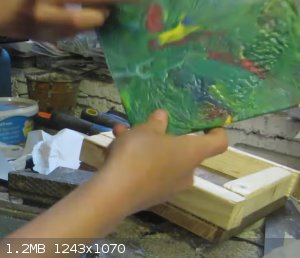

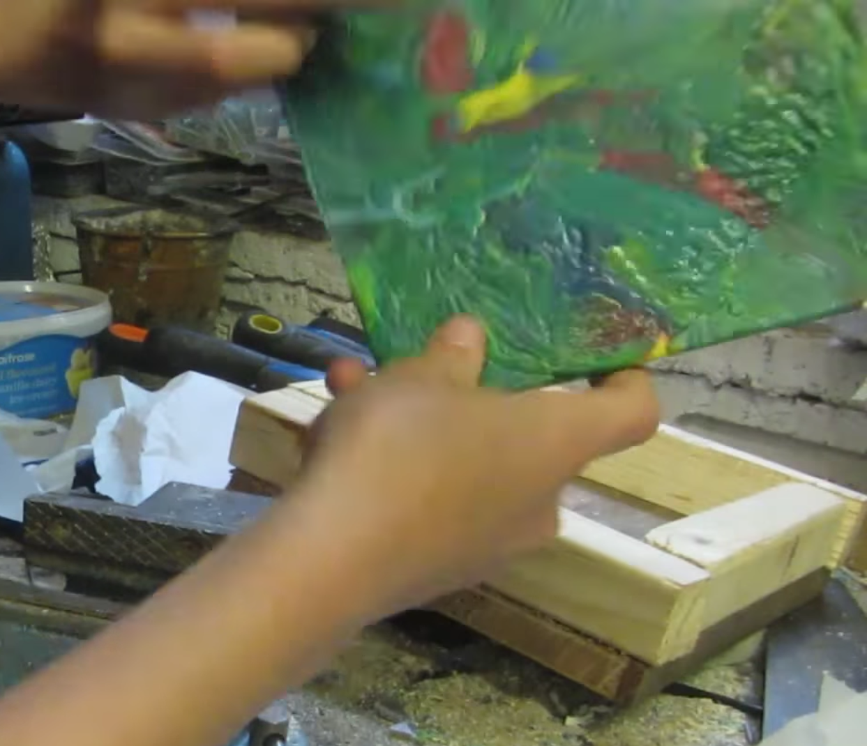

Try HDPE. The ones labeled "2".
![20180213_023617.png - 1.2MB](http://www.sciencemadness.org/talk/files.php?pid=507219&aid=64991)
This kid is compression moulding using vise and clamps in a simple wooden form at around 350 F.
Myself, I would try vacuum pressing- Bag up the mould in one of the compression bags for clothes storage and pull a vacuum to compress.
A plastic bag and your mom's vacuum cleaner can work for a lot of moulding projects
[Edited on 13-2-2018 by Bert]
