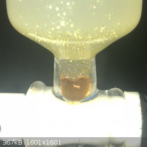

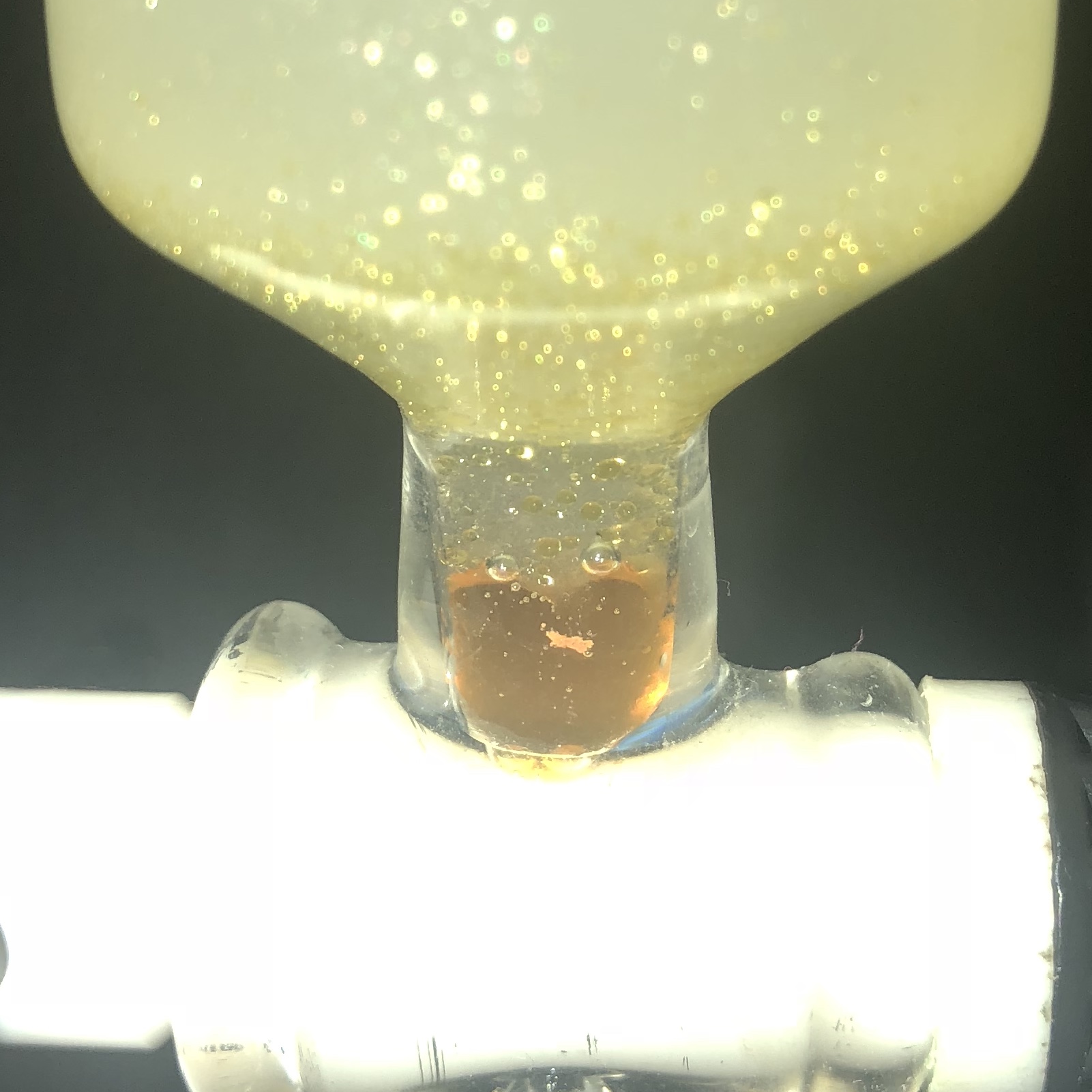

This is a modified Sandmeyer reaction, replacing a halide from HX with OH- from H2O, as the reacting species. Very easy to perform and doesn’t require any special conditions or equipment. This is my first time attempting such a reaction, so it is on a micro scale to avoid any potential hazards from the diazonium intermediate. This also means that work up on the product is highly inaccurate, but it is proven qualitatively.
1. 0.01mol (1.57 +- 0.005g) of phenylethylamine HCl is dissolved in 20mL water, in a beaker.
2. 0.01mol (0.69 +- 0.005g) NaNO2 is poured into a test tube, and dissolved in 10mL water. Alternatively, the PEA HCl and NaNO2 may be combined in a single container and 20-30mL water added; there should be no reaction at this stage. The solutions are intimately mixed.
3. 10mL of dilute H2SO4 is prepared. Since the required amount for me was 0.25cm3, I dissolved 1 +- 0.5mL in 9mL water since an excess is preferable. *Actually, a strong acid is required for the formation of NO+, which is the species that attacks the amine moiety. (H+ + HNO2 <-> H2O + NO+)
4. The acid solution is added slowly, at 2mL per minute. The temperature decrease due to endothermic dissolution of both NaNO2 and PEA HCl means that active cooling isn’t required.
5. After addition of the acid, the mixture is poured into a sep. funnel and two layers are observed.
Observations:
When acidifying the initial mixture, a white opaqueness forms immediately. This is a colloidal suspension of Ph-2-EtOH which is slightly soluble. Cooling it down would help improve yield.
Upon stirring, nitrogen gas is evolved for some period of time as a gentle fizz. The only other gas which could be produced is NO2 from the reaction of the nitrite with acid - lowering the temperature helps prevent this and subsequently increases yield assuming stoichiometric quantities.
Although not as noticeable in the beaker, the alcohol will sink as a separate layer as it is slightly more dense than water. Due to how similar it is (1.017g/mL), you may find a layer forming on top if no stirring is done.
The alcohol is an orange-yellow colour, I suspect that dissolved NO2 is responsible although there may some inherent colouration. Amount produced is too small to conduct a workup. At low concentrations, it has a sweet and floral odour. At high concentrations, the smell is reminiscent of white spirit/naphtha, a general hydrocarbon odour.

Since posting, the amount of alcohol settled in the bottom has approximately doubled, coming up to the bottom of the flare in the funnel. Letting it sit helps to draw the alcohol out of suspension.
A significant byproduct of this reaction would be phenylethyl-2-nitrite, formed via the reaction of nitrous acid with the alcohol in question. However, the decreased solubility of the alcohol should limit its formation, and being an unstable ester, I expect that it will eventually decompose to the alcohol - how long will this take? I’m not sure, I estimate a couple of weeks but with the presence of acid, likely less.
I’m currently in the process of a 5x scale reaction, and have collected a few mL of orange, insoluble liquid. It is still bubbling slightly, the evolution of gas (N2? NO2?) is clear and not the result of trapped air. There is a layer of water sitting on top which has taken up some of the alcohol, a clear decrease in volume noted; this will hopefully remove some impurities and thus colour since the first batch was heading in that direction. Will finish this off and calculate final yield range on Monday, either the crude product or, hopefully, pure-ish.

I suspect what you have here is not very pure. The alkyldiazonium intermediate is very unstable, and I expect carbocation rearrangements or eliminations to 1-phenethanol, styrene, or various ethylphenols to be a significant side product.

I didn’t think so either, from what I’ve managed to find it’s supposed to be a colourless liquid with a rose like odour but instead it is very petrochemical and quite pungent. I did think there’d be small amounts of styrene and diphenylethyl ether since I used sulphuric acid as opposed to HCl. Not entirely sure where the colour came from though, if not NO2 (seems to be too intense) then I’d hazard a guess at some sort of azo coupling product since phenols and anilines are used for this purpose.
I managed to keep the temperature below 40C and only small amounts of acid were present at a time, plus the solutions were all quite dilute as you can see from my numbers - plenty of water around to react with the diazonium ions before anything else can get in the way. The product(s) are currently sitting in a loosely stoppered test tube so I’ll see how things change in a few days, also got the ‘paused’ mixture in the sep. funnel (I conducted the scale-up in there to minimise mechanical loss, quite a bit from the first run stuck to the beaker) so I can compare the two, before and after a water wash.

The nitrosation of phenethylamine in water and the analysis of products formed is described in (on the last page):
180. The decomposition of the nitrites of some primary aliphatic amines
Donald W. Adamson and J. Kenner
J. Chem. Soc., 1934,0, 838-844. DOI: 10.1039/JR9340000838
Phenethyl alcohol is the main product. Some styrene, di(phenethyl)amine, N-nitroso-di(phenethyl)amine and residual phenethylamine were also among the product. Surprisingly, no hydride shift occurs, as indicated by the absence of 1-phenylethanol (or at least the authors failed to find it among the product with the methodology and means they had at that time).

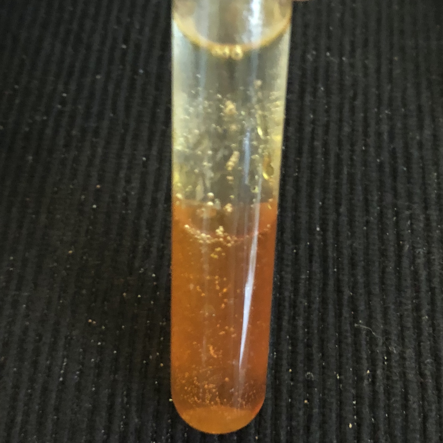

@Cryolite Zinc, now that’s something I do have a small amount of. Will see what happens when some is added to the crude product, if I understand correctly then it should give off nitrogen gas and leave an amine, right?

I would expect reducing a nitrosamine to give the corresponding hydrazine in alkaline solutions and the amine in acid solutions. Either one should be good enough-- both diphenethylamine and 1,1-diphenethylhydrazine are soluble in hydrochloric acid while the desired product is not. From the paper Nicodem posted, this means the only significant products left are phenethyl alcohol and styrene which can be separated by distillation.

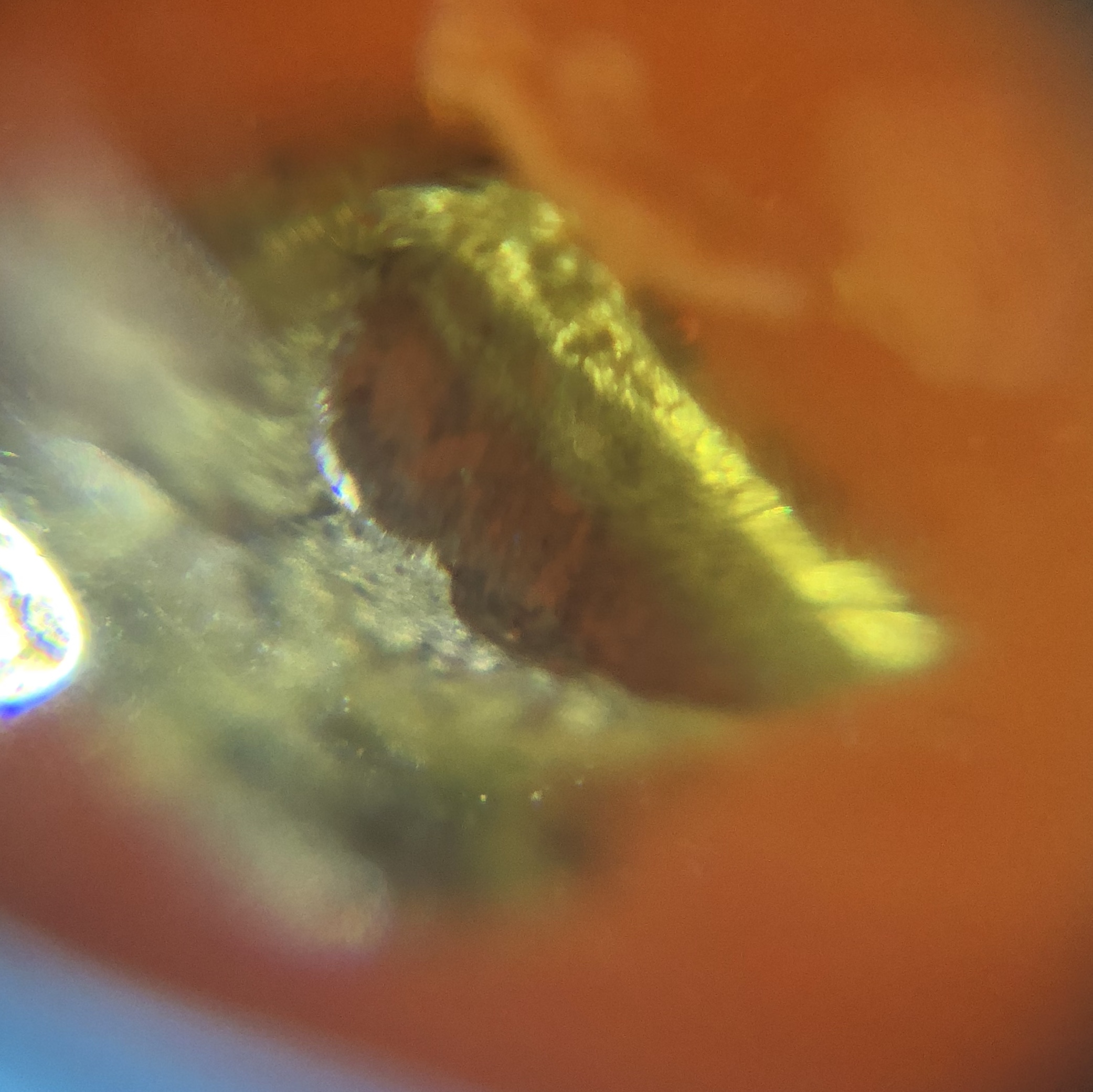

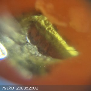

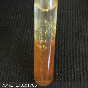

Okay, just dropped in a small lump of zinc metal, filing it into a powder would’ve been too time consuming. Bubbles are being generated and the zinc has taken on a greenish tinge, just have to wait until the former has stopped then the amines can be extracted out.
