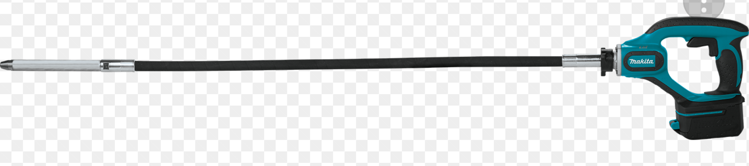

Construction workers often use a vibrator for getting air bubbles out of freshly poured concrete foundations... something similar would be useful in
getting rid of bubbles in volumetric flasks and bubbles in plaster casts... has anyone seen a cheap version of something like that?

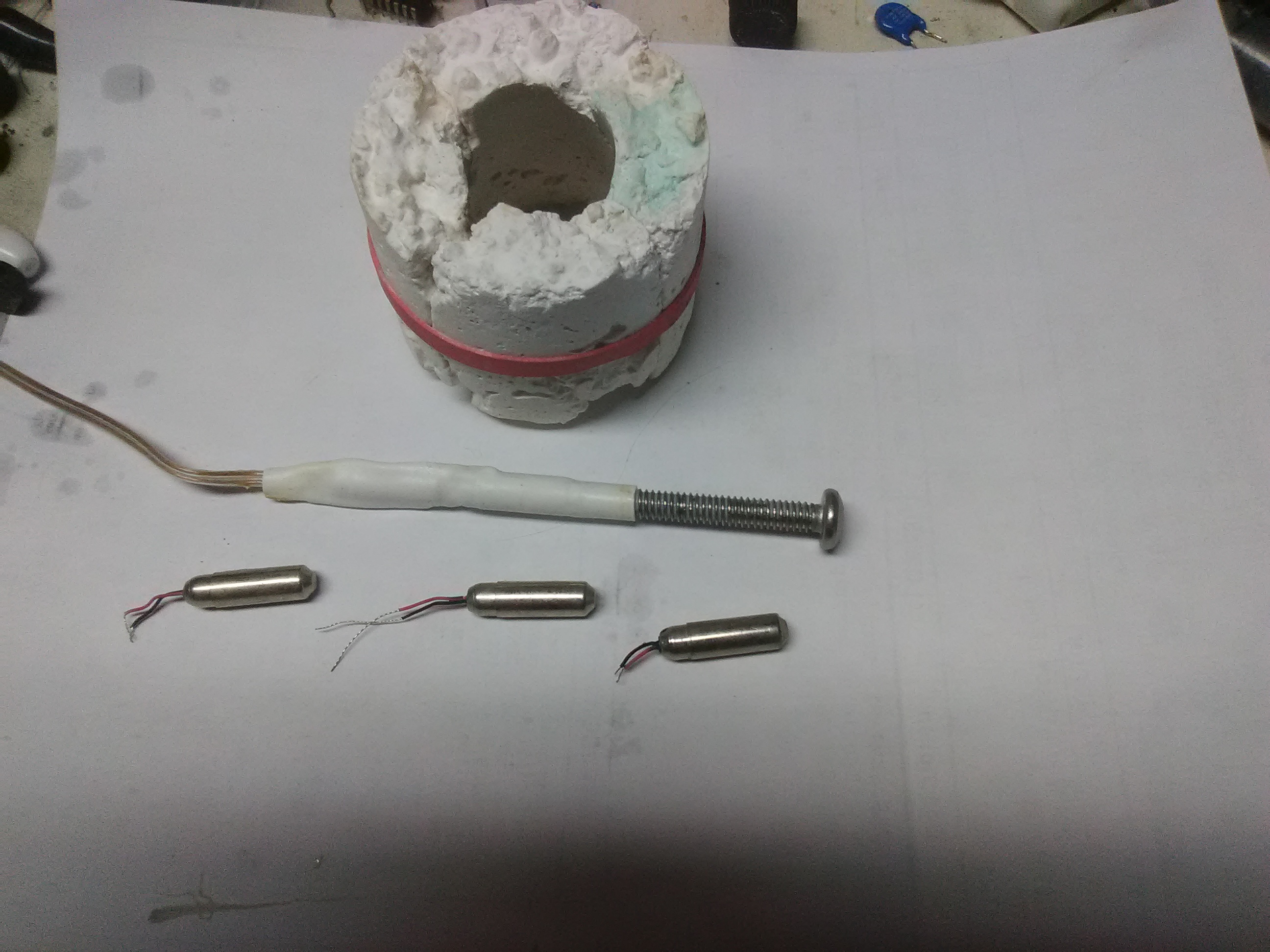

Sweet! I'll have to look them up. But I'd appreciate a link ... because another "doc johnson" makes sex toys.... !
I've attempted to make a buzzer the last two days, but I have doubts it will be powerful enough to be effective. It's definitely not very high
frequency.
I bought a bunch of cell telephone vibrators and have been trying to make a buzzer to remove bubbles. I epoxied two vibrators together and extended
them with a bolt and heat shrink tubing after soldering the wires in series. They run at 2.5V or less, so it takes two of them to withstand a 5V USB
wall plug adapter.
I haven't tested it yet ... but it's the best I could figure out how to do on my own.
In the background of the picture is a plaster of paris + pearlite insulator jacket I made for a 50mL Erlenmeyer flask. This is the jacket I made
before I thought about vibrators. In the foreground are the waterproof cell-phone vibrators and the heat shrunk pair of vibrators that I bought last
week.
To make the jacket, my son used a coke-can as an outside mold after hammering the bottom of the pop can flat. He then put the Erlenmeyer flask inside
(obviously, he didn't get it exactly centered) and we poured a plaster pearlite mix into the can up to the neck of the flask. I don't think I'd
hammer the bottom flat again, though ... but pour something in there that makes a level surface. The can shape is warped at the bottom and getting
rid of that would be easier to do by pre-filling it with something. The can was pretty easy to peel off after scoring it with a razor blade once the
plaster was set.
You can see the air bubble areas on the surface of the plaster. They;re generally along the outside rim near the bottom. There is only one void
going through the plaster. I broke the finished jacket apart to check how far the voids penetrate. That's why there's a rubber band keeping the
pieces together. But a vibrator would have definitely made a better casting.
