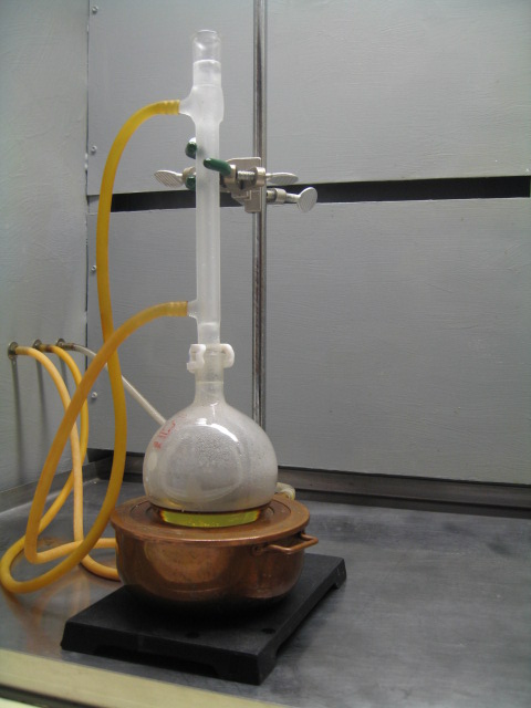

I have prepared o-toluidine with 22.7g of o-nitrotoluene using Vogel’s (3rd ed) “Method A” for aniline, at 0.82 scale. Adjustments were made for the differing molecular weights of the respective precursors, nitrobenzene and nitrotoluene. Method A utilizes tin/HCl as reducing agent.
The reaction was conducted in a 500mL RBF. I had to reflux the reactants for the full 60 minutes before the almond-like smell of o-nitrotoluene had all but disappeared. This was replaced with the mild naphthalenic smell of o-toluidine.
reflux for reduction of o-nitrotoluene.jpg - 75kB
reactants at reflux

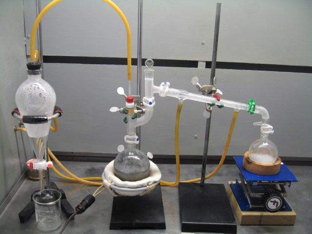

After basification the product mix was subjected to steam distillation. About 200mL of milky white emulsion came over. I continued collecting clear condensate for another 100mL as recommended by Vogel due to the high solubility of the o-toluidine in water. My pot residue consisted of stannous/stannic hydroxides that didn’t dissolve.
steam distillation of o-toluidine.jpg - 90kB

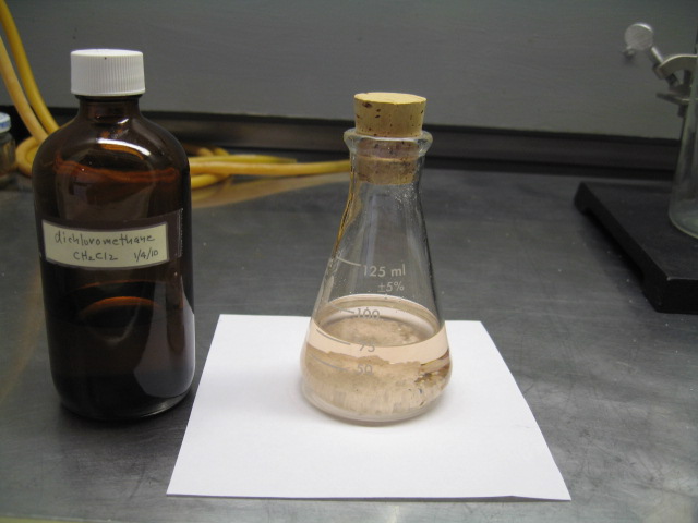

I substituted DCM for ether to extract the o-toluidine from the steam distillate using 2 x 35 mL. The extract is shown here being dried over potassium carbonate:
drying o-toluidine extract in DCM over K2CO3 (2).jpg - 73kB
DCM extract of steam distillate, drying

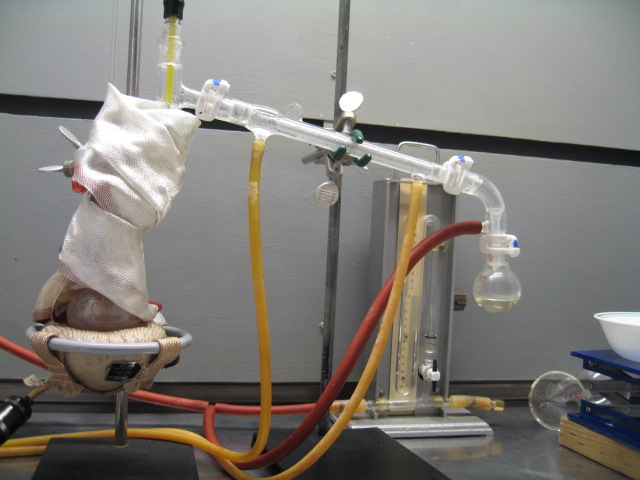

The dried extract was distilled to remove the DCM using simple distillation. The crude o-toluidine in the pot residue was then purified by vacuum distillation at 1-2mmHg absolute pressure, as shown below. The distillate temperature at this pressure was 52-55°C which is consistent with o-toluidine’s normal boiling point of 200°C.
vacuum distillation of o-toluidine.jpg - 91kB
vacuum distillation of crude o-toluidine
