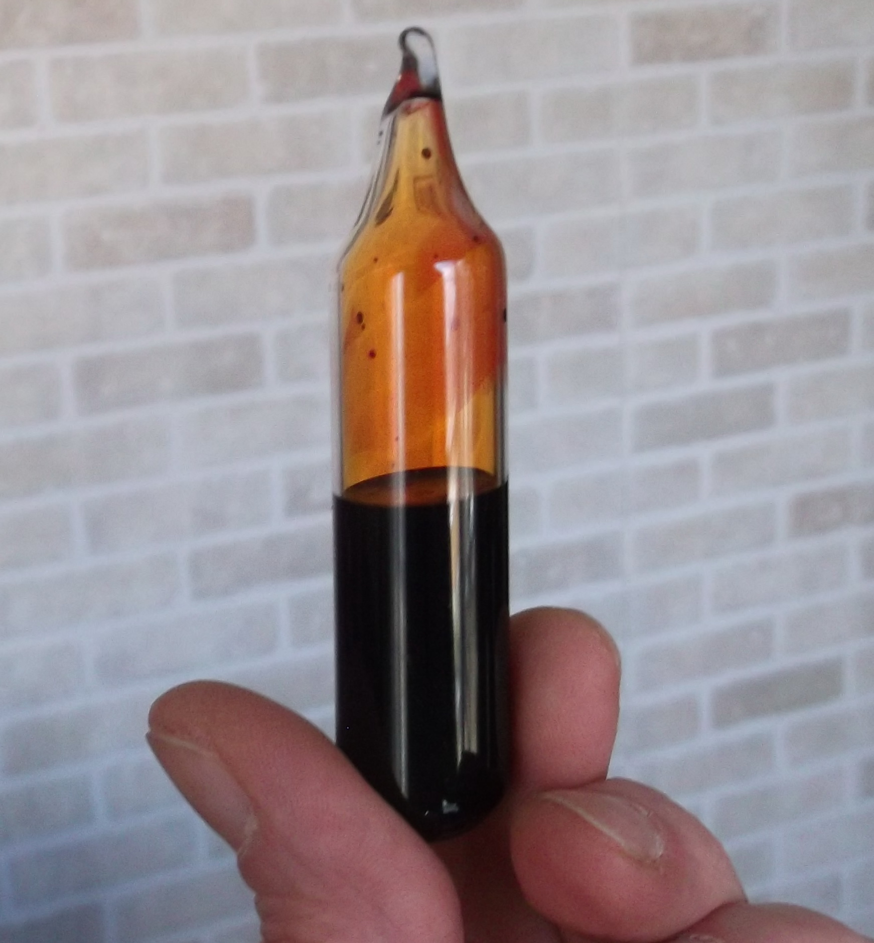

I also use the permanganate, NaBr & Sulfuric acid route. I maintain the reaction vessel considerable above the boiling point of Br2 by controlling the rate of acid addition to a soln. of KBr and KMnO4 in hot water. No external heat is needed. The Br2 and some water seems to come over. I wash the Br2 with H2O and dry over anhydrous NaBr. Distillation gives quite a nice product. I think I made ~900 g of distilled product in two runs in a 2 L RB. The cost was about $50.
