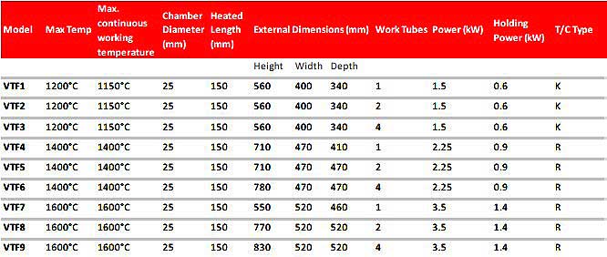

Tube furnace typical holding power
Below is a table of power ratings for Vecstar tube furnaces.
It gives the inner dimensions, the outer dimensions, max temperature and the holding power for that temperature. I thought it would be a useful guide to the required power.
From the dimensions the insulation thickness can be determined and it can be assumed a fiber insulation is used.
furnace-power.jpg - 38kB
