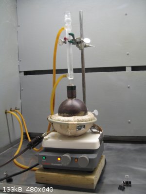

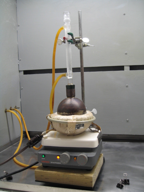

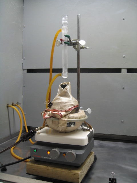

a. Reaction at Reflux.
A 500mL copper RBF was used as a reaction vessel. An egg-shaped magnet stir bar was added. This vessel was set up with a 19/22 reflux condenser
(20cm) using a tin foil covered bored cork (note 1) as adapter.

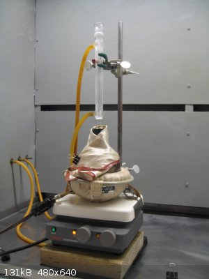

Synthesis of hydrazine hydrate – unlagged
![synthesis of hydrazine hydrate.jpg - 131kB](http://www.sciencemadness.org/talk/files.php?pid=458444&aid=52658)
The hydrazine sulfate and NaOH were added to the RBF in that order. The 50 mL of water was then added in 10 mL portions through the condenser over a
period of 5 minutes. This generated a great deal of heat and a small amount of hydrazine was seen escaping the top of the condenser. The hood fan
was on, of course, as hydrazine is highly toxic. The reactants were then heated at reflux for 1.5 hours using a mantle. The reactants were stirred
with a magnetic stirrer throughout the reaction.

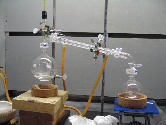

b. Distillation
The condenser was then set for downward distillation. The distillate temperature rose as high as 133°C then dropped off. Heating was stopped at
this point and the condensate left overnight in the 250mL receiving flask.
c. Azeotropic Distillation
The distillate was then transferred to a 500mL RBF and 179mL of xylene was added along with an egg-shaped stir bar. The stirred biphasic mixture was
distilled until 250mL of water/xylene was collected. Final condensate temperature was 102°C.

An electric mantle was used instead of the free flame prescribed by Vogel. This seemed to work well.

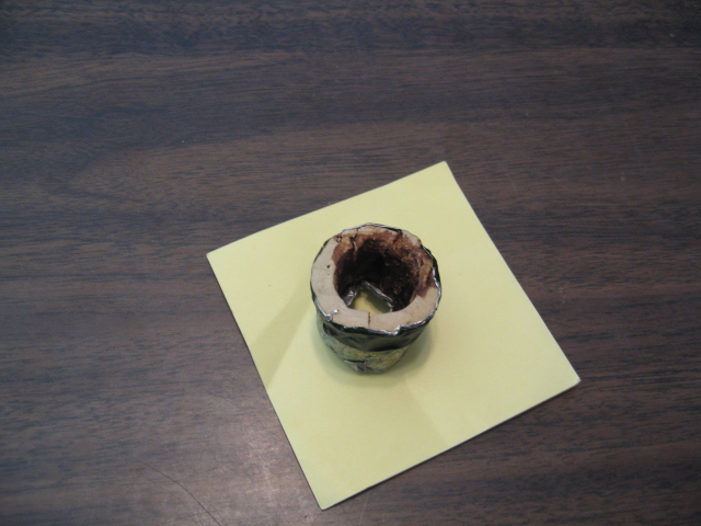

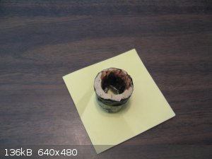

The tin foil cork adapter was somewhat deteriorated on the inside surface. This was not covered with tin foil. A bored EPDM rubber stopper might
work just as well or better.
