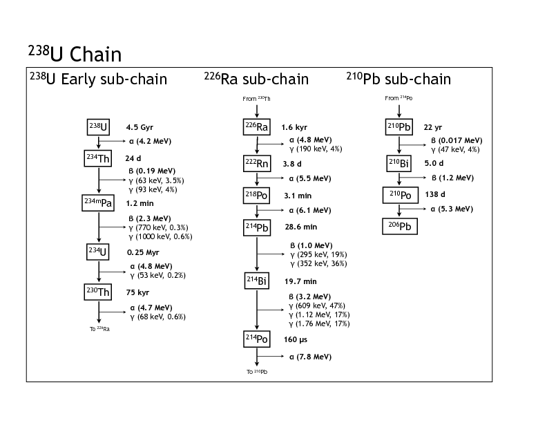

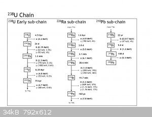

Could you please describe a safe, effective and responsible amateur scheme for storage and handling of lab wastes and radioactive residues? Also your thoughts on a home experimenter concentrating or releasing other radioactive substances found in natural Uranium ore. The ones Mmme. Currie occasionaly walked around with in her lab coat pocket, you know?
Extra points if the amateur handling scheme for nuclear materials and radioactive waste meets the letter of USA legal requirements, rather than being judged to be all right by yourself as "too small scale to matter".
Believe me, I am all too familiar with the variance possible between being sensible/safe and being legal.
Fig01_U238_decay_chain.png - 34kB
