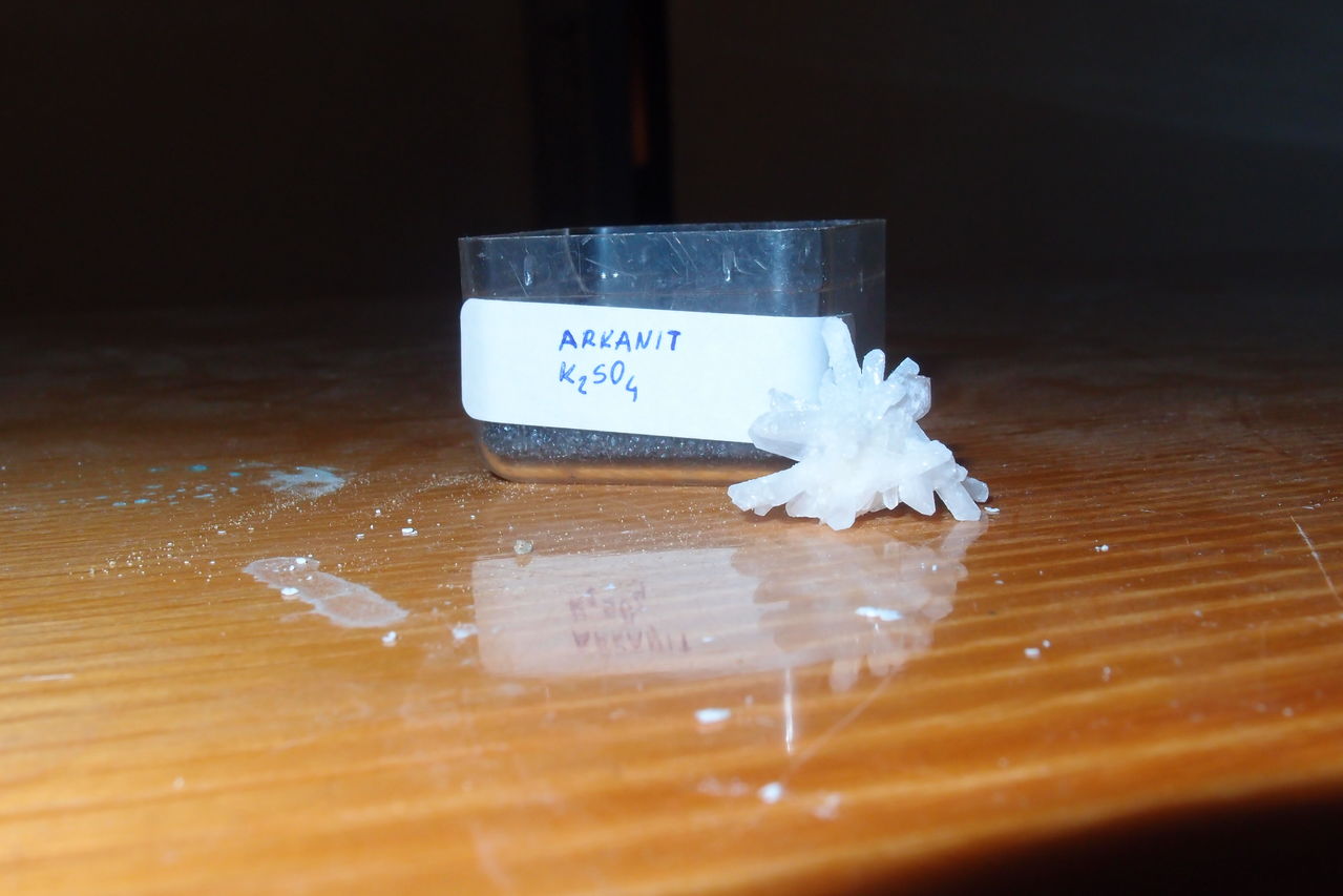

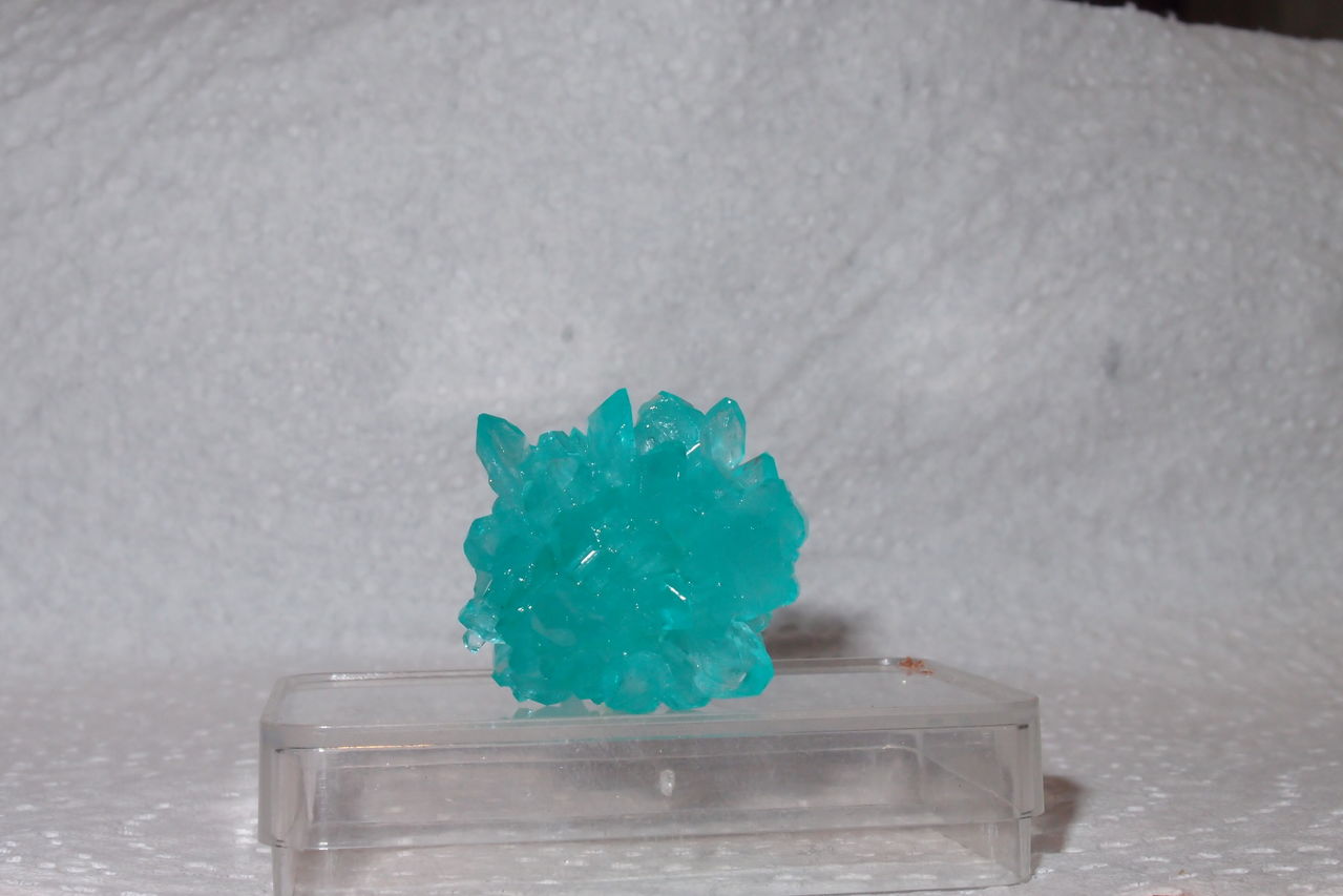

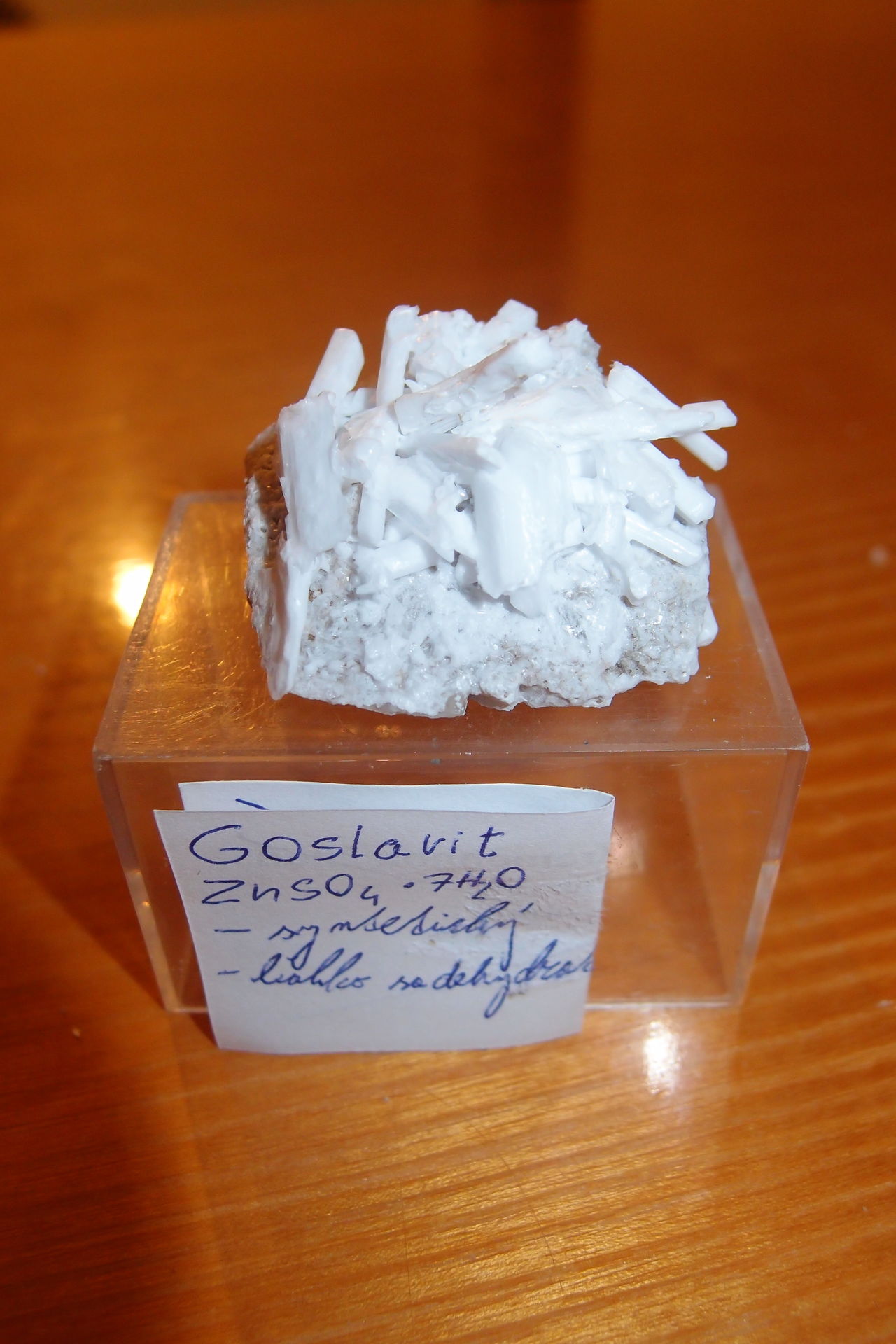

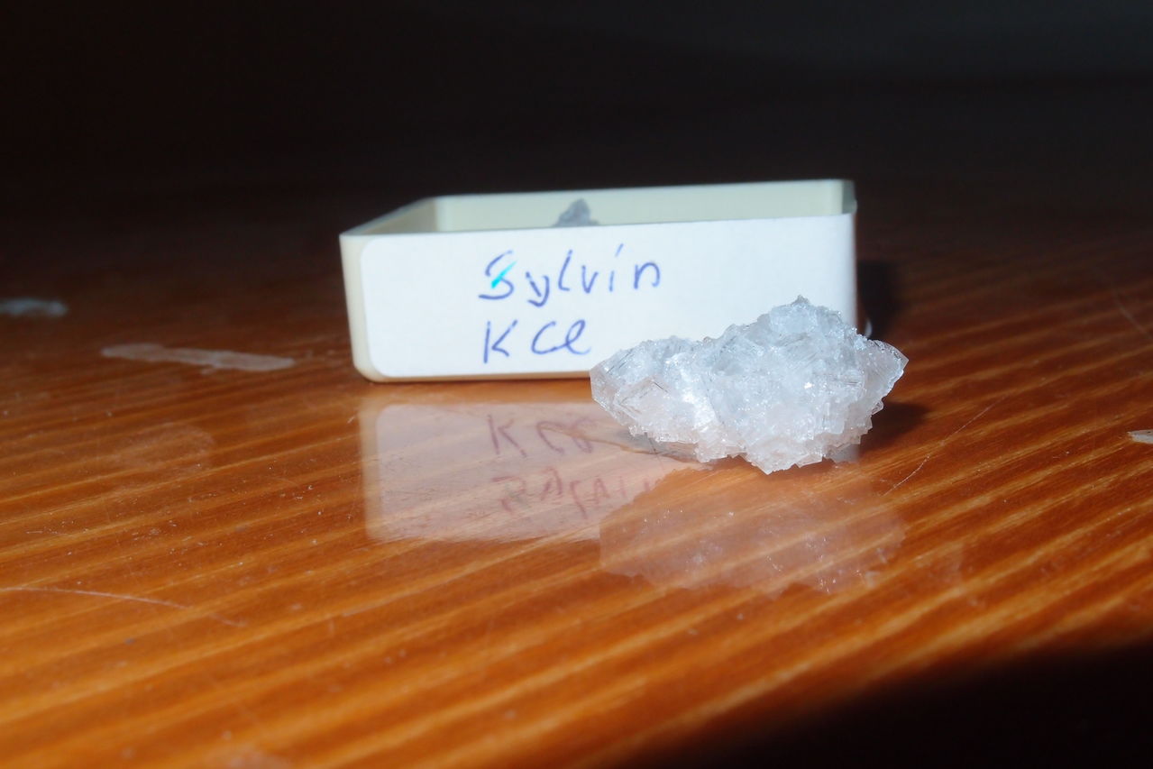

My Crystals:
1) Iron(II) Sulfate heptahydrate (FeSO4.(7H2O))
2) Copper(II) sulfate pentahydrate (CuSO4.(5H2O))
3) Zinc Sulfate Heptahydrate (ZnSO4.(7H2O)
4) Sodium bicarbonate (NaHCO3)
5) Ammonium chloride (NH4Cl)
6) Sodium Chloride (NaCl)
NOTE: this one isnt manmade its rock Salt to be Exact.
7) Potassium Chloride (KCl)
8) Potassium sulfate (K2SO4)
9) Sodium tetraborate decahydrate or simply Borax (Na2B4O7·10H2O)
10) Diamond (I´m not joking it´s real diamond from grinding wheel under microscope )
11) Bismuth (Bi)
-my favourite
12) Tin (Sn)
That´s not all of course I will add more pics later and I want to ask anyone interested for help.
