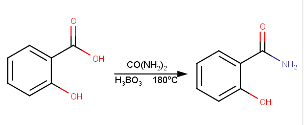

This procedure begins with the synthesis of salicylamide from salicylic acid (1).
Mmjcsa1.png - 11kB

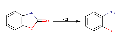

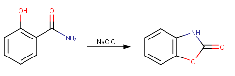

Following this, a Hofmann rearrangement reaction is performed to create 4,5-benzoxazolone, which is hydrolyzed with dilute HCl(aq) to 2-aminophenol.
C1n42ap.png - 6kB
FpL6GTi.png - 6kB
Preparation of Salicylamide:
10.5g salicylic acid is combined with 13.6g of carbamide and 0.8g of boric acid, to act as a catalyst, in a 125mL Erlenmeyer flask. The Erlenmeyer flask is connected to a water trap. The melt is heated to 180°C for 2 hours using a sand bath. 50ml water and 5ml 10% aqueous ammonia added. Solution boiled for 5 minutes. Solution chilled and 25ml 10M HCl(aq) added. Salicylamide filtered off.
The final product was a white crystalline powder with mass of 3.2g, representing a 31% yield. On future trials, 40mL of 10M HCl(aq) was used, increasing the yield to 89%. The melting point of the powder was found to be 141°C (lit. 140-144°C) using the melting point apparatus from source 5. This product forms a purple complex with FeCl3, but it is not nearly as intense as the complex formed with Salicylic acid. This indicates that the product is contaminated with Salicylic acid, which is to be expected.

Is this better characterization of the salicylamide intermediate?
"The final product was a white crystalline powder with mass of 3.2g, representing a 30.6% yield. The melting point of the powder was found to be 141C (lit. 140-144C) (5)."
I would do a TLC, but I do not currently have the resources to do so. Is there any other kind of characterization information I should include before going ahead with the Hofmann rearrangement? If not, I will correct the later half of the procedure and perform the reaction soon.

[*] posted on 22-8-2015 at 02:30
nlegaux
It is better, but it is not optimal. For example, it gives no indication of purity as there is no range given and no description on how the measurement was done. It makes a difference if it was just some roughly made measurement with a thermometer in a test tube or if it was done using a Thiele method or a microscope.
But why don't you do a chemical characterization as well? For example, a FeCl3 tests comparison between the starting material and the product would cost you nothing, but would give valuable information. Or whichever other test (like solubility test for ethanol, water, aqueous NaHCO3, NaOH, HCl...).

Regarding the hoffman degradationn, are you using one related to the one described here:
Process for the preparation of benzoxazolone, Patent CA 1150276 A1
http://www.google.com/patents/CA1150276A1?cl=en
Yields mentioned are up to 96% and the reaction can be performed at ambient temperature. It mentions that when kept well basified and the hypochlorite is added slowly, ring chlorination is almost absent. Difficulty is probably determining the hypochlorite concentration, as the patent roughly uses equimolar quantitites of hypochlorite and salicylamide. Too little, salicylamide will be present (same MP and roughly same solubilities), use of excess unknown.
In the patent, any presence of residual hypochlorite is destroyed before HCl is added, which is presumably important to prevent ring chlorinated by products. Ascorbic acid may be an even more OTC option for this. Looks doable, though purification and identification looks difficult.

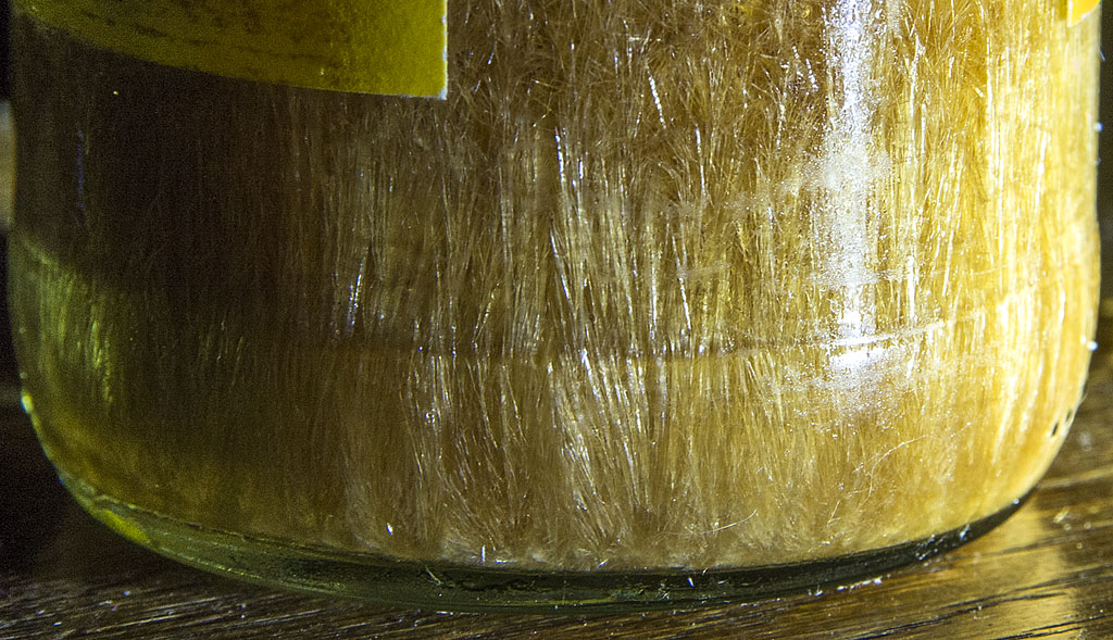

[*] posted on 31-8-2015 at 00:10
Great find for this synthesis route, it works in high yield, even with household bleach. :) The plan was to add the bleach slowly to the basified salicylamide solution, but I kind of panicked when I smelled something that resembled green corn, just added all of the remaining bleach at once and left the reaction. Chlorine can produce a lot of nasty smells though so I'm probably panicking, but did you smell the same thing?
Benzoxazolone a - Copy.jpg - 238kBBenzoxazolone b - Copy.jpg - 344kB

Nice find on the patent nitro-genes! It offered a lot of insight. I have been isolating the benzoxazolone intermediate instead of the 2-aminophenol product with the procedure I am currently attempting. In the near future I will attempt the hydrolysis with a stronger acid. Probably sulfuric acid, as you suggested.
The first few times I attempted the reaction without cooling I also noticed an unusual smell. I have found that this smell is not present when an ice bath is utilized.

I attempted the acid hydrolysis yesterday. I added 3ml 96% H2SO4 to 0.5g benzoxazolone and refluxed for 30 minutes. Unfortunately, I don't know the effectiveness of this hydrolysis, because I broke my thermometer, and my new one doesn't come in the mail until the end of this week :mad:.
I read up on benzoxazolone hydrolysis a bit, and perhaps a base hydrolysis would be more suitable? This patent describes the hydrolysis of a benzoxazolone derivative with NaOH. https://www.google.com/patents/US2979503

I have found hydrolysis with dilute (1M) HCl(aq) for around an hour with reflux to be a successful way to hydrolyze the product.

I've been following this synthesis and I just finished making the benzoxazolone intermediate.
It seems there are a few concerns about phosgene formation during the hydrolysis of benzoxazolone to 2-aminophenol using Hydrochloric acid.
How dangerous is this really? Are dangerous amounts of phosgene likely to be produced?
I was planning on performing the hydrolysis soon.
reality is an illusion :D
UC235
Posts: 565
Registered: 28-12-2014
[*] posted on 16-5-2016 at 10:34
0% chance in aqueous solution.
