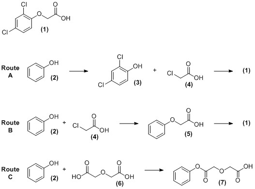

I may be misunderstanding what you're suggesting, but I think you're confusing a few issues in your suggestion to use diglycolic acid. Let me illustrate... I've left out details of the reagents for simplicity.
In the figure below, compound (1) is the target, 2,4-dichlorophenoxyacetic acid. You have found two routes by which it can be prepared - chlorination of phenol (2), followed by alkylation of the dichlorophenol (3) with chloroacetic acid (4) (route A); or alkylation of phenol with chloroacetic acid, followed by chlorination of the resulting phenoxyacetic acid (5) (route B). Both of these would get you to the desired product.
Now, as for the diglycolic acid (6) method (route C). Firstly, diglycolic acid is an ether, and is thus quite unreactive. Certainly it will not alkylate a phenol under any reasonable conditions. The best you could hope for would be to acylate the phenol, analagous to the reaction used to synthesise aspirin (although, again, this would require some other reagent to activate the diglycolic acid), and would give you the entirely unwanted product (7).
Pumukli's suggestion to search for a commercial product from which you can extract it is a good one; another alternative would be to simply purchase phenoxyacetic acid - if you have a source from which you could obtain chloroacetic acid, then phenoxyacetic acid should be likewise available (and a lot cheaper).
