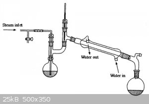

Purification of benzaldehyde?
I've been given a small amount of benzaldehyde and have been having trouble distilling it, possibly due to my crappy aspirator. Seems that when I try to vac distil it it refuses to come over and then once the oil bath hits around 150C it starts turning darker until i'm left with a black tar in my flask that still refuses to come over even if the bath is taken up to 180C.
Since for the moment I don't have the spare money to drop on a cheap rotary vane pump setup, I was wondering if I could get away with just steam distilling it? What I am thinking is strip off the low boiling fraction under vacuum then switch to a steam setup similar to the image attached. Once all of the oil has crossed over, drain off the oil using a sep funnel then salt out the water to free what is dissolved in it, followed by drying the benzaldehyde over MgSO4 - Would this work?
I'll be using a 500ml E-Flask for the steam generator, which i'm thinking is rather small for say 150ml - 200ml of benzaldehyde but it's the biggest I currently have, I also plan on using a propane burner to super heat the steam just before it enters the RB flask which will be sitting in either a water or oil bath at about 80C, can anyone see any problems with this?

byko3y: Not sure where you get your info but at 100torr it should be boiling at around 101C, the melting point for benzaldehyde is -57C, a difference of 158C but yes, at 200torr (which my aspirator is capable of) it should be coming over at around 125C, the problem is that it won't :( . I will get an occasional bump but that's it. If anyone has any insight as to why this is happening it would be greatly appreciated. I was using mag stirring w/ the flask 3/4 submerged in an oil bath.
Thanks for the link Magpie! I have attempted internal steam distillation before but it was a very slow process, I was hoping that maybe generating the steam externally would speed the process up a bit?
