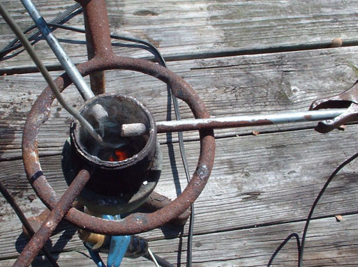

I tried to electrolyze some CaCl2 'drying agent' in a steel crucible connected to the (-) so it acts as the cathode and a carbon rod connected to the (+).
I used a 200 amp (set to 100 amp) DC welder as power supply. I started arcing to start the initial melt to get it conductive. Finally I saw a red hot liquid bubbling, sometimes it arced underwater ('water' which is actually liquid CaCl2) due to the louder bubbling with the sound of a submerged arc.
Sometimes I saw orange blinks which are actually Ca metal which then immediately burned again.
I smelled a swimming pool smell, but I don't think considerable amounts of Cl2 gas are generated.
Here the video (I held the camera in my hand while my other hand was holding the anode.

BromicAcid : you are right, this is indeed a raw test, for really isolating Ca metal more is needed. But why is the current too much ? For the small size of the cell ?
Indeed a kind of a 'Downs cell' is needed and some fluxing to lower the mp. Pure CaCl2 melts at 772 C and I guessed by the color that the temperature is not far above it. I forgot my infrared pyrometer to check.

Yes, I think the current is too much for such a small cell. I did electrolysis of LiCl/KCl eucetic in a similarly sized cell with a 10A power supply and even that was too much, as material was reduced at the cathode, the metal formed would help to short out the cell as it approached the side walls. For a cell that size it's just overkill. Of course I don't know what your current draw actually was, just what your supply was, if you only had the very tip of the electrode touching your current would be much lower, right? But really, your crucible was tiny, at 100A and 100% efficiency (of course neither happened in reality) you would be making 12.5g of calcium metal every 10 minutes, likely consuming all the electrolyte in that container.

No, I don't think Len had his book out at that time. It was just a proof of concept (looking very similar to the opening post of this thread), you can see the glow in the picture from the lithium metal shorting out the cell which is one of my worries with high current in such a small cell.
dscf0024.jpg - 88kB
[*] posted on 18-5-2015 at 16:10
What were the electrodes and crucible used?

[*] posted on 18-5-2015 at 16:13
Cathode was nickel, anode was just the crucible (mild steel).
[*] posted on 18-5-2015 at 16:17

Well, I did another try (proof of concept) and set the welder to 25A. I did not notich much difference but less shortings, more current through the salt bath instead of shorting arcs. On the edge lots of yellow sparks appeard but the color was more sodium like yellow, which means that some NaCl is in the solution, which does not surprise me as it is just commercial drying agent.
According to the color I guessed the temperature about 800C slightly above the mp of CaCl2 of 772C.
BTW I did this outdoors due to the Cl2 stench.
Now I try to find ways to isolate the Ca metal which is not easy as it floats on top of the solution. The only way is not to use the crucible as cathode but a steel cylinder closed on top as cathode, completely immersed in the solution. After cooling and when the salt is frozen I have to dig out the cylinder and to break out the Ca metal under the salt, as removing the cathode when the salt is still liquid, the still hot Ca metal will be exposed to the air which burns immediately.
The clip again (refreshed tonight): http://www.metallab.net/jwplayer/video.php?f=/clips/CaCl2-el...

My only try at calcium was an utter failure. I think the reason I couldn't get my CaCl2 molten was down to a large amount of oxide or carbonate in the drying chips, but it might just be that a Bunsen and a metal container couldn't reach the temperature. I've since read about adding hydrochloric acid to the CaCl2 and heating to fusion to get a good melt. You'd need a good draught for the fumes but then you do anyway.
One key to this seems to be getting the cell absolutely right for the current available and cooling the cathode enough to use a window between the melting point of the chloride and the metal to pull a stick of metal (covered with a little chloride) out of the molten chloride as it forms. This probably needs a lot of planning and experimentation as normally the cathode will be the hottest part of the cell.
