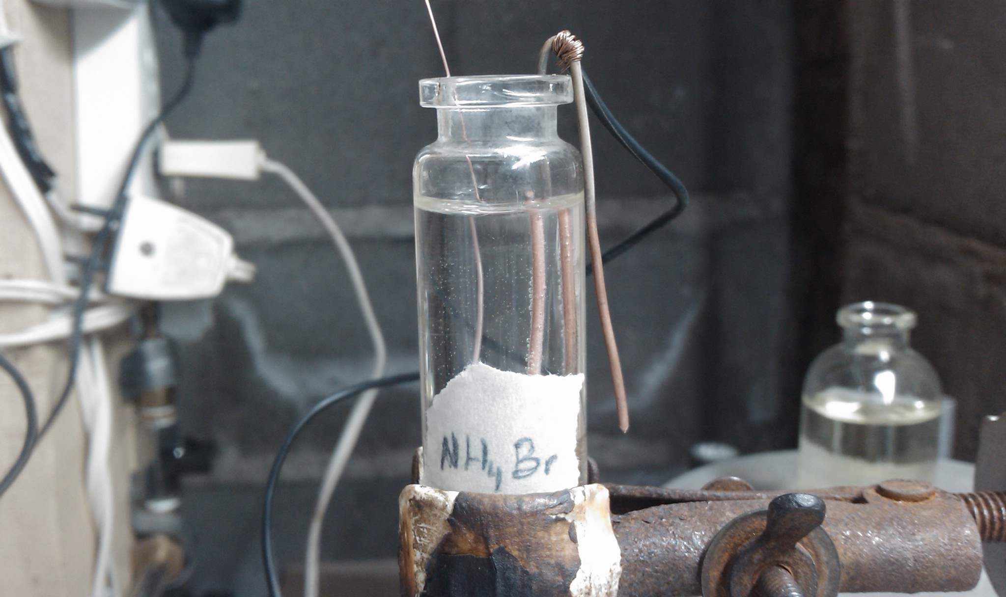

3) (The pictures were taken with these method)
Copper/Cuprous bromide in ammonium bromide. I know that the PH of the reference solution has to be in a pH closer to 7 as possible, but you get the idea. These had lecture very constant, and also last longer than the other ones. One problem was the cuprous bromide in the copper wire used to fall apart.

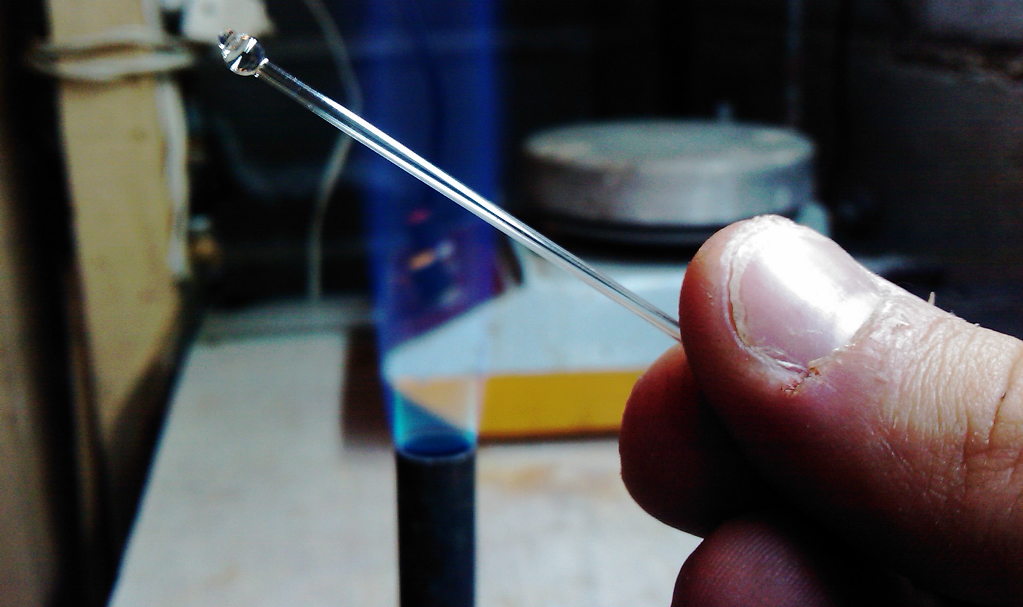

Ok, the most important part is the treatment of the glass electrode, i had tried with a number of techniques,
1) Putting the glass bulb in molten NaOH and then treated with hydrochloric acid to form the hydrate and flame it so the oxide layer was formed. Its tricky because if you put it to long in the molten NaOH you will be left with no glass, ant to short the layer wil not be as thin as to give rapid readings.
2) Same as in 1) both in both inside and outside of the glass bulb, it was very annoying but is the best you can do,
I dont have pictures of these because the ceramic container unfortunately does not exist any more. (-.-) BUT IM PLANNING TO POST A NEW TOPIC IN GLASS ELECTRODES FABRICATION SO ALL THE INFO WILL BE IN THAT OTHER TOPIC.
