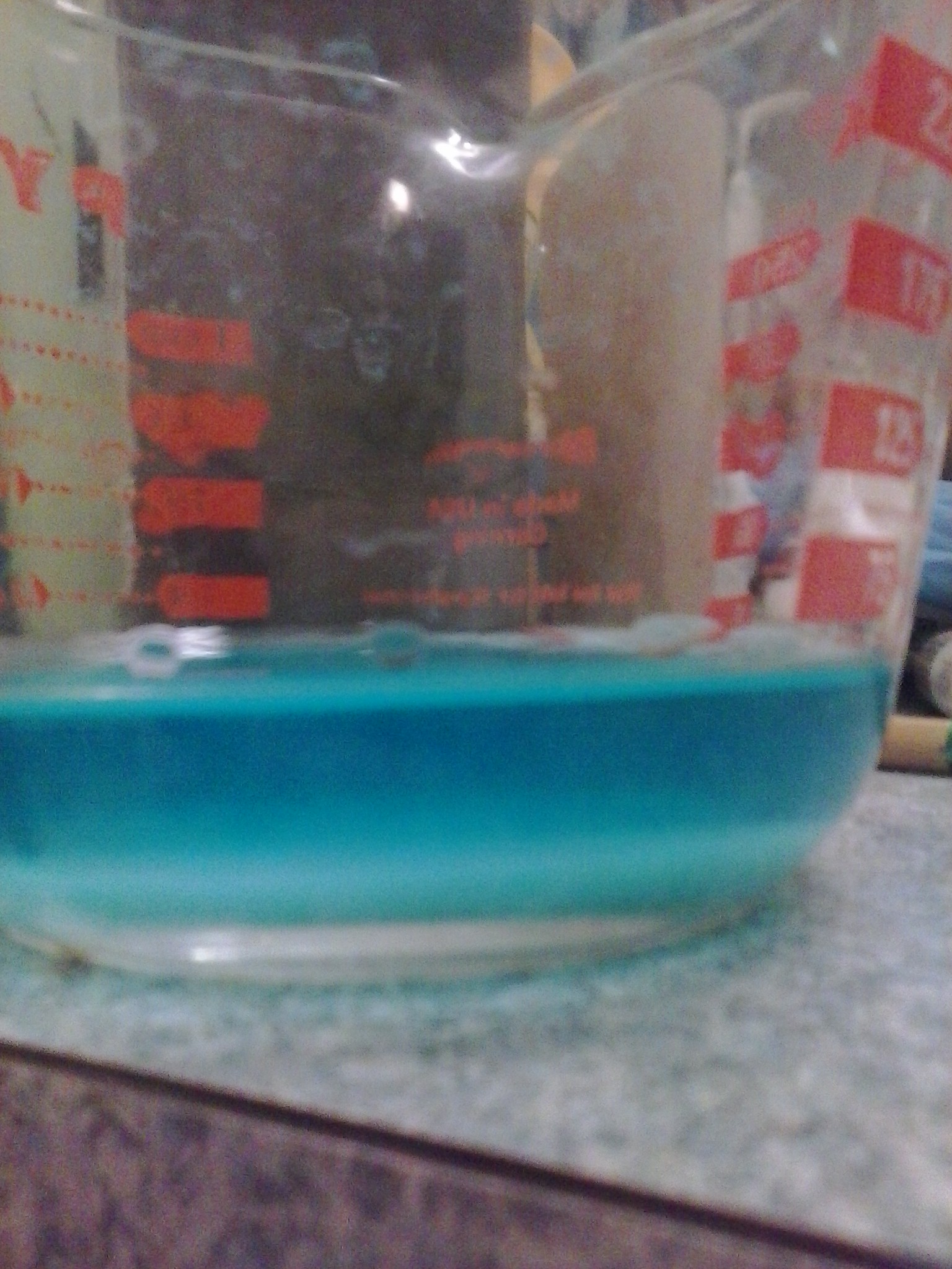

Copper acetate and acetone?
So I have a solution of copper acetate and water. I put 50 mL of acetone and 10 mL of Copper acetate solution into a container. The copper acetate goes from see-through to a dense looking whitish liquid..Also around the top of the clear liquid there seems to be a rapid precipitation of water or something. What happened to the copper acetate?
1430721775843.jpg - 470kB 1430721793210.jpg - 399kB 1430721954473.jpg - 618kB
So I collected some of the precipitating clear liquid on the cup. Its acetone I think. It smells/burns like acetone. But it precipitates a lot quicker than when I first made the solution

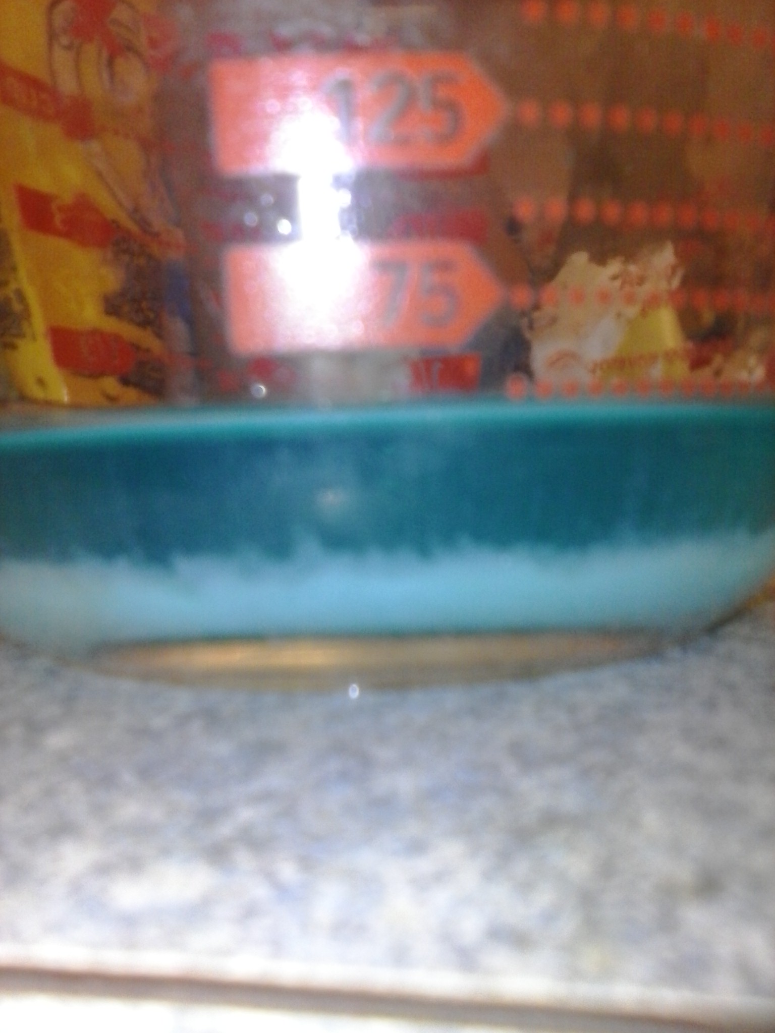

Just a little update. The whitish substance seems to be getting smaller and smaller. And could someone explain the difference and uses between the two? (Copper(ii) acetate and copper(I) acetate)

So where's the reducing agent, violet sin? Oxidising acetone in these conditions is nigh impossible.
Acc. your own source Cu(II) acetate is only poorly soluble in acetone. Most likely then the acetone acted as an anti-solvent, precipitating the Cu(II) acetate.
That some of the Cu(II) acetate seems to have re-dissolved could be due to better mixing of the water and the acetone.

You mixed copper acetate SOLUTION with acetone, so the starting material surely contained water. Copper(2+) ions in water have a nice blue color. When you mixed this blue solution with acetone (which is almost free from water if pure) the acetone acted as an "anti solvent" as blogfast said, because the solubility of copper acetate in aceton is much lower than in water I bet.
Aceton sort of "dehydrated" the previously water solvated copper (and acetate) ions and due to the poor solubility in that solvent solid, whiteish, copper acetate fall out from the solution.
It was white, because the crystals were grown in a low water content environment (fairly concentrated acetone). I think anhydrous copper acetate has a very faint blue color, or straight white, similarly to anhydrous copper sulfate.
Later part of the precipitate redissolved probably because of thorough mixing of acetone and water - as blogfast wrote.

Adding acetone or some similar organic solvent is a popular way to participate some ionic, water solluble salt. Some time ago i used that to participate lead(II) acetate from its water solution by adding isopropyl alcohol. Firstly i thought I had achieved my goal- white, crystalline mass was on the bottom. However after filtering and drying it my yield was maybe about 60% (really not remember). Also after adding KI solution to filtered solution much of yellow lead iodide was formed. As Cu(AcO)2 is quite similar to Pb(AcO)2 the same think was done by You. A participate is copper acetate and due to its not too bad solubility in acetone/ water mixture some of it is still in solution making it blue. In my case solution was colourless as lead acetate water solution is. In my opinion its caused by similarity between acetate ions and simple organic solvants. In your case [CH3CO]O- and [CH3CO]CH3. Of course salts are ionic so the solubility is limited.

While I can see acetone crashing out the copper(II) acetate, I would be very surprised if the product was anhydrous. And acetone will not reduce the copper(II) to copper(I) (soluble copper(I) salts being very water-sensitive). I wonder if it's hydrolyzing, and precipitating a basic copper(II) acetate, or if the precipitate just looks white because the crystal size is very small.
