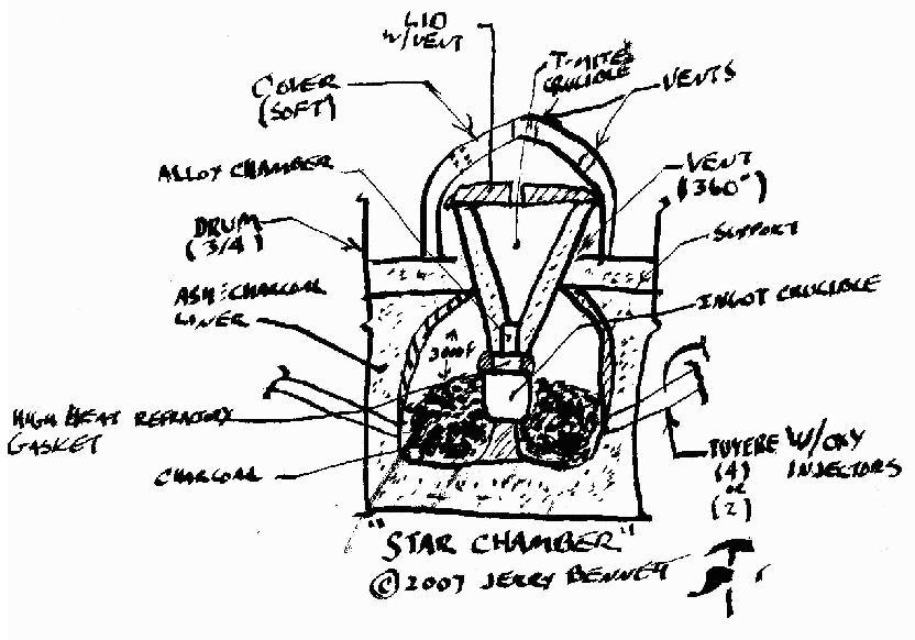

For your entertainment, here are a few vids showing my progression using a thermite furnace.
https://www.youtube.com/watch?v=3_Q_IcBhHTA
https://www.youtube.com/watch?v=aVV5U14ju5A
https://www.youtube.com/watch?v=9JbIeTxaY6s
The second one, got me a patent. Well, a provisional patent. :(
EDIT: Here is a sketch of the final furnace design. I left out one, VERY important item though. You must insulate the thermite reaction crucible from the charcoal fire below. If you heat the reaction crucible too hot, it can react all at once. The least you will get is an awful sunburn. I use a layer of insa wool.

It's actually fairly easy to get proper ratios of desired alloys. If you look at my furnace design, at the bottom above the catch crucible, there is an "alloying chamber". It contains whatever alloys you wish. It also keeps them from reacting to the thermite. It is separated from the thermite mix with a simple melt door. Also a melt door at the bottom of the alloying chamber.
I did get the last few ingots tested, both with spectro and SEM. They came out quite close to what I wanted to make.
