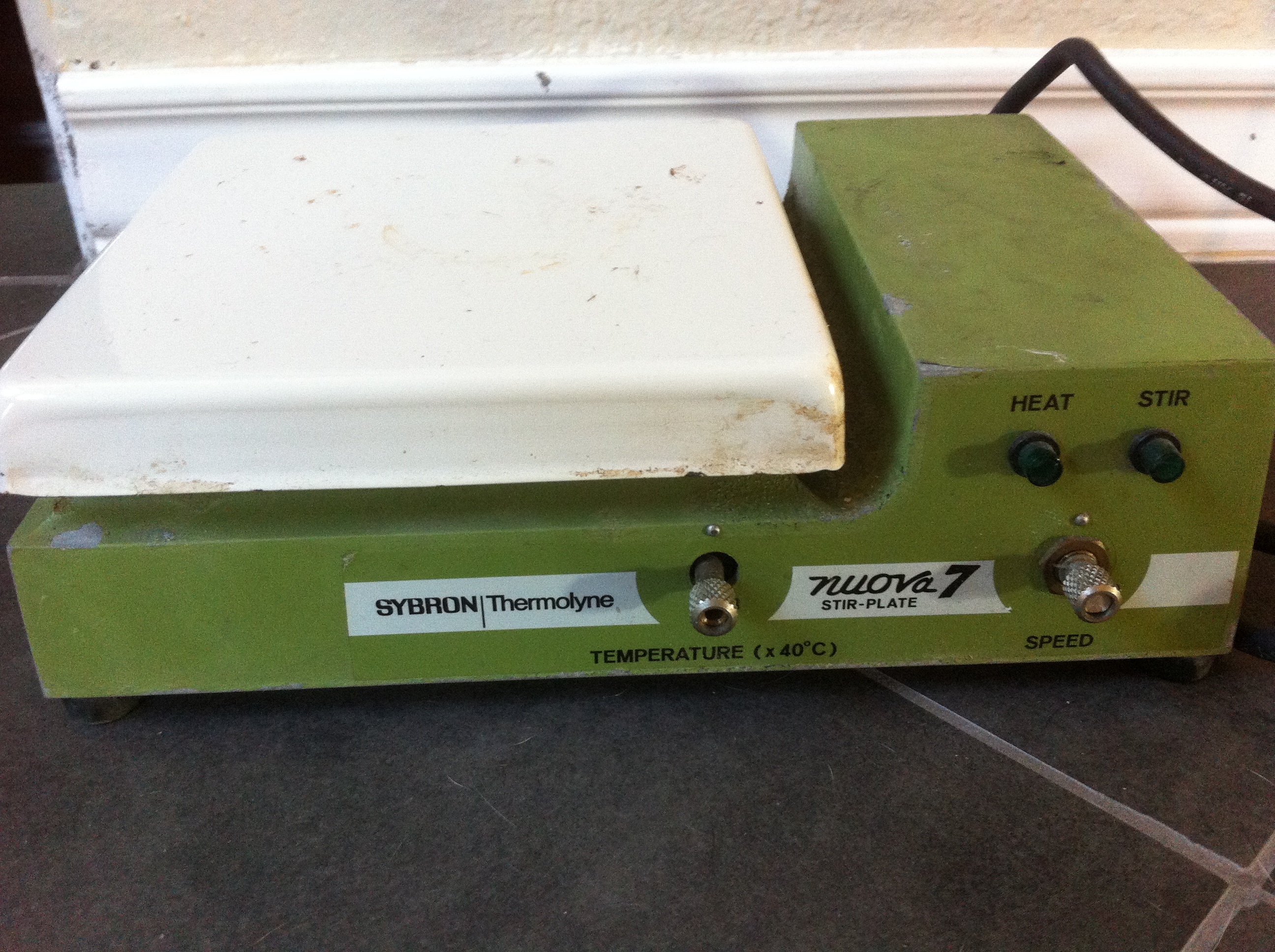

You might want to check out ebay. I found this one there:
![photo.JPG - 2MB](http://www.sciencemadness.org/talk/files.php?pid=358320&aid=34603)
It's old, but it works great. I got it for only $45 including shipping!

My greatest issue with that hotplate is that I have no knowledge of the plate's temperature, and no way to adjust said temperature.
Posts: 4541
Mood: PhD candidate!
Quote: Originally posted by DrMario ![](images/xpblue/lastpost.gif) | Quote: Originally posted by zts16 ![](images/xpblue/lastpost.gif) | You might want to check out ebay. I found this one there:
It's old, but it works great. I got it for only $45 including shipping! |
| Yes, unfortunately the plastic dial that shows what temperature it's at is missing.
| Yes, unfortunately the plastic dial that shows what temperature it's at is missing. |
And even if it were there it would be too imprecise to indicate anything meaningful.
Really, that's my only (but pretty fundamental) gripe with your hotplate. Otherwise, it's quite solid.
