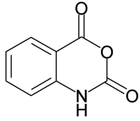

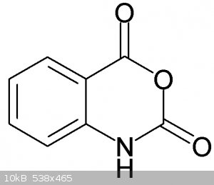

Hey guys,
Got a question here, bit lost for reaction mechanics and what not. I am doing some experimentation with novel quinazoline alkaloids, but solubilities and reactivities of the amide/amine groups have me a bit confused as well.
Isatoic_anhydride.PNG - 10kB
Condensation of isatoic anhydride with o-toluidine would yield 2-Amino-N-(2-methylphenyl)benzamide, not 2,2'-dimethylbenzanilide ?
2 amino n 2 methylphenyl benzamide:
2 amino.png - 5kB
Clearly the isatoic anhydride side ring opens and the carboxylic acid group attached to the benzene ring makes an amine salt with the o-toluidine, which is then dehydrated to the amide through heat.
According to manhas, Then somehow the amide functionality on the right leaves (possibly as methanamide/formamide?) and the nitrogen attached to the 2nd carbon is replaced with a methyl.
benzami.gif - 2kB
It doesnt make sense to me. Neither can acetylacetone condense to form a ring with only one N atom.
Manhas, A Facile Synthesis of Methaqualone and Analogs, Synthesis 5, 309-10 (1977) (if someone has this, posting it would be great. I cannot get at it!)
