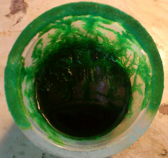

[*] posted on 9-4-2014 at 02:22
A while back I dissolved some copper up in concentrated hydrochloric acid (with a very little sodium chlorate to help oxidise the copper and dissolve it. This may be total rubbish) and evaporated the solution. I obtained a dark green solid. Cupric chloride is blue, the tetrachlorocuprate(II) ion is dark green. So why, if this complex is unstable in solid form, does the solid resemble it? On dilution in water, a white precipitate forms, with a blue solution.
[*] posted on 9-4-2014 at 04:46
For starters, are you sure your product corresponded to the stoichiometry of CuCl<sub>2</sub>? You had excess HCl in there and KClO<sub>3</sub> which yields KCl. Now you boil all that down, but what have you got?
That proper CuCl<sub>2</sub> is blue kind of proves that Cu II tetrachlorocuprate doesn't exist as a solid, or it would be green.

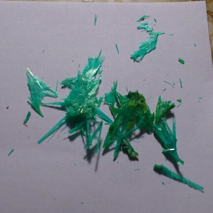

[*] posted on 11-4-2014 at 04:51
No, but I know that cuprous compounds are almost always colourless (excepting cuprus oxide), so it should be a cupric compound. The colour is the same as tetrachlorocuprate(II) but it clearly isn't. What do you think it might be?
DSC_0812-1.jpg - 36kB
The crystals are also somewhat hygroscopic...
[Edited on 11-4-2014 by eidolonicaurum]
[*] posted on 11-4-2014 at 05:32
Odd, that green really is very reminiscent of tetrachlorocuprate. Try drying them: in solution CuCl<sub>2</sub> really is green, because those pesky tetrachlorocuprate anions then form. My guess is that if you dry your product properly it will end up blue.

[*] posted on 11-4-2014 at 05:49
The crusting around the edge is more of the same substance, and there are some crystals in the pot, but I'll separate them out and dry them. The browny colour is just a reflection of something, I don't know what.
Posts: 4355
[*] posted on 11-4-2014 at 07:45
Hydrated copper(II) chloride is green, possibly greenish-blue. Anhydrous copper(II) chloride is a chocolate brown.
[*] posted on 11-4-2014 at 10:38
Hmmm... see for instance the Wiki photo: looks more blue than green to me....

[*] posted on 11-4-2014 at 10:40
It looks like the crystals must have had a little liquid adhering to them, or a similar problem has occured that mrhomescientist encountered here

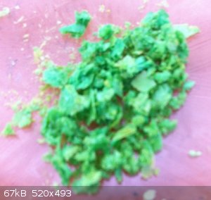

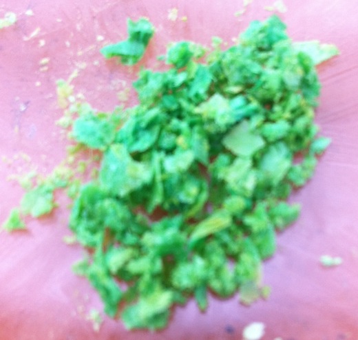

[*] posted on 22-6-2014 at 14:10
I'm having that same issue with the weird green copper(II) chloride, but I take it from this last picture that yours did dry out properly.
Just for clarification, was it necessary to use a desiccator, or were you able to dry them solely by evaporation? I left mine outside for a few days and it was still quite green.

Isn't solid copper(II) chloride a neutral complex with copper(II) ions coordinating to two water molecules and two chloride ions?
I would think anhydrous CuCl2 would be copper(II) tetrachlorocuprate.
Posts: 4618
Mood: PhD candidate!
[*] posted on 22-6-2014 at 14:51
I don't know, I was under the impression that it was a normal ionic compound, usually seen as the blue-green (much more blue than what I have) dihydrate, and that it only forms complexes when there are excess chloride ions in solution.
Posts: 4618
[*] posted on 22-6-2014 at 18:24
I left it in my desiccator for a few hours, and it's all brown now, as is to be expected with anhydrous copper(II) chloride. I think I will add a stoichiometric amount of water to make it into the dihydrate without letting it get overly saturated and see if it assumes the proper color.
