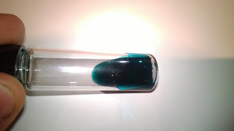

So I finally got around doing this, and I got some interesting results. I went with the copper acetate/oleic acid approach, as suggested by DraconicAcid.
So my first surprise is Copper oleate is an oil? As soon as the oleic acid hit the solution of Copper acetate I noticed a dark blue layer appear between them. I started to stir the mixture, and did so for the next 10 min.
1.jpg - 116kB
After the stirring there was a thick layer of deep teal colored liquid, behaved almost exactly like oil.

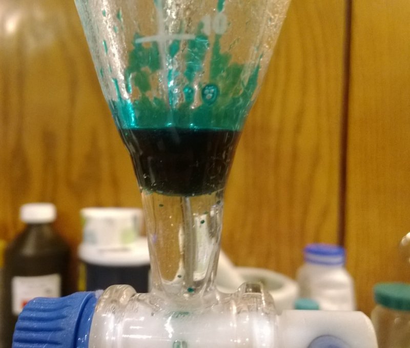

2.jpg - 89kB

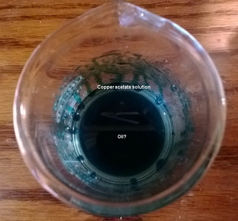

Then through the separatory funnel (guess how much fun that was to clean). Notice how the bottom layer is a very light blue, indicating that the Copper acetate did indeed react away.
3.jpg - 69kB

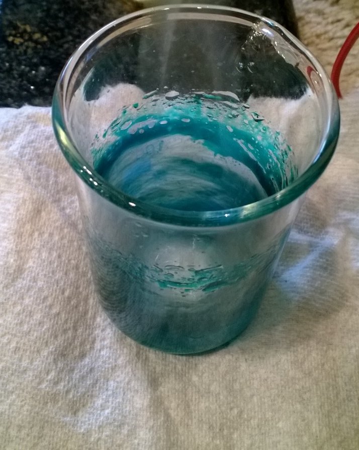

I was left with a liquid that smelled like oleic acid and was a beautiful deep teal.
4.jpg - 28kB
Notes:
Copper acetate solution: 0.4g Cu(CH3COO)2 in 20ml of water
Oleic acid: 1.5ml; Purified at <98%
Yield ~1ml
I know it's not stoichiometric, I just wanted to see if it works...
For all you Copper fans, this is definitely worth trying just to have done it once. Cleanup is hell, although acetone makes short work of it (Physical scrubbing still required)

That is magnificent! I will try to prepare this at home this month... I'm running short of copper lately but I'll buy some sulphate as soon as possible. Are you sure that it isn't just a copper compound in suspension in oleic acid?
I went back to check on the vial, and the mass had solidified. It's kind of a very thick paste, you may be right. Although the color is still incredible.
Eddygp
Posts: 858
Registered: 31-3-2012
Mood: Organometallic
[*] posted on 7-6-2014 at 04:08
Well, it should be a colloid with very small particles anyway. Try to flocculate it with FeSO4 solution to see if it is indeed a suspension.
