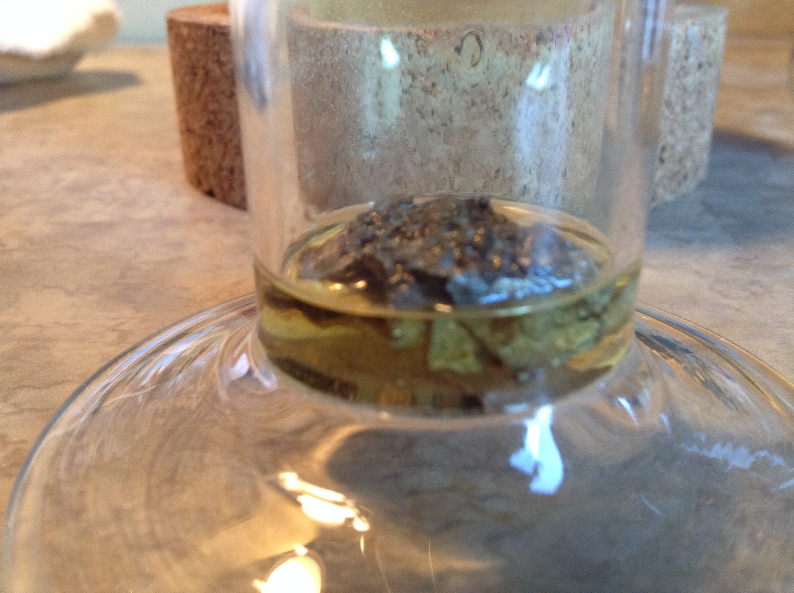

With the reactor cold I took another look at it today and what struck me were some prominent purple patches, here’s one:
![](http://oxfordchemserve.com/wp-content/uploads/products_img/SnCl4_mauve.jpg)
The photo doesn’t really do it justice, in reality it’s more like a lighter shade of chromium alum.
Most of it was recovered by cracking the glass. The material was then subjected to simmering 37 % HCl in which it dissolved quickly (bar a bit of
insoluble residue) to a green solution.
After filtering this was alkalised with strong KOH upon which a non-descript fluffy precipitate appeared. On adding a bit of 35 % H2O2 this turned
brown-red, clearly Fe(OH)3.nH2O.
Figuring there might also be chromium in there (I think the thermocouple’s sheath is SS but I’m not sure) this slurry was filtered. pH of the
filtrate was about 10. Lead (II) nitrate solution was added but no yellow PbCrO4 showed up, only a bit of PbCl2.
So it appears that some of the SnCl4 had reacted with the Fe in the thermocouple’s sheath but that only anhydrous Fe (II) chloride (and not FeCl3)
had formed, presumably acc.
SnCl4 + 2 Fe === > Sn + 2 FeCl2
The Sn could explain the dark colour of most of the post reaction mix. Yesterday I fumed off quite a bit of mixed (K,Rb) hexachlorostannates in a
nickel crucible and almost no discolouration of the mix was observed.
But none of this really explains the unusual purple colour of the material...
[Edited on 9-2-2014 by blogfast25]

I just finished an attempted preparation of tin(IV) chloride by passing dry chlorine gas over some strips of tin metal. It was working fairly well for
a while, and the tin was readily dissolving, forming a clear liquid. After a while though, the liquid began to turn greensish yellow, and little brown
flecks were floating around in it. I have no idea why it would do this. My first thought was that the green color was from chlorine being dissolved in
it, but I don't know what the brown stuff is. I suppose some impurities could have come from the PVC tubing that I used, but that doesn't seem very
likely to me. The first picture shows the setup, minus the suckback trap that I added prior to starting. The second picture shows the suckback trap.
The third picture shows the product after it began to turn yellow. Any ideas about why this happened?
I can only put this down to impurities in the tin.
Most of the tin salts I've prepared came from a single, large old tankard of pewter. Tin (and pewter) dissolves well in aqua regia. The obtained
solutions were always greenish. I later managed to prove w/o reasobable doubt that the green colour was due to chromium (III)! Unexpected but true.
I'm not claiming this is the case in your experiment (I don't know that) but maybe it's food for thought? Do you have any idea about the purity of the
tin you used?
Yellow could point to FeCl3 of course because chlorine will oxidise Fe to Fe(III).
Nice experiment, BTW!

| Thank you! That's interesting about the chromium, but the tin that I used should be pure. I got it from my
school chemistry lab, and I am pretty sure that it is reagent grade. I will try to test it with ferrocyanide to see if there's any iron in it though.
It's just so annoying to work with because of the fuming.
Dissolve a bit in Fe-free 33 % HCl (that's quite slow), then test the SnCl2 solution for Fe?

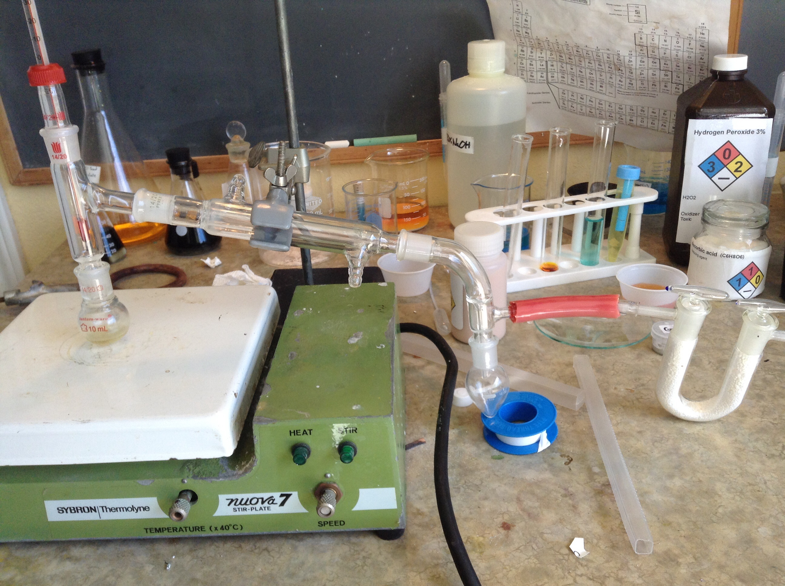

I got around to distilling my cloudy SnCl4 today, with great success. I set up a tiny simple distillation apparatus and sucked the air out
through the drying tube and let it back in slowly to try and keep the inside of the apparatus dry. Then I brought it to a boil and let it distill
until there was only residue left in the boiling flask. The thermometer read a consistent 115°C once it began distilling. It is still slightly
yellowish, and I think this is likely from dissolved chlorine, but it is crystal clear, and I'm satisfied with it.

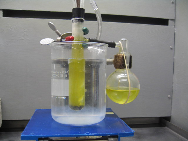

For this preparation I followed Brauer’s method A. With this method elemental tin shot is contacted with a fast stream of dry Cl2.
My reaction vessel was a 20mm x 150mm test tube with tublature as shown in the photo below:
![chlorination of Sn (starting).jpg - 91kB](http://www.sciencemadness.org/talk/files.php?pid=445368&aid=49853)
Cl2 was generated in a 500mL RBF by dripping 20%HCl on TCCA (ref 2) as shown in the photo below:
![Cl2 generator.jpg - 85kB](http://www.sciencemadness.org/talk/files.php?pid=445368&aid=49838)
Cl2 generator
A. Formation of Anhydrous SnCl4
The 20% HCl was fed using a 12vdc peristaltic pump with a 5/32” OD polyethylene hose (ref 3). See photo below. This worked exceedingly well
compared to trying to keep a slow steady rate using a p-e funnel.
Peristaltic pump
The Cl2 was dried using con H2SO4 as shown in the photo below:
Cl2 dryer
The HCl feed rate in this picture was 40d/min, producing a steady, fast stream of Cl2. The Cl2 is fed to the bottom of the reactor. Unreacted Cl2 is
vented to my hood suction.
Per Brauer the reactor was charged with enough tin shot to fill the tube to about 2cm below the overflow into the 100 ml RBF. This amounted to 73g.
Based on this charge, my theoretical yield of SnCl4 was 160.2g, or 71.8ml.
The stoichiometric Cl2 needed was calculated to be 1.23 moles. I was prepared to deliver 2 moles in 2ea 1 mole batches, assuming that the
heterogeneous reaction would not be very efficient.
As the tin is converted to the liquid SnCl4 it fills then overflows the reactor tublature. A 100mL RBF is used as a reservoir to catch the liquid as
it overflows.
Shown below is the status after consumption of the 1st mole of Cl2.
![chlorination after 1 mole of Cl2.jpg - 83kB](http://www.sciencemadness.org/talk/files.php?pid=445368&aid=49844)
Product status after delivery of 1 mole of Cl2
The reaction produces considerable heat and it was necessary to continually add ice to the water bath enclosing the reactor. The bath temperature
held about 16°C.
The system was shut down after running out of 20% HCl after the generation of the 1st mole of Cl2. The generator was then emptied of the waste
product cyanuric acid and refilled with a 2nd charge of 80g of TCCA. The 20%HCl for each batch was made up from 133ml of 31.45% muriatic acid + 93mL
of water. A 2nd mole of Cl2 was then sparged into the reactor as before. After the 2nd mole had been delivered there was very little tin shot left
in the reactor, ie, 1.2g.
![chlorination of Sn near the end of 2nd mole of Cl2.jpg - 76kB](http://www.sciencemadness.org/talk/files.php?pid=445368&aid=49846)
Production after delivery of the 2nd mole of Cl2
Some flakes of Sn were added to the SnCl4 in the RBF to react with dissolved Cl2 and it was left overnight. The yellow color of the crude product was
evidence of significant dissolved Cl2.

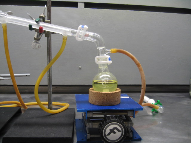

Today I set up for simple distillation of the crude SnCl4 using the 100mL RBF overflow vessel as pot. I left the tin flakes in the pot and added a
couple pottery chards. A CaCl2 guard tube was attached to the vacuum adapter tublature. The system was backflushed with argon before attaching the
pot.
![distilling SnCl4.jpg - 88kB](http://www.sciencemadness.org/talk/files.php?pid=445368&aid=49848)
Distillation of the product
The distillation was rapid (several drops/sec) and without incident. Initially the condensate was a clear yellow but quickly became crystal clear.
The boiling point locked on to 112.5°C and held this temperature throughout the distillation. I have no explanation for why it didn’t rise to the
literature value of 114°C.
Results
The yield was 147.9g, or 66.3mL. The %yield was 92.3%.
