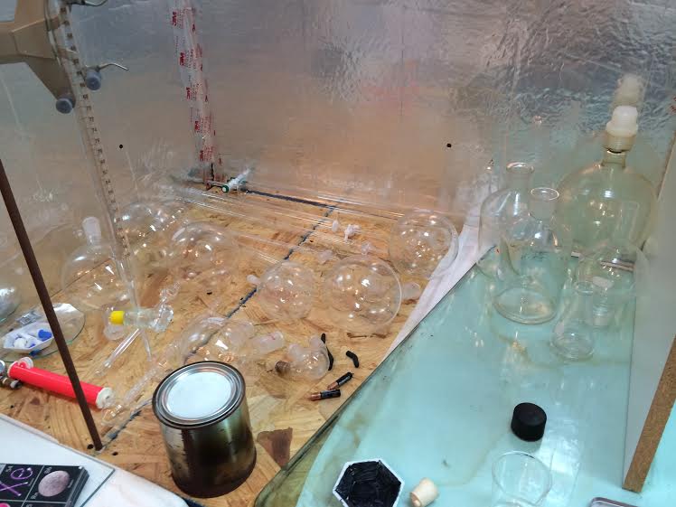

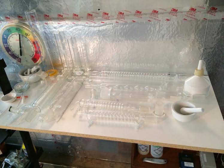

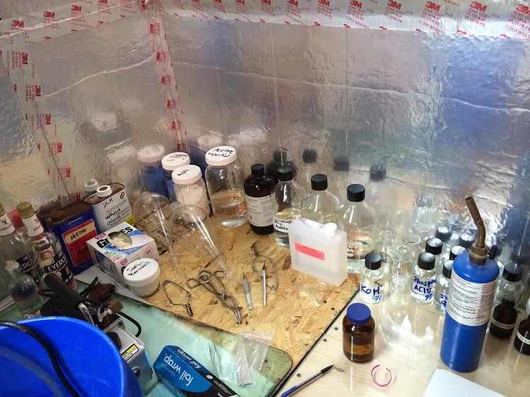

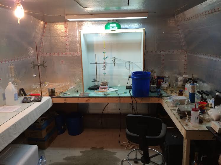

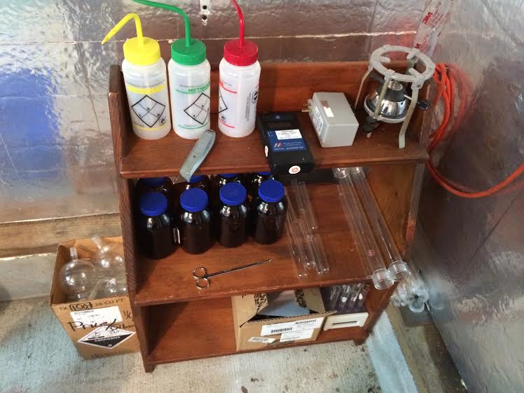

I see this thread is current, so I am hoping someone would help clarify something. I have done searching on here and the web and various organic literature, including Vogel and Zubrick.
Here is my question. And basically a yes or no answer will give me the answer I need to move forward.
When I hook up and prepare for vacuum distillation, do I seal the system completely up(which seems so wrong). or do I have a slight bit of air (or gas if needed) controlled by something like the hoffman clamp on a hose or valve shut off on one of the glass joints of the flask ? I feel it needs to let a tiny bit of either air or gas in, as vacuum is being applied to it.

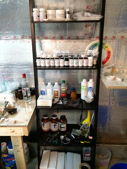

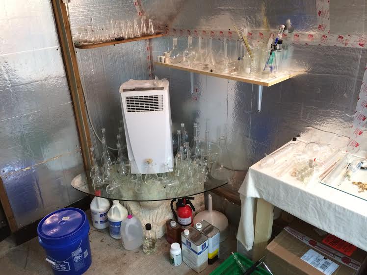

Here is some pics of the lab, since I think this is my first post. I have used this site for a lot of answers I was looking for. I hope to be able to repay by providing relative info to help others out.
I have a corning hot plate and stirrer, I have a single stage pump, as well as an aspirator, high vacuum joint grease and a Meriam Instrument digital manometer. I also have a Hoffman style hose clamp if I need it to regulate the input of outside air or a gas. I have had first semester Organic, but know quite a bit more than that from my own reading and experimenting.
Vacuum distillation is about the only practice I am not knowledgeable in at my current level of experience. I really want to to get comfortable and experienced with it.
We NEVER did a vacuum distillation in my lab. I even asked my prof about vacuum distillation and they really couldnt answer my question.
And any additional info or tips would be greatly appreciated.

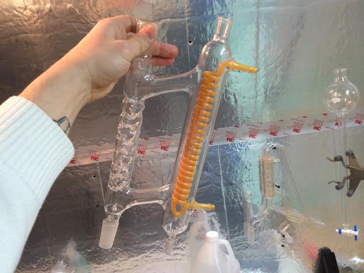

And if someone could identify the glass apparatus I am holding? I have no idea what it is and what it might be used for. I was told it was a custom piece when I bought it.
Thanks.

Wow, what a beautiful home lab! Is that a fume hood? Is this structure built inside a garage? Is that a dehumidifier I see there in the corner?

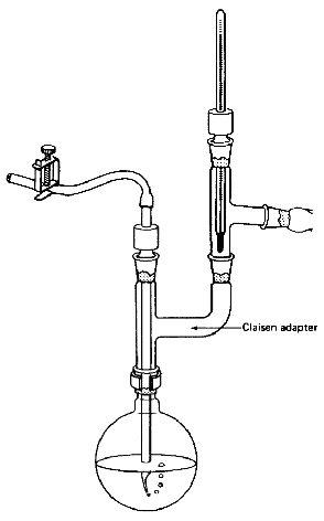

As for vacuum distillation I *believe* that there is not necessarily a need to allow air into the setup, unless you want a slightly higher pressure in the setup than the minimum your vacuum pump will produce. Beware, too, that you need some kind of trap between your distillation apparatus and your vacuum pump - especially if the pump is not a specialized chemical-resistant one. It's typical to have a desiccant tube in line with the pump along with something to catch particulates or large drops of liquid which can be accidentally ingested (this will often be simply a container which draws gas from the setup through a tube which opens at the bottom of a receiving vessel and then connects the vacuum pump near the top so that a few droplets are not likely to get sucked all the way through). For organic vapors, this same kind of setup is often cooled down by an alcohol/dry-ice mixture or even LN2 to form a cold trap to condense the vapor very quickly before it can make it through into the pump. Beware that using LN2 absolutely requires that the entire apparatus be free of air or other oxygen sources as LOX will condense at LN2 temperature and react explosively with anything flammable.
Finally, beware of implosion hazard with vacuum. Vacuum-rated glassware is typically quite a bit thicker-walled. Even with special glassware (and especially if you are doing this with normal glassware - but never with the really thin-walled cheap stuff!), you should have an additional layer of implosion protection such as a polycarbonate shield or mesh around each piece of glassware.

Why is it you feel you require an air bleed, this seems contrary to the entire concept of vacuum distillation. To control the vacuum having a needle valve t-pieced into the line as close to the pump as possible is the simplest solution, variously sophisticated manostats being the least simple.

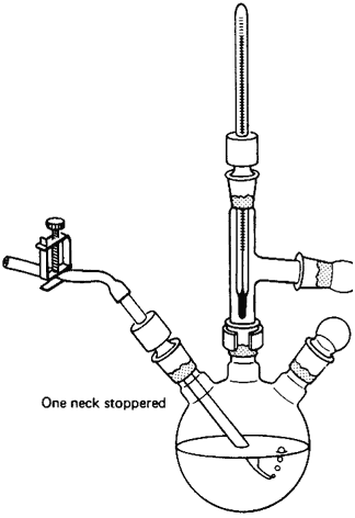

I guess the reason why I was think about letting just a tiny bit of air or gas in is so that is was never a closed system. I have seen pics that had a needle tip submerged with tiny bubbles in the solution. I just figured, obviously the vacuum would be a lot higher than the tiny amount being input onto the system. I will attach a pic or two that I have seen that gave me the assumption at one time about letting air/gas into the system.
I have never been able to find a solid reference as to what I was looking for. Maybe I have been over thinking it. I just definitely what to have a good understanding and what exactly I have to do to do it as safe as possible. I do know not to use thin walled and I definitely know the risk of implosion. That is definitely why I wanted to ask the experienced.
Oh, and can anyone ID that vigreux column and graham condenser combo piece in the last picture I attached? and what it is used for?
