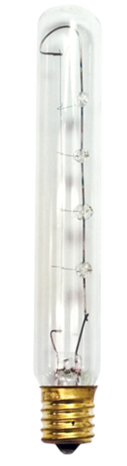

I electrolyzed a gram of sodium metal right into a sealed light bulb.
I picked out an incandescent bulb that was under a vacuum (one where the filament is a long,
straight or single spiral tungsten wire; and not a double-spiral) like this:
40T6_5C_N.jpg - 64kB
The filament when energized became a thermionic emitter, and as such was the cathode. For
best results the end of the filament closest to the tip of the bulb was chosen for the (-) connection.
The higher the wattage of the bulb the better, as the filament is carrying not only heater current,
but cathode current as well. A sacrificial graphite rod was the anode, and the bath was
barely-molten pure NaNO3. Connections were soldered to the base of the light bulb, and it
was suspended upside-down in the molten bath. With 200V DC from cathode to anode, it wasn't
long before a silvery mirror began to form in the top part of the tube. After several hours quite
a bit of sodium had formed around the base of the bulb, and cool air was passed constantly
across its surface in an attempt to keep the metal solidified.
After several hours the vapor pressure of the sodium crept upward, until "BINK!" The
current shot upward, the pure yellow glow of the sodium flare lit up the room.
The sodium began to melt in the tube, and suddenly a blob of it ran down to the tip of the bulb.
When this happened the bulb abruptly cracked, sucking in molten NaNO3. A lot of the
product was thus lost, but not completely since the salt solidified in the bulb quickly,
and its decomposition with sodium filled the tube with nitrogen gas, creating positive pressure
in the bulb.

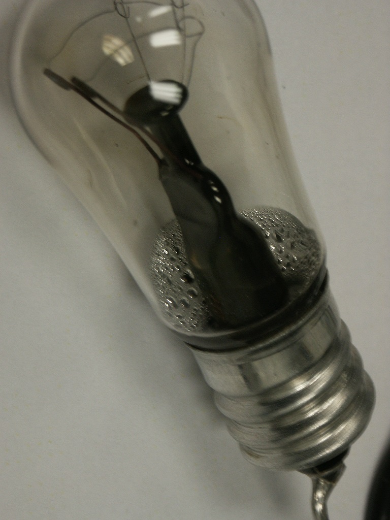

Here is a picture of one that I did on a smaller scale, using a 7W "night light" bulb:
PICT0318.JPG - 194kB
The sodium in there will stay bright and shiny as long as the vacuum in the bulb lasts.
I noticed that the stem inside the bulb turned black. This is probably silicon that was reduced
out of the glass by the sodium vapors. This part of the bulb would be quite hot, due to its thermally
isolated position. The outer envelope of the bulb was faintly darkened after the experiment.
