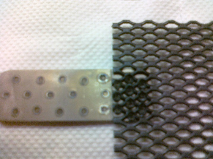

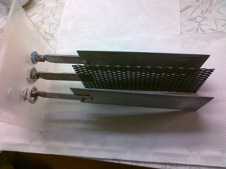

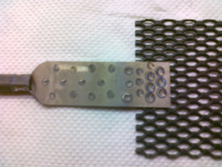

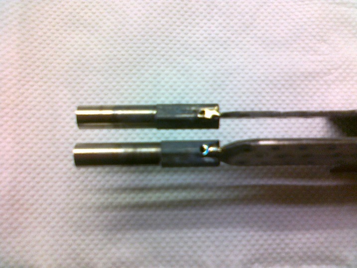

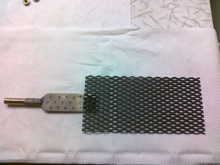

My KClO3 reactor setup:
Ti cathodes
Laserreds MMO anode
5l glass cell
70A power supply (operated at 50A)
Current collectors from VT1-0 Ti alloy, joined with spotwelds and Tig
The electrodes have been operational for over a year now. No apparent signs of wear. All the welds on Ti look as shiny as on the day they were made. The cathodes are detachable from the current collector by stainless bolt....enables the easy use of different cathode materials if needed:
22102013954.jpg - 163kB
22102013955.jpg - 113kB 22102013956.jpg - 171kB 22102013957.jpg - 136kB 22102013958.jpg - 142kB 22102013959.jpg - 115kB 22102013961.jpg - 166kB 22102013962.jpg - 137kB 22102013968.jpg - 194kB 22102013969.jpg - 285kB

that looks very effective, what is the average yield and runtime of this?! also, did the titanium weld straight onto the MMO coating??
also, seemingly you just use a plastic plate put ontop of your cell, you do run this thing outside, right?

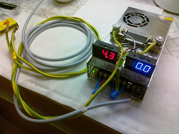

Power supply is customized. The supply is a standard 5V 350W switching unit from ebay. You can get it for 37$ and for the money it really is quite a piece of hardware. Rated at 70A max and adjustable output voltage (I have pushed it to 95A for short periods with no harm done). I also coupled digital volt and ampmeter with it and now it is really perfect for the purpose of electrosynthesis.

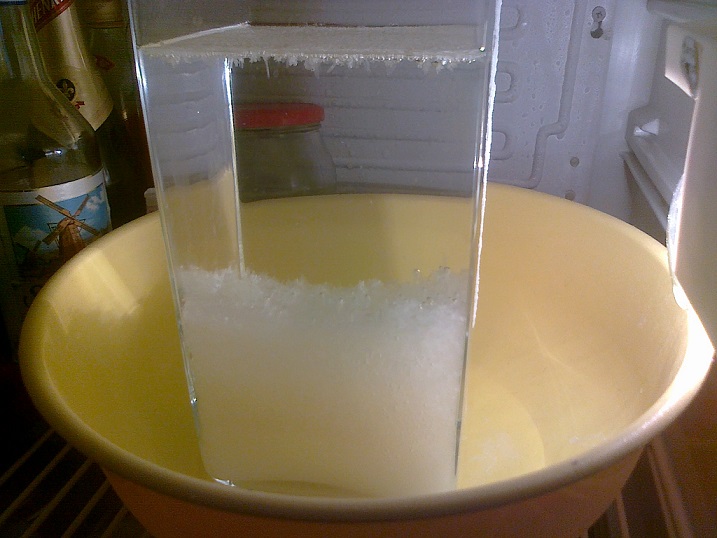

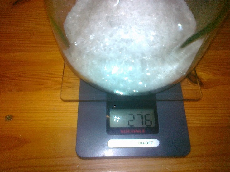

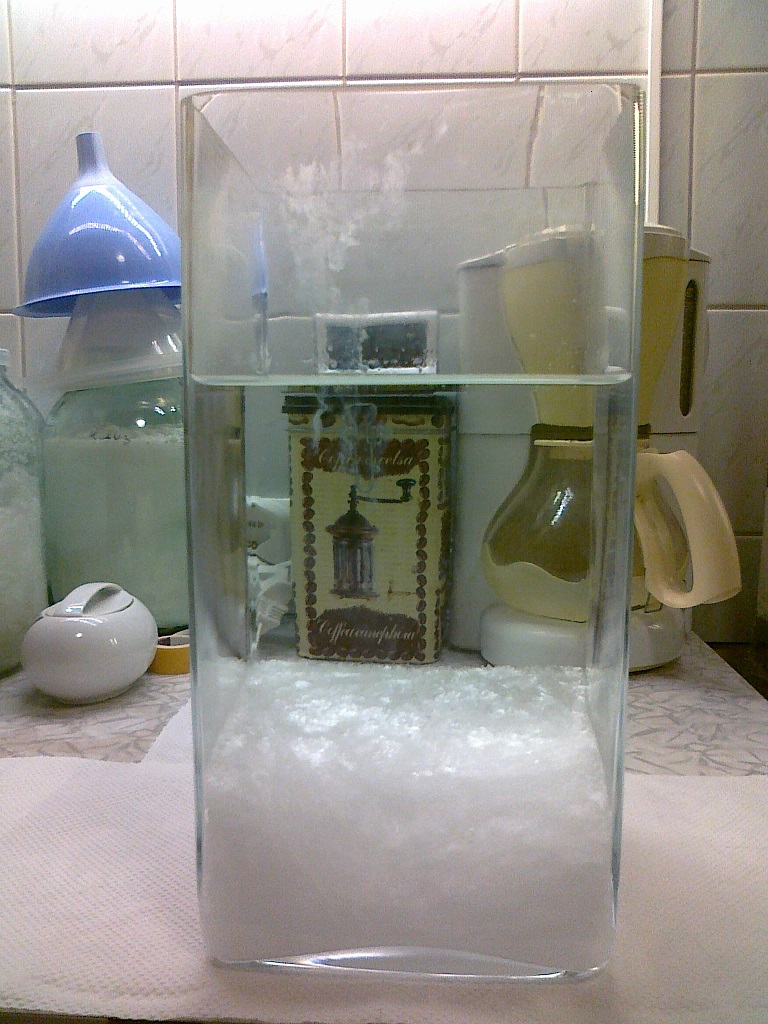

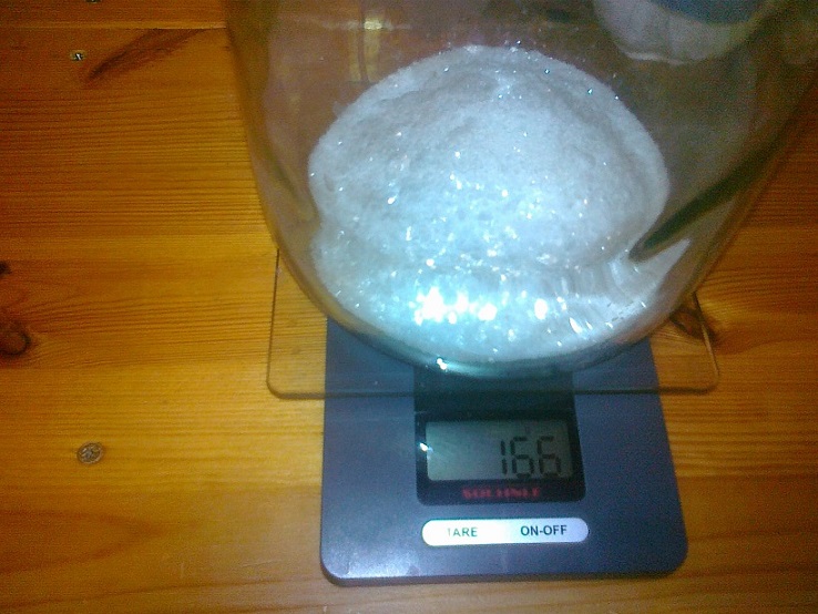

I also found the pics of my first documented yield of KClO3 with this cell from last year (I did dry it in two portions ):
31102012207.jpg - 123kB 30102012205.jpg - 157kB 30102012206.jpg - 140kB

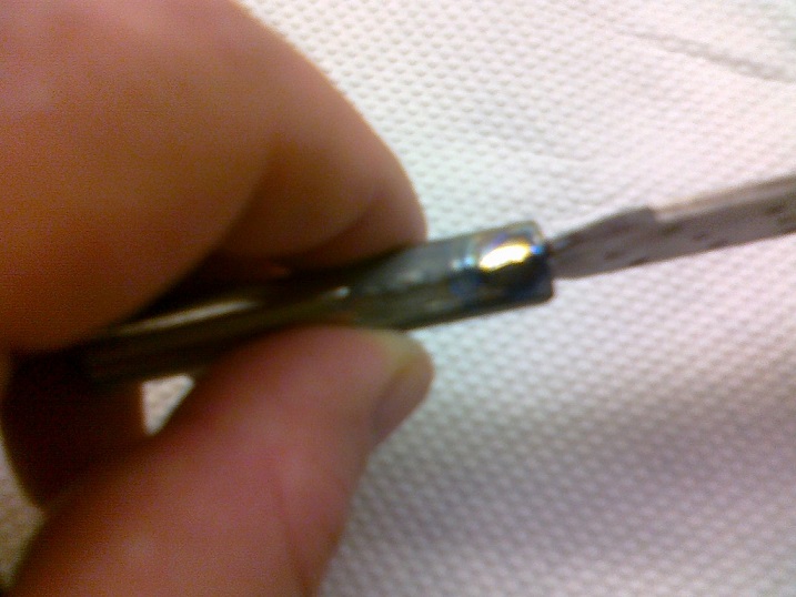

[*] posted on 27-11-2013 at 13:21
i recall having said to up my results with TIG welding Ti-Ti (Ti- MMO(Ti))
it went to luck, although i could have controlled it more if i understood the different settings before starting up
it went alot easier than expected however.. i just pulled the button once and it was attached against all odds
it was just all getting blown together, however it worked, twice in row infact
http://imgur.com/xqDvjIS
http://imgur.com/zf8urXs
http://imgur.com/c4vUOiO
i would prefer to TIG weld it because it seems to last very well, being perfectly molten together, not knowing how well spot welding welds it together

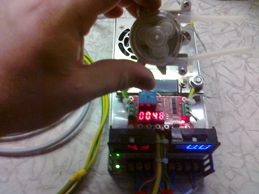

M'key....I rigged up the pH control system:
120120141065.jpg - 98kB 120120141066.jpg - 97kB 120120141067.jpg - 109kB
A small 5V multifunctional timer unit (pretty nifty with a display and all :P ) that runs off the main power supply and drives the little peristaltic according to the programmed cycle, that's it. Just connect to a container with HCl solution and fire on :)
