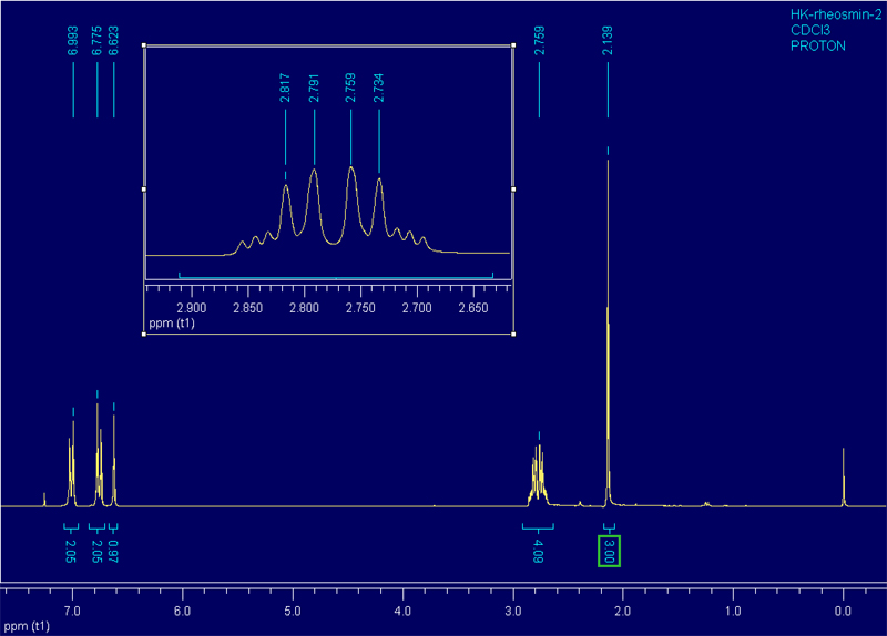

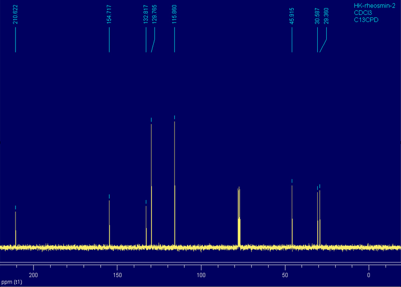

Sorry for the late reply, but I couldn't reach the NMR spectras... Now it's here as jpg, everyone could see it.

I'm befuddled. The carbon spectra looks good. The proton is fairly good too, although not too happy about the splitting pattern for the two aliphatic CH's. It might be that thats how it is, though I was expecting to see two triplets. It could be that we're observing long range coupling. I'm also suprised how sharp and well integrated the phenolic proton is.
Its nice to see theres no water in your spectrum, despite using this as the solvent for your recryst. You must have dried the crystals well!
